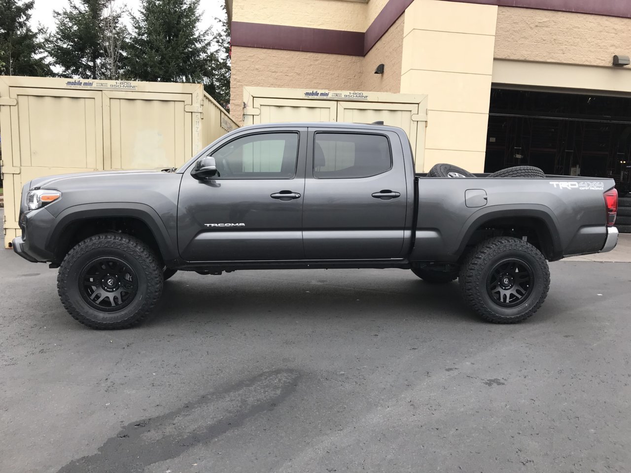

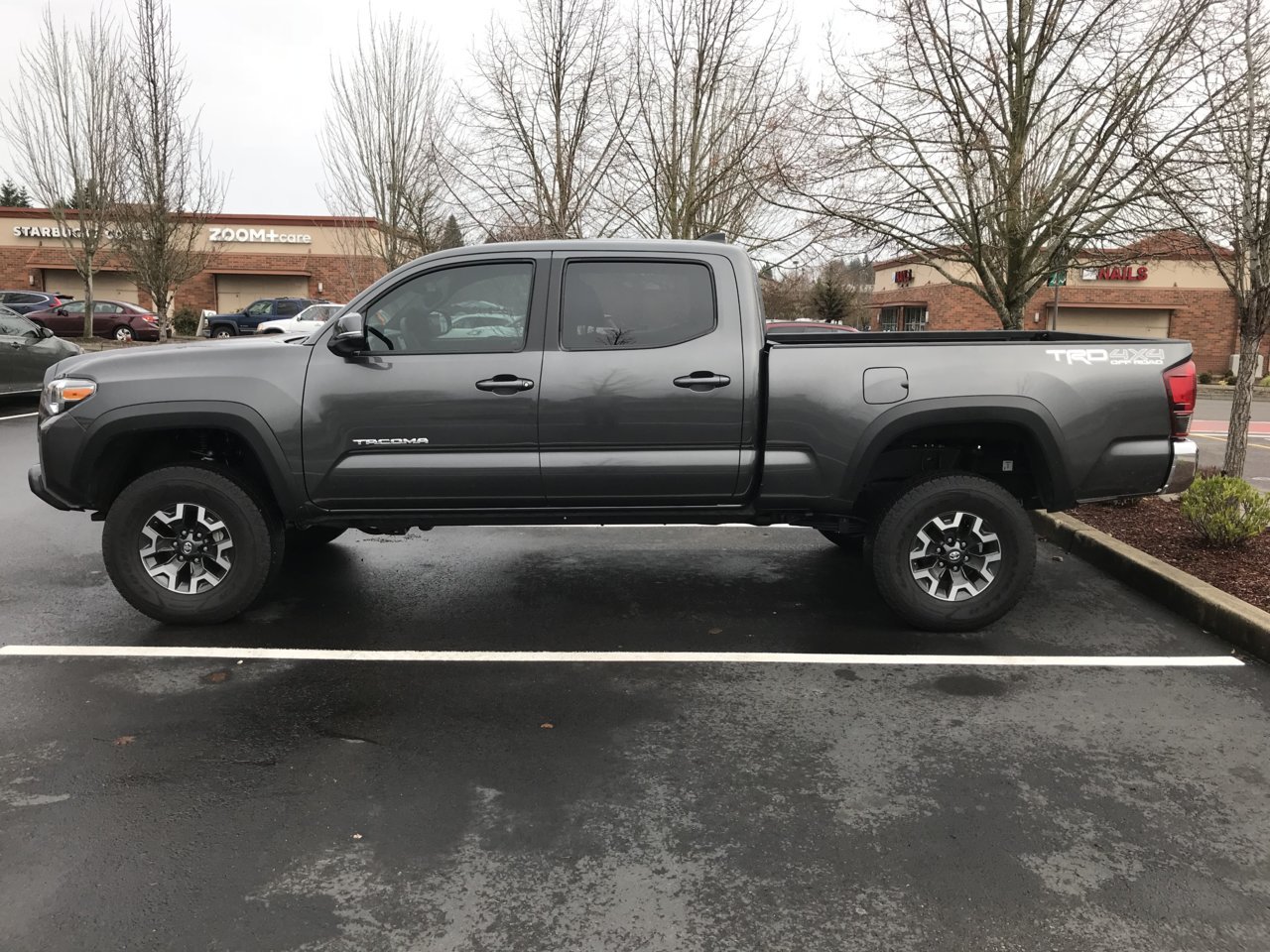

    Hey everyone! I though I would just share my experience with lifting my truck so you all can learn from it. I have done tons of research on this forum piecing together my first lift. I went Bilstein 5100s in the front and rear with OME 888 coils and heavy duty Dakars. I went with spc upper control arms. Also did the differential drop as well as a carrier bearing drop kit. I ended up with exactly 3 inches of lift up front and just over 3 inches in the rear.
    I chose Cooper discoverer st maxx 285/70r/17 on Fuel Recoil wheels with a -6 offset. After I got the tires and wheels mounted I immediately found that there was very bad rubbing on the inner fender well where a mud flap would hang. It rubbed right away not even needing to turn in reverse. Needless to say I have to do a cab mount chop to fit these tires. I was hoping to not have to cut up my truck but with the amount of rubbing that is happening I don't see how I can avoid it. I'll be getting this done tomorrow and let everyone how it goes.
    Here are some before and after pictures so you can all see how it looks.

    Got the cab mount chop today and it went well. No more rubbing in the inner fender well. It wasn't my first choice and it still hurts a little that I cut up my new truck. You can see in the picture where the plate was welded and painted black. I might see what I can do to like maybe add a little Linex over where some of the cutting was. Just have to come up with something to put over it first. Overall I'm happy I did this and would do it again.
    So, it you're planning on running 285's on a 3 inch lift there is a good chance you may have to do a CMC. I honestly have no idea how some people on here say they have no rubbing with 285's.
    Here are some picture of what it looks like. They aren't the best but it's the best I could do with it being dark out. IMG_2526.jpg IMG_2527.jpg
