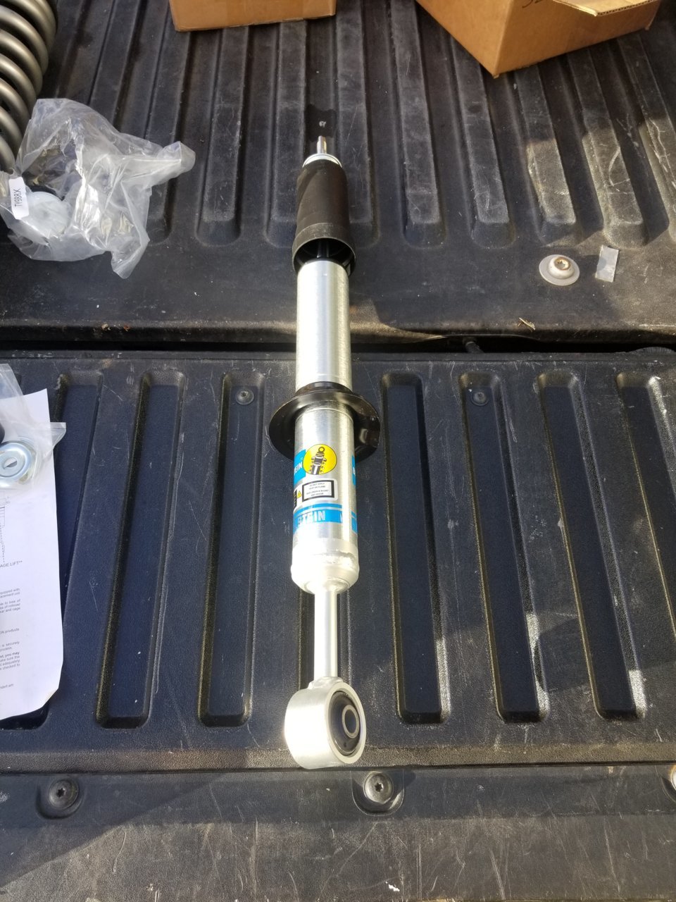

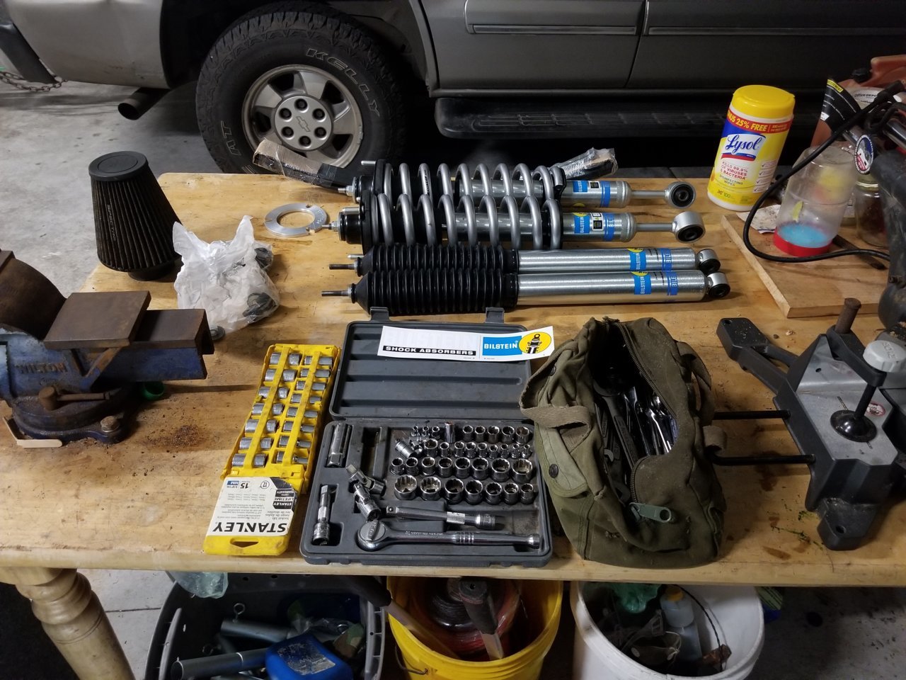

    1. Bilstein 5100 Front Shocks (2)
    2. Bilstein 5100 Rear Shocks (2)*
    3. Toytec 3" 600lb Front Lift Springs (2)
    4. Toytec 2" Rear Add-a-leaf
    5. Bilstein 5100 front shock bushing kit
    6. Longer U-Bolts (Optional)
    7. Strut Mounts (or reuse your old pair)
    8. Toytec Differential Drop Kit (Optional)
    9. Toytec 1/4" Top Plate Spacer (Optional)
    10. 2005 - 2015 Tacoma (Kinda required)
    11. Sway Bar Relocation Kit (Optional)
    Parts Notes: Tweak the parts as you see fit. The optional parts will depend really on you. I recommend new strut mounts because the old ones are too much trouble to remove, it's easier to just grab new ones. You may need longer U-Bolts if the leaf you choose is too thick, but they will fit the Toytec AAL. The top plate spacer is sometimes required to counteract the infamous "taco lean" on the drivers front side, but whether you will need it or not is hard to determine until everything is assembled. As for the differential drop kit, you decide. Personally I declined to install one because the kits I found only really spaced out the front 2 of the 3 mounting points on the front differential. This tells my that the drop kit is actually only really rotating the differential forward instead of relieving the higher angle, a minor and insignificant attempt at a correction. But to each their own, let me know how it goes if you grab one. As for the sway bar relocation kit, I personally didn't need one. You will only need it if your larger diameter coilovers come in contact with the sway bar. In my case I was fine. However, some people have stated that it improves steering post - lift, not sure how true these claims are though. In any case, for $30 bucks you can pick one up so you haven't really lost anything.
    *There is debate on whether the standard 5100 shock is long enough to accommodate rear lift options. Some argue that the extended length of the standard 5100 shock is not sufficient to dampen hard droop, causing the shock to top out with higher rear spring rates or more lift. If this is a cause for concern for you, I recommend looking at less lift for the rear or using a different shock entirely. Some options are the Bilstien 5125, the Bilstein 5100 B110, or the Boss TT-55289. The issue with using these shocks is that while they increase your effective extended dampening range, they limit your up-travel if you do not have enough lift. This will lead to serious problems like your shock bottoming out and blowing up because the piston was too long for the amount of lift provided. You could extend your bumpstops to prevent this, but you would end up limiting your up-travel to your bumpstop anyway. In either case, bottoming out or constantly hitting your bumpstop isn't a great idea. I decided to just stick with the standard Bilstein 5100 and the Toytec AAL. With the AAL giving 1.5" - 2" of lift, and the 5100 rated for 0" - 2" of lift I should be good to go.
    IMPORTANT: Although Toytec rates the Standard 5100 shock for 0" - 2" of lift, Bilstein only recommends a lift between 0" - 1" of lift.

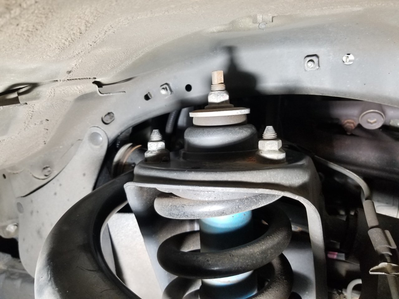

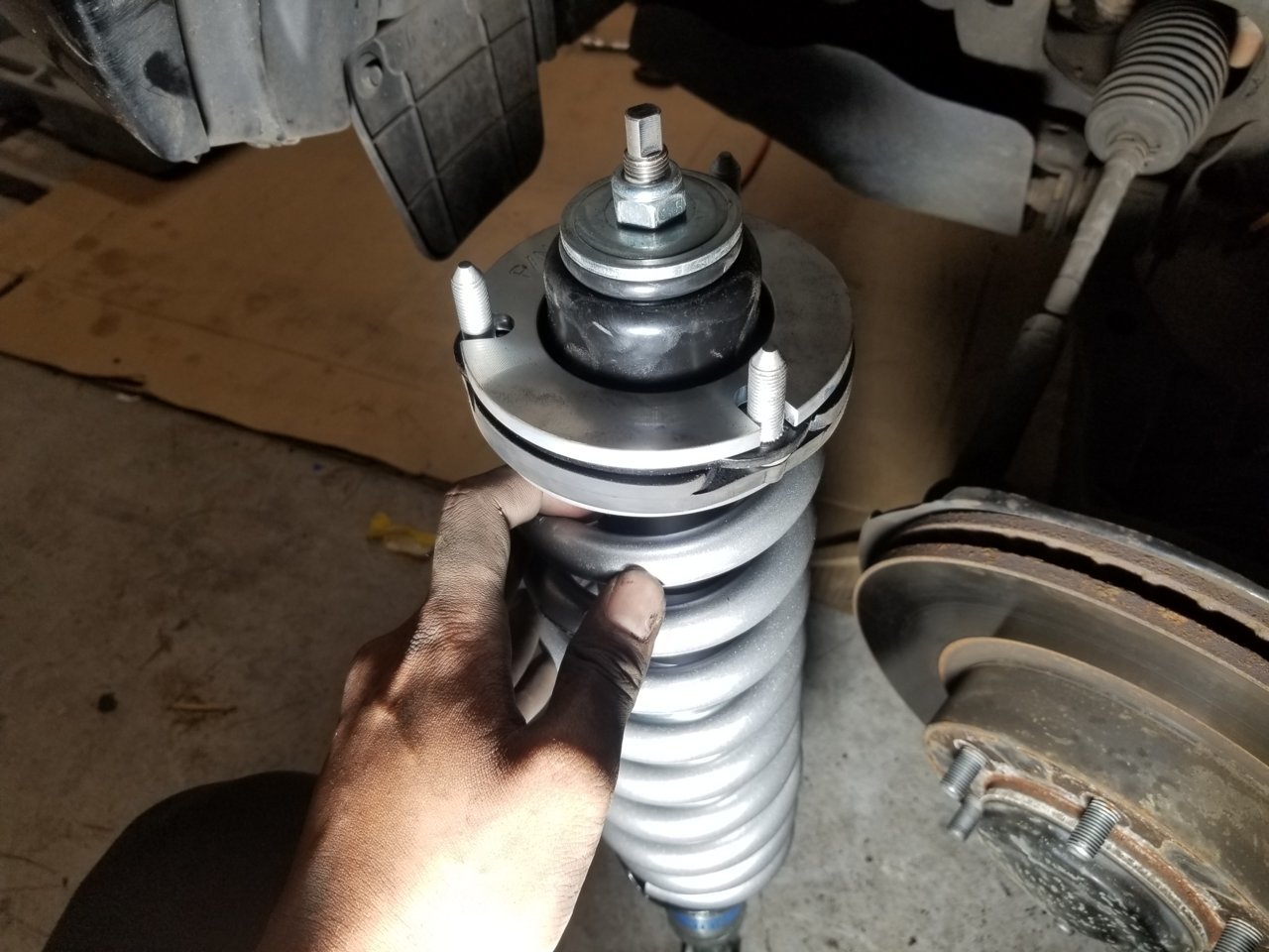

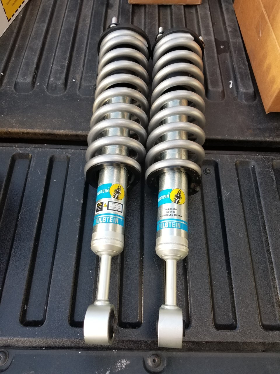

    STEP 1: Coilover Assembly
    If you don't have access to a real spring compressor, skip this step. Take it to a shop and have them do it for $50 or so.

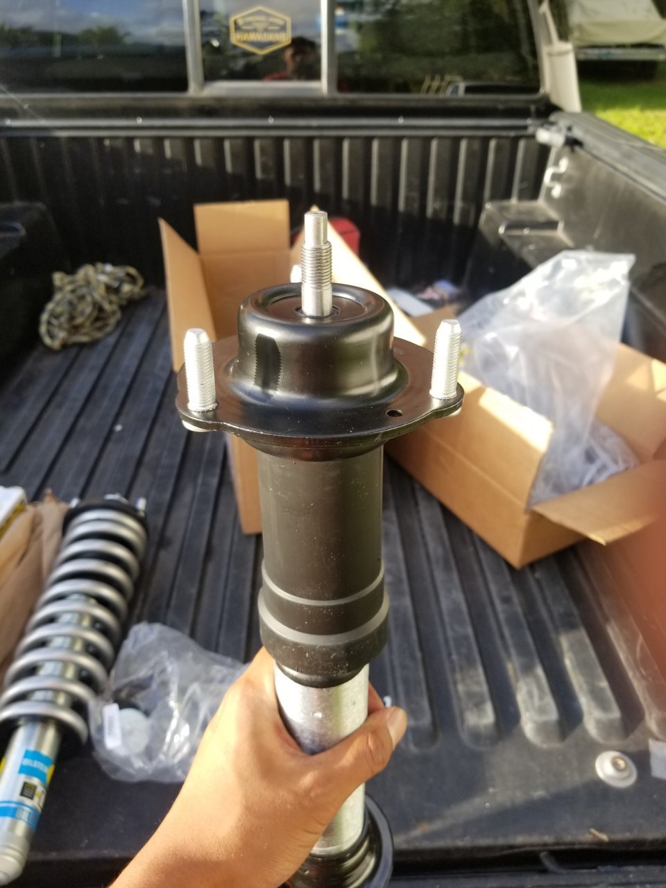

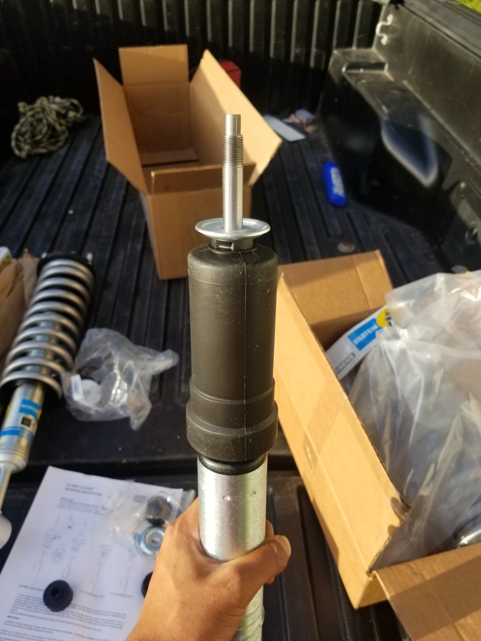

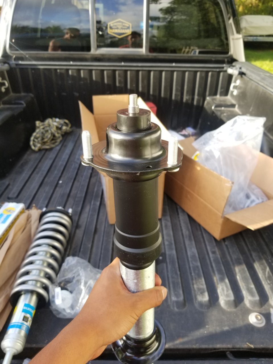

    Start by taking your front shock and sliding the C-clip to the second setting from the bottom. DO NOT EXCEED THIS SETTING, DAMAGE WILL OCCUR AND NO ADDITIONAL LIFT WILL BE ACHIEVED. Be careful not to damage the C-clip, it's fragile when flexed in the wrong directions. Next, slide your bottom coil perch onto the shock until it rests on the C-clip. If you are unsure about which position to mount the coil perch in, it's the position that will give the coil the LEAST amount of compression. Your coil will sit on this perch, but not before an assortment of bushings which I'll demonstrate. Keep in mind that the coil itself must sit between these parts (duh).
    Check it

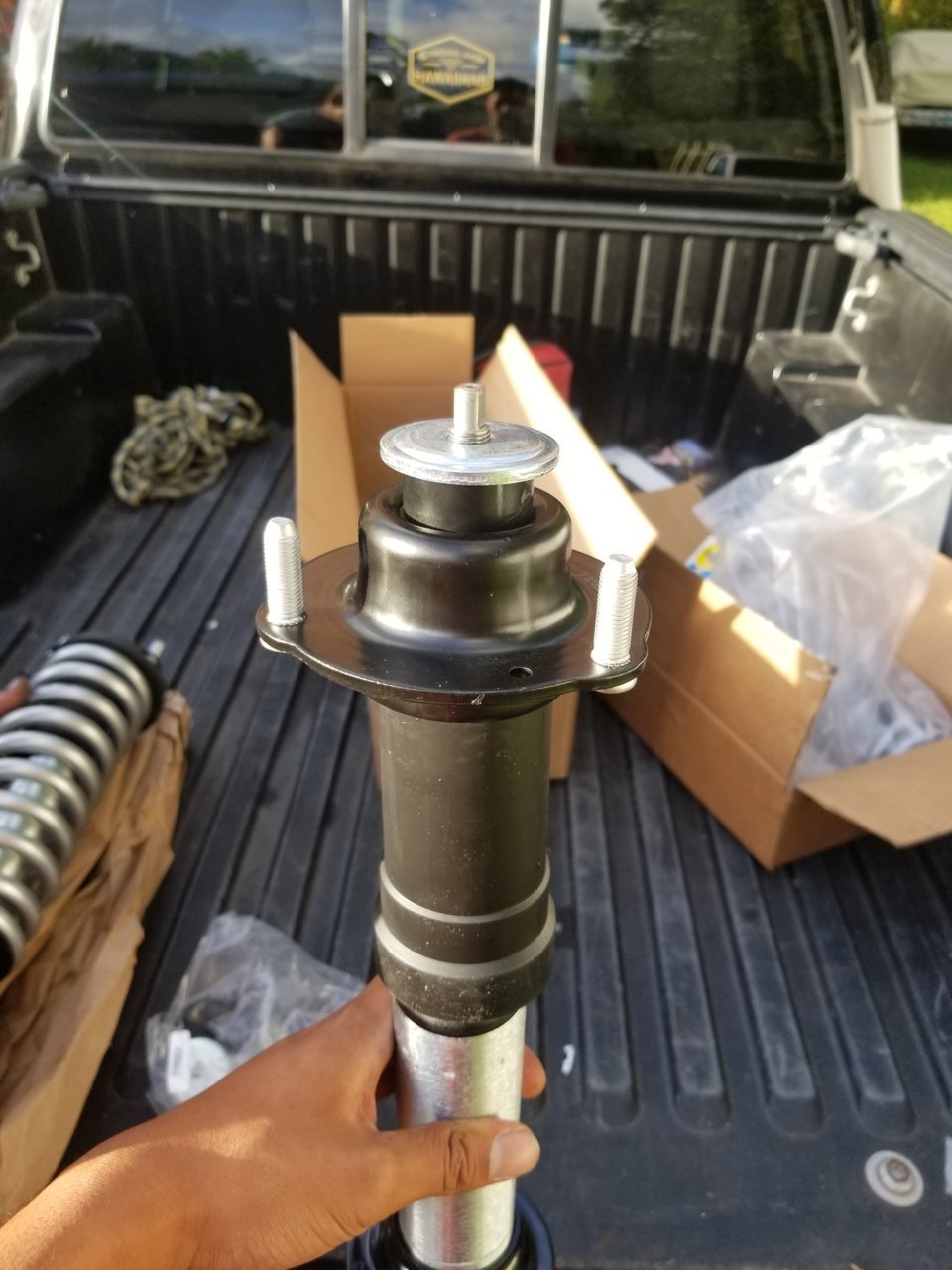

    Throw a washer on the top
    Then throw your strut mount in. Keep in mind that your strut mount must have a rubber bushing in it. If you are reusing your old mounts, grab new bushings.
    Next, throw another bushing and washer, then secure all of that with the retaining nut.
    Again, the coil must go into this contraption under the strut mount with a rubber coil bushing between the coil and the mount. Finished Product:

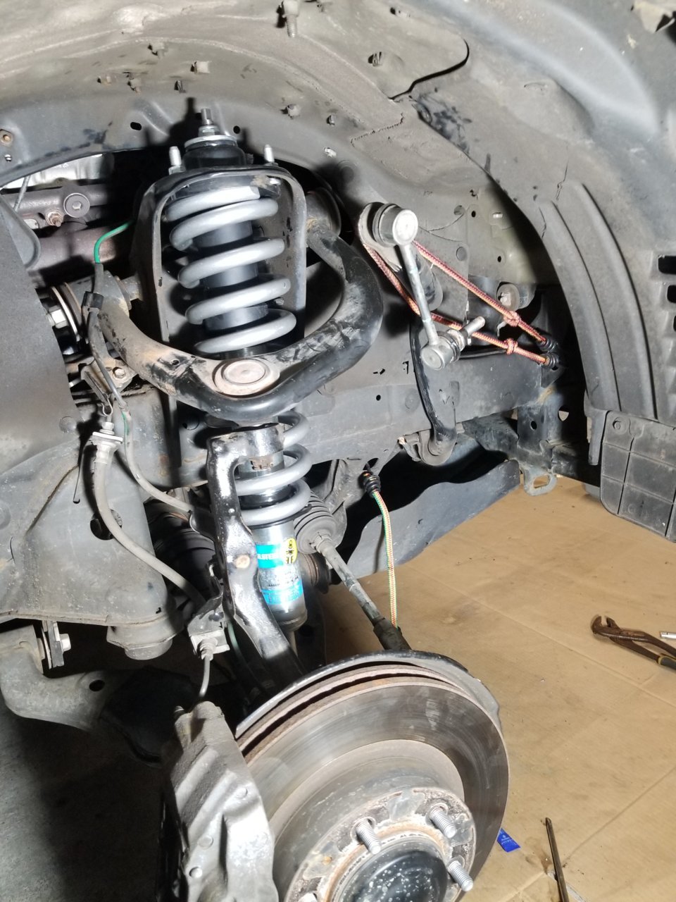

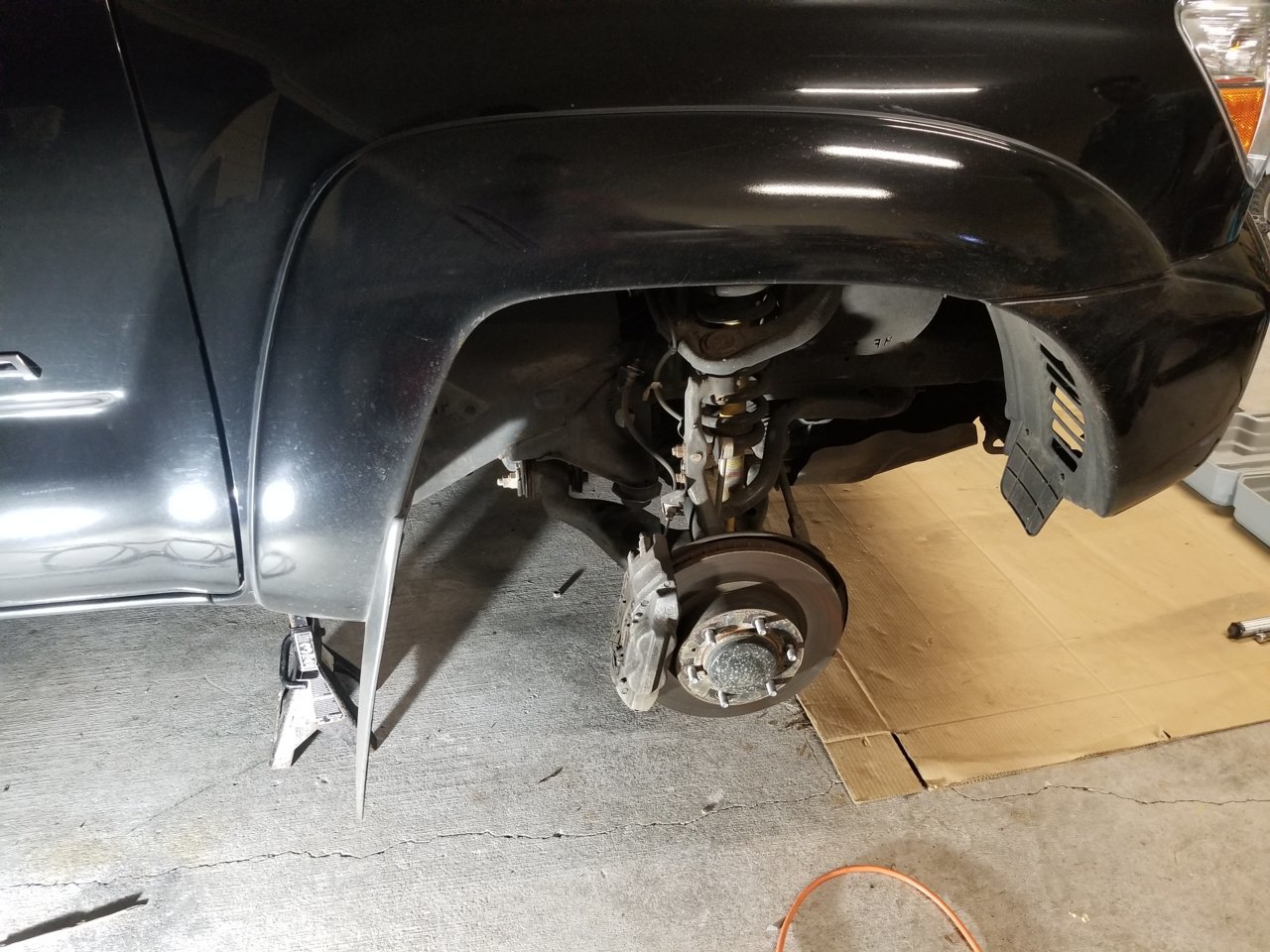

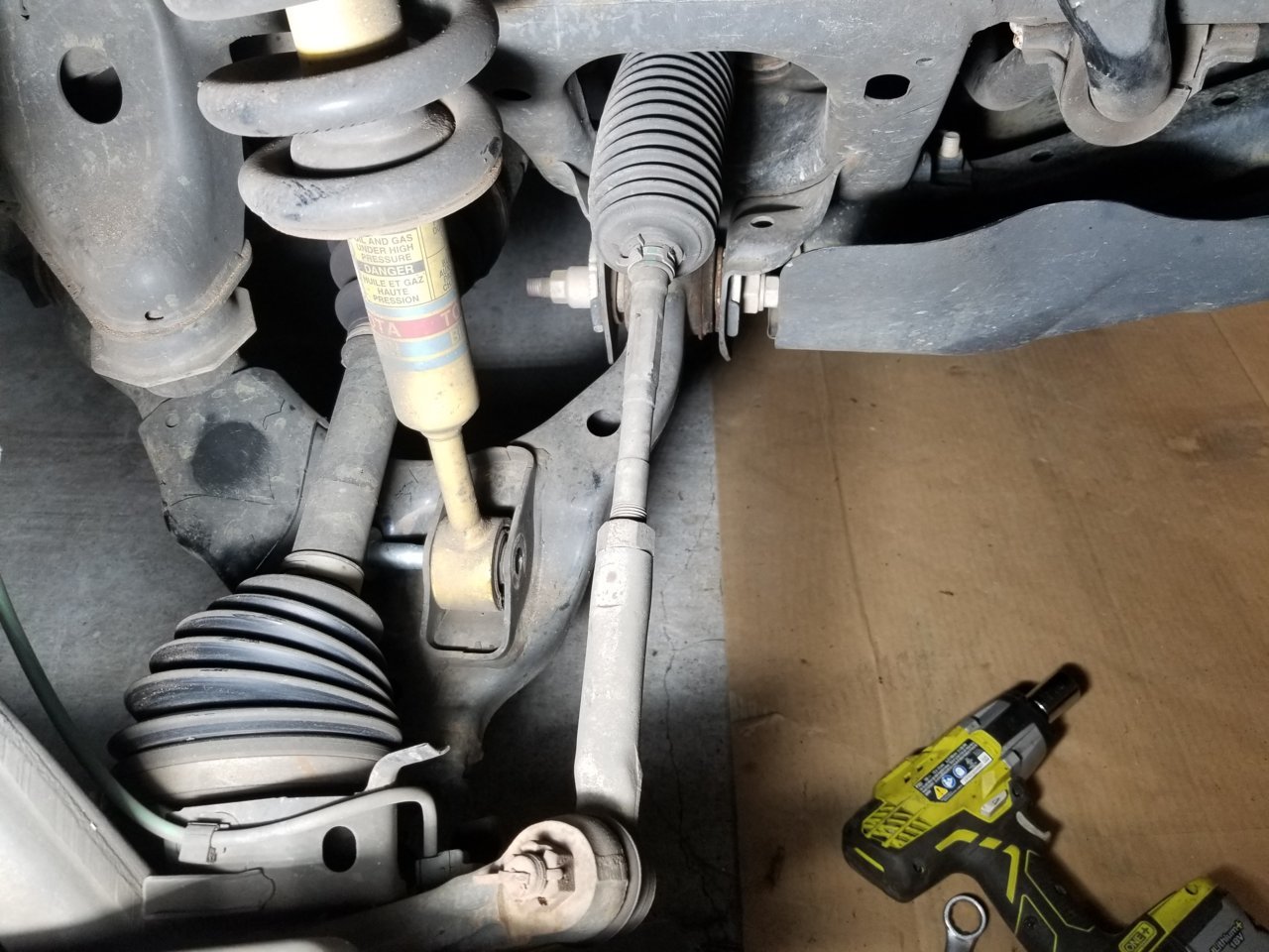

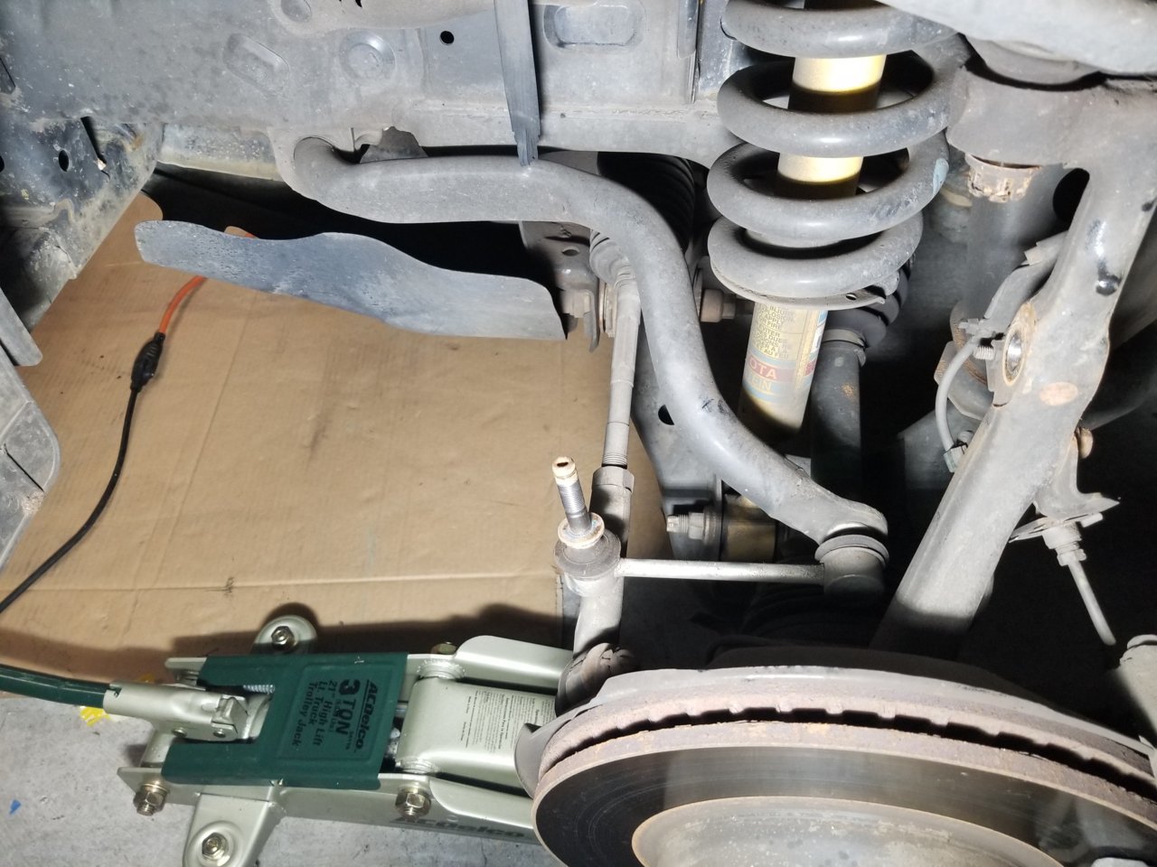

    STEP 2: Coilover Installation
    Bust your nuts (lug nuts that is), and raise and stand the vehicle by the frame. Have at least 2 jack stands and fail safes in case something goes wrong while you are under the vehicle. Make sure the car in in park and the rear wheels are blocked
    Remove the tires and let the hub hang without touching the ground

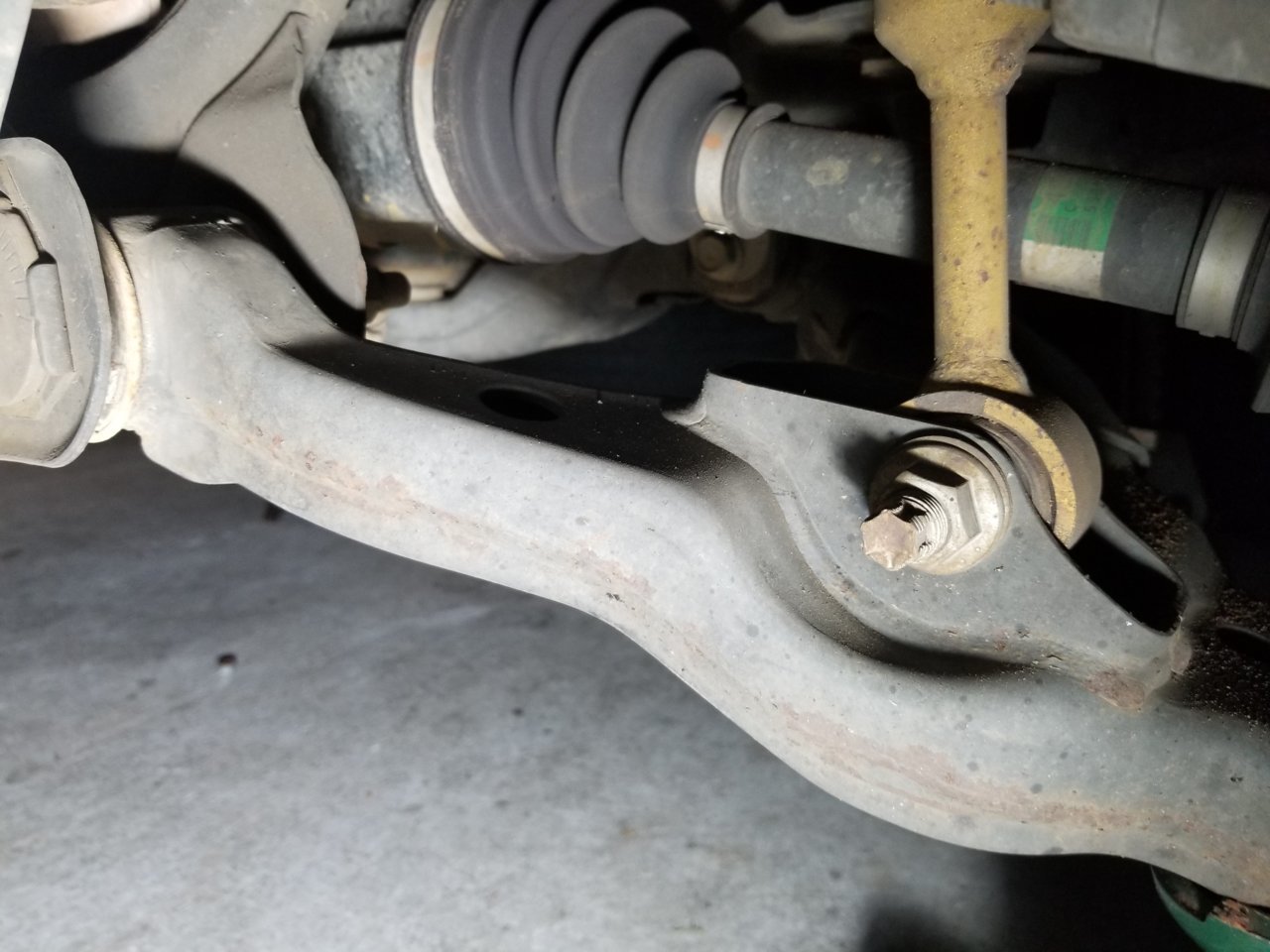

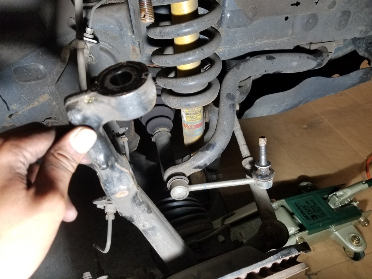

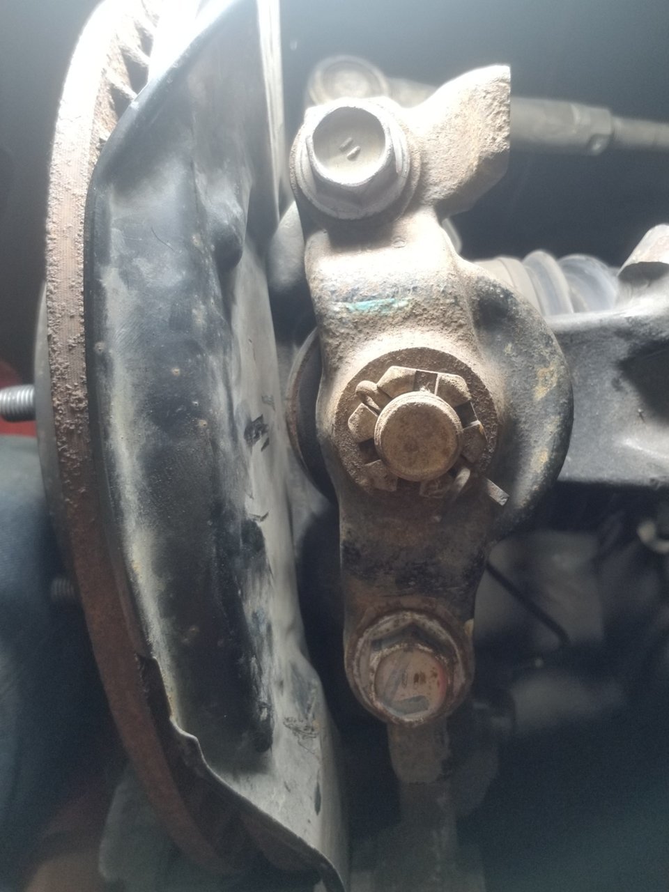

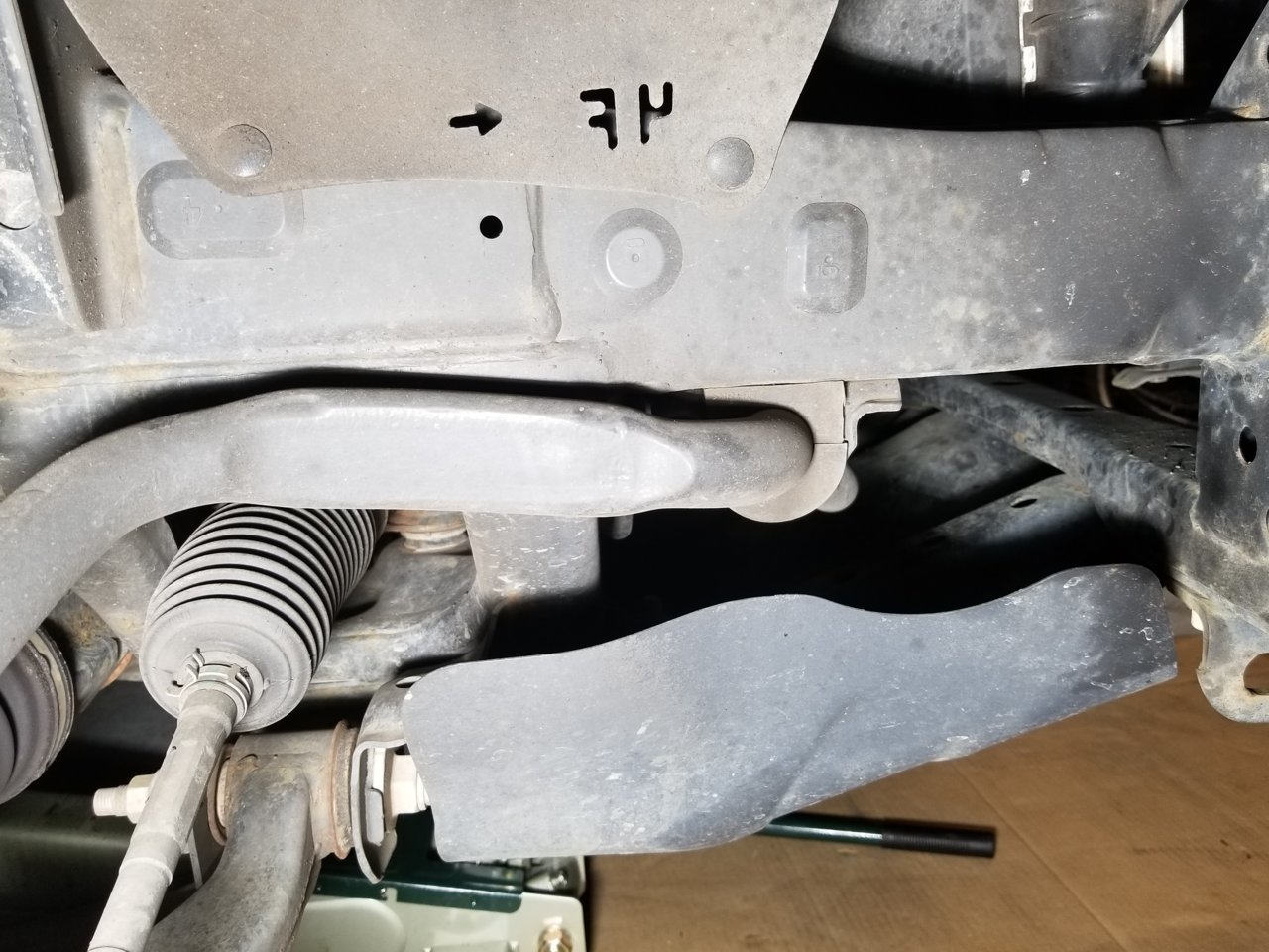

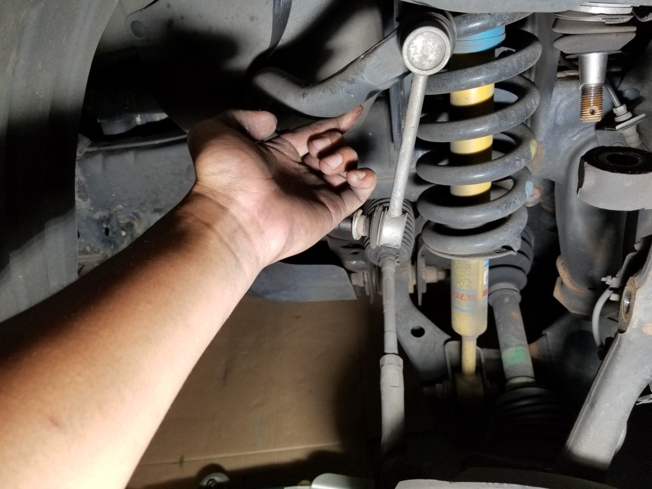

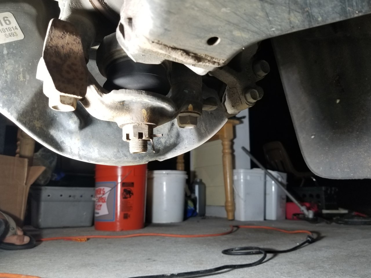

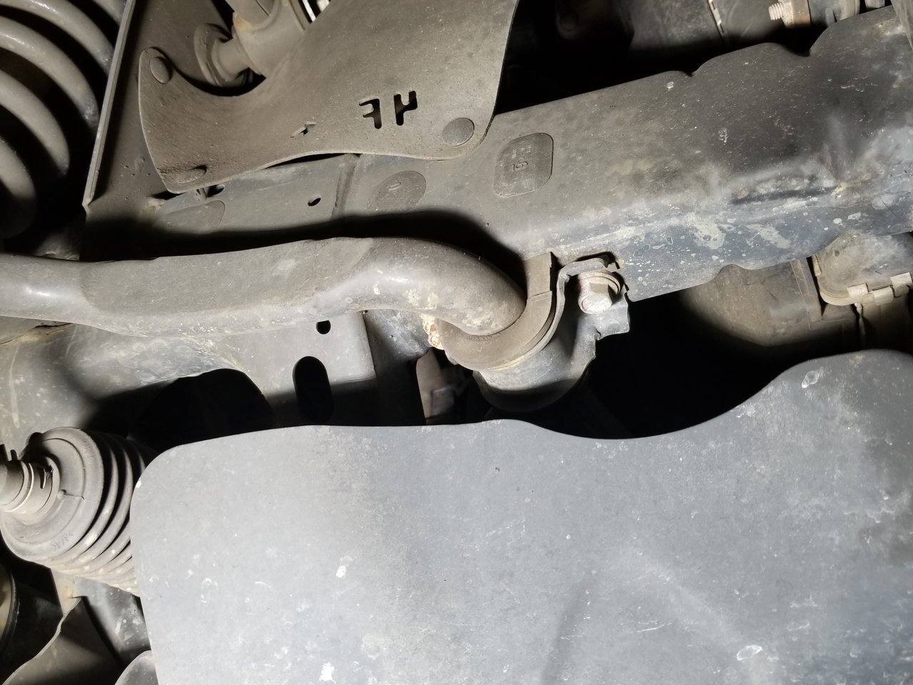

    Next, loosen the sway bar from the spindle and remove it. There is also a mount on the frame, loosen that a bit in order to rock the sway bar back and out of the way
    You may need to split the upper ball joint in order to shift the sway bar all the way back. Keep in mind that it's a castle nut so don't lose or snap the retaining pin. Also, brake lines connected to the spindle assembly will also have top be removed so they don't break. Take care to make sure they do not shift and stretch unnecessarily.
    Once they sway bar is out of the way, reattach the spindle to the UCA, but do not tighten the bolt

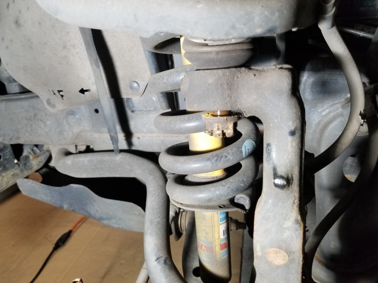

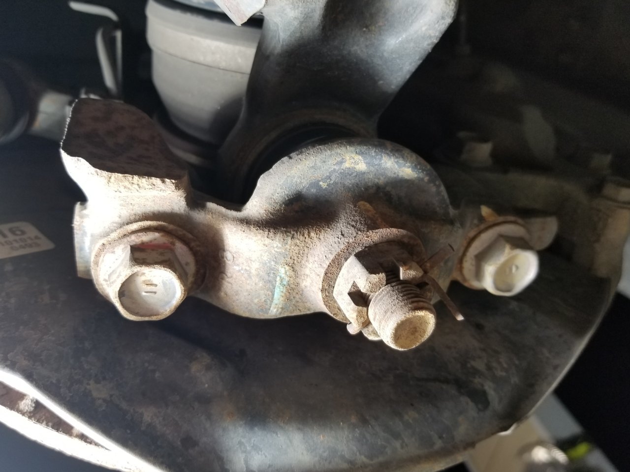

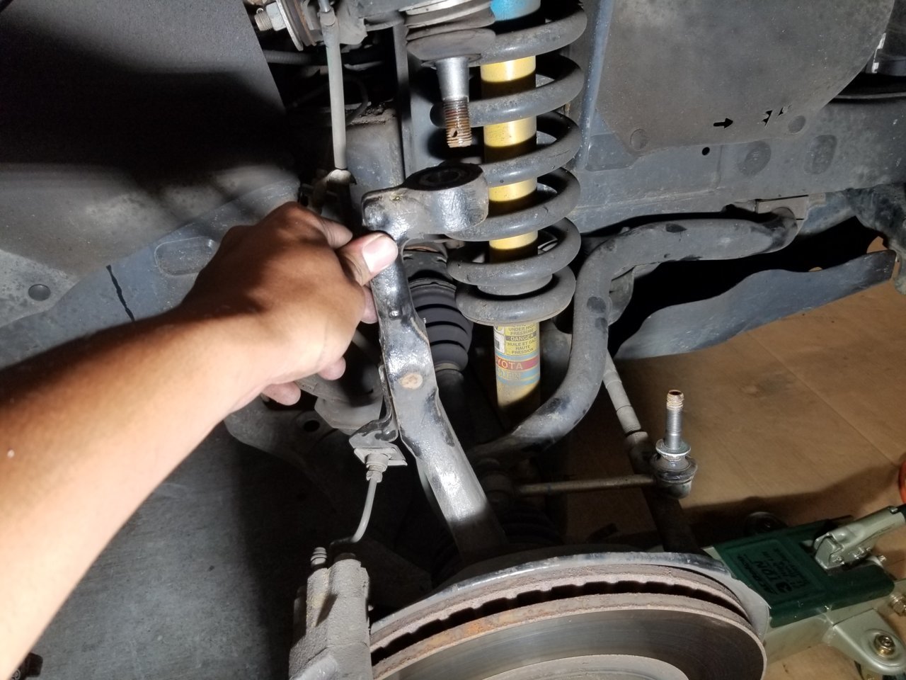

    Next, loosen the two bolts connecting the LCA to the hub assembly. There are 3 bolts. The center bolt with the castle nut is the lower ball joint - do no remove this. Only remove the two bolts on the side. With those bolts loose, the shock should come out with a bit of elbow grease.

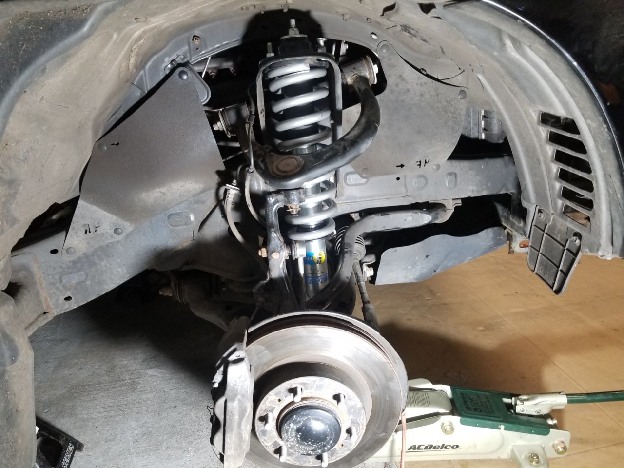

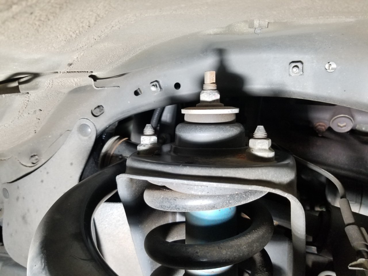

    Next, go ahead and loosen the three nuts at the top of the shock mount. Do not remove the center nut! Only the three nuts securing the coilover assembly to the frame mount.
    Next, loosen the nut at the bottom of the coilover. It will be bolted in to the LCA. An impact gun on the nut takes care of it in a second. Don't bother trying to break the bolt, it won't budge that way. Remember, bust the NUT instead.
    Remove the bolt and slide the old coilover out.
    Snap your new coilover assembly in. Get the top three nuts in the upper frame mount started to it doesn't fall, and muscle the bottom mount in. You can loosen the LCA bolts to make it easier to get the new coilover in, but you'd have to mark your cams out so that you could get you alignment pretty close to what is was. I declined to remove them and just forced the coilevers in because I didn't want to mess with my alignment that night. If the bottom mount doesn't line up one your top three bolts are in, take a thick screwdriver and insert it into the bottom of your coilover mount. Simply turn until it's in the right position and drop it in.
    Same process on both sides. If you are opting for the 1/4" spacer on the drivers side to counteract lean, you just have to drop in on before you put the coilover into the frame mount.
    All set! Make sure everything is reattached, assembled, and tightened down. Don't forget brake lines, LCA mount bolts, sway bar/sway bar mounts, and upper ball joints with the castle nuts and pins. Throw your tires on and call it a day! Congrats

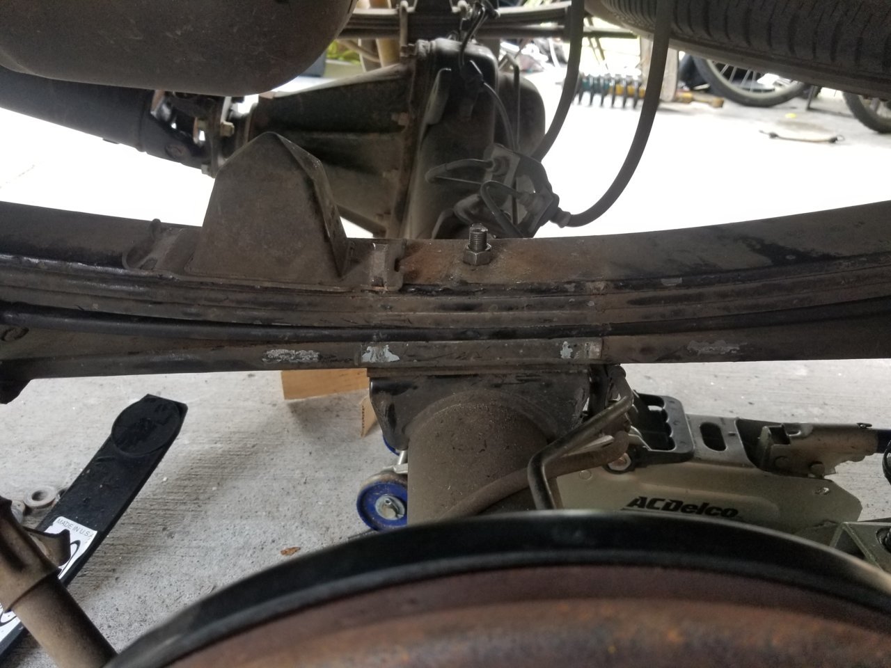

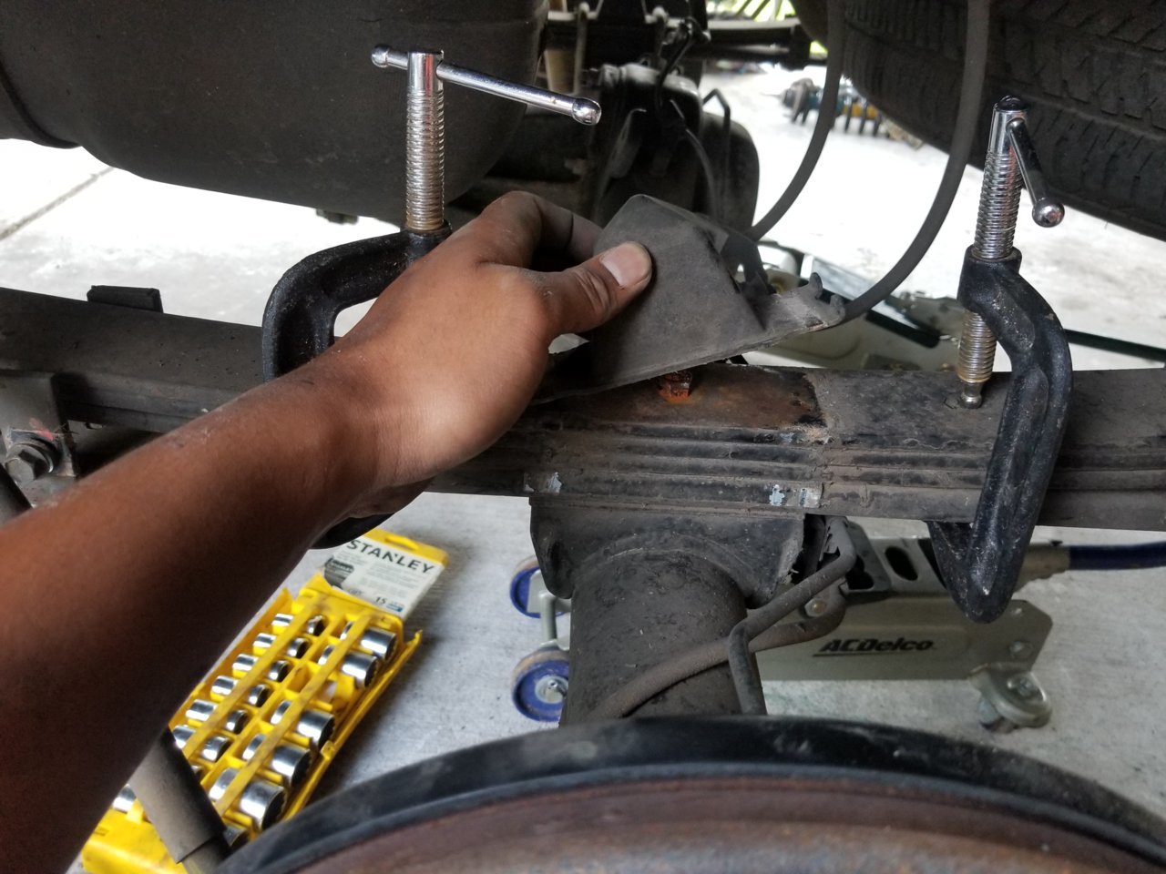

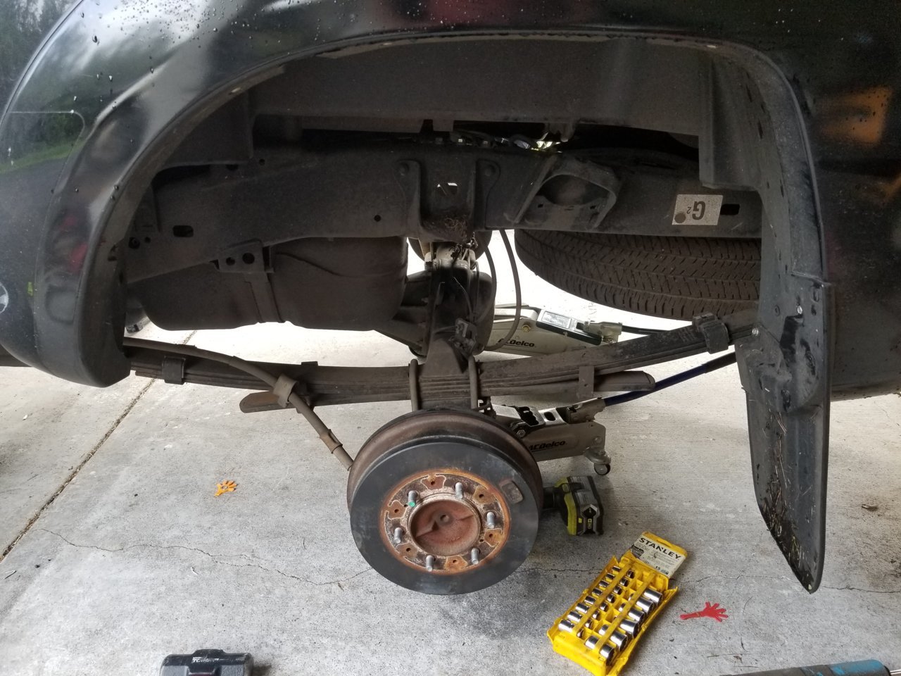

    Step 3: Rear AAL and Shock Installation

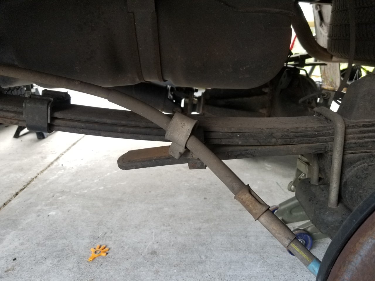

    Break your lug nuts and raise and stand the rear by the frame. Park the truck, block the front wheels and place fail safes under the car in case something goes wrong while you are under it.
    First you need to remove the rear shocks. It's super simple. Two bolts: one upper and one lower. Right after that you will need to remove the parking brake line so the axle can flex.

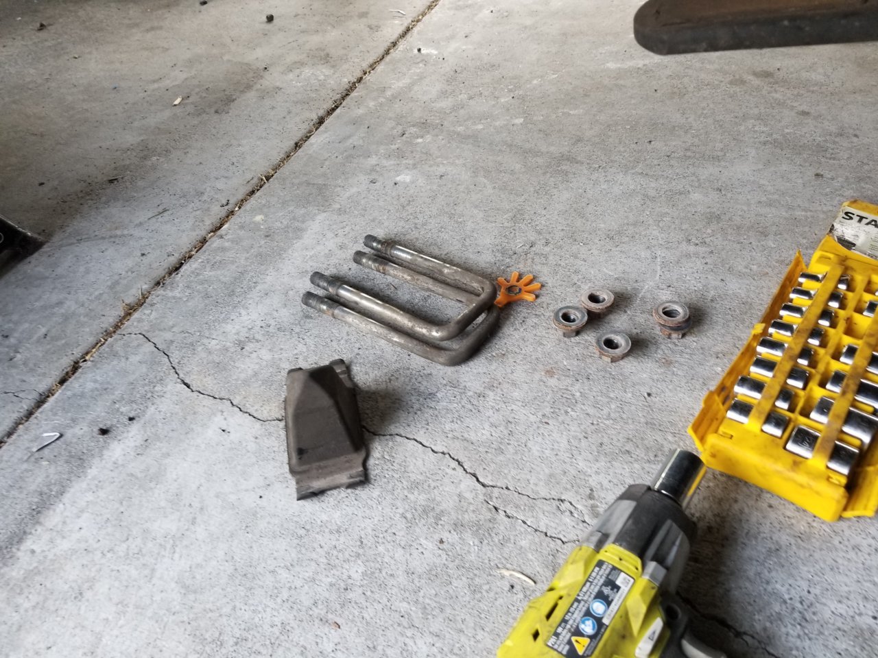

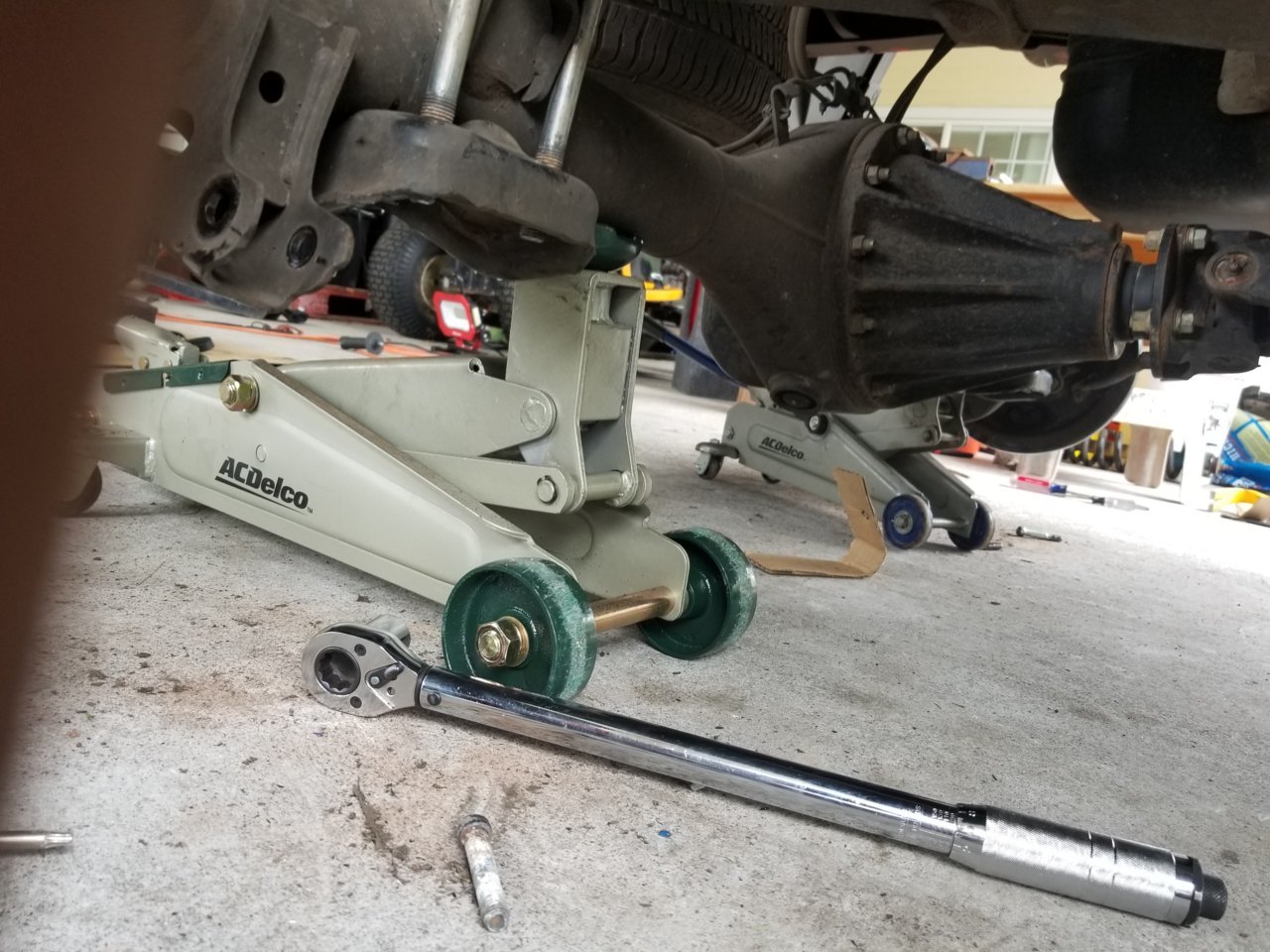

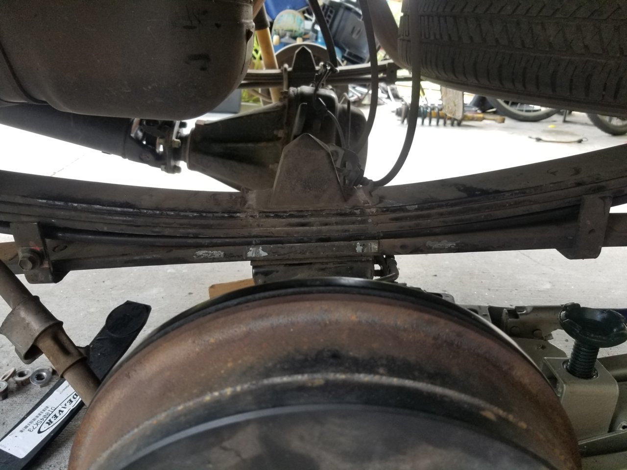

    Clamp the leaf springs together and remove the U-bolts. Pretty sure it's a 19mm. Get a gun under there and blast away.
    Once your U-bolts are off, clamp the springs together and remove the bumpstop
    Remove the center pin WHILE THE SPRINGS ARE CLAMPED. Loosen your clamps slowly so that you have room for you AAL. Install your AAL in a progressive pattern and not behind the overload spring. It should go from the shortest to the longest spring; again, not behind the overload spring.
    Take a look, my AAL is # 4 from the top
    Getting all the springs lined up for the centering pin is a pain in the ass. I found that a screwdriver in the holes from the topside is enough to center them to get the bolt in from the bottom. If you are having trouble getting the centering pin in, simply push the axle down on your side being careful not to disrupt brake lines. I used two floor jacks to support each side of the axle and raised and lowered them in opposing directions depending on what room I needed.
    Make sure you get you bump stop and U-bolts back in and tight. Reattach the paring brake mount and whatever brake lines you might have loosened.
    I didn't include pictures of the rear shock installation because it literally took me 30 seconds on each side and I totally forgot. It's super simple though. Throw your bushings in and bolt it up. Super easy. Just make sure you have steel washers in between you rubber bushings and bolts.
    Get your wheels back on and lugs tightened! Go get an alignment too.

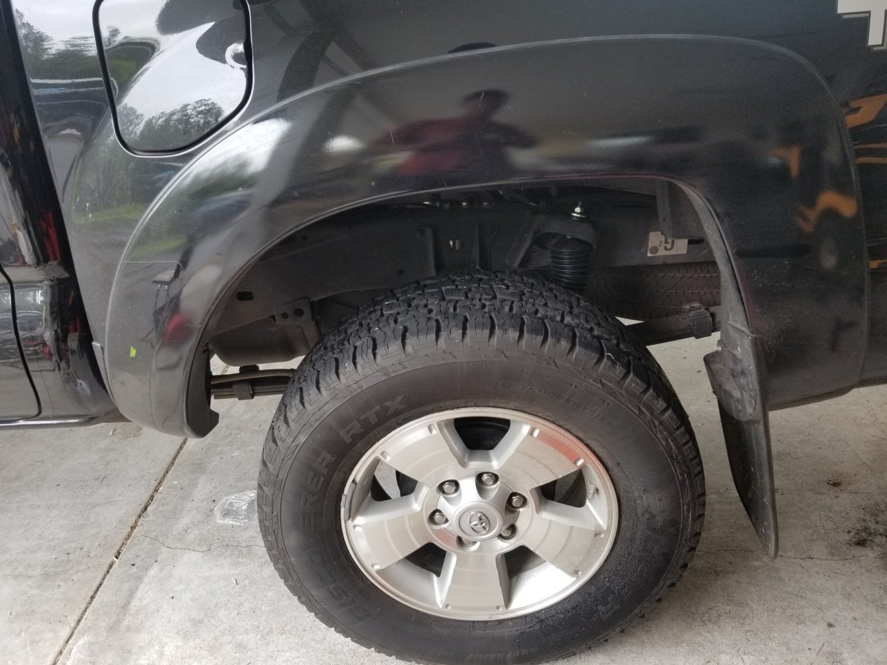

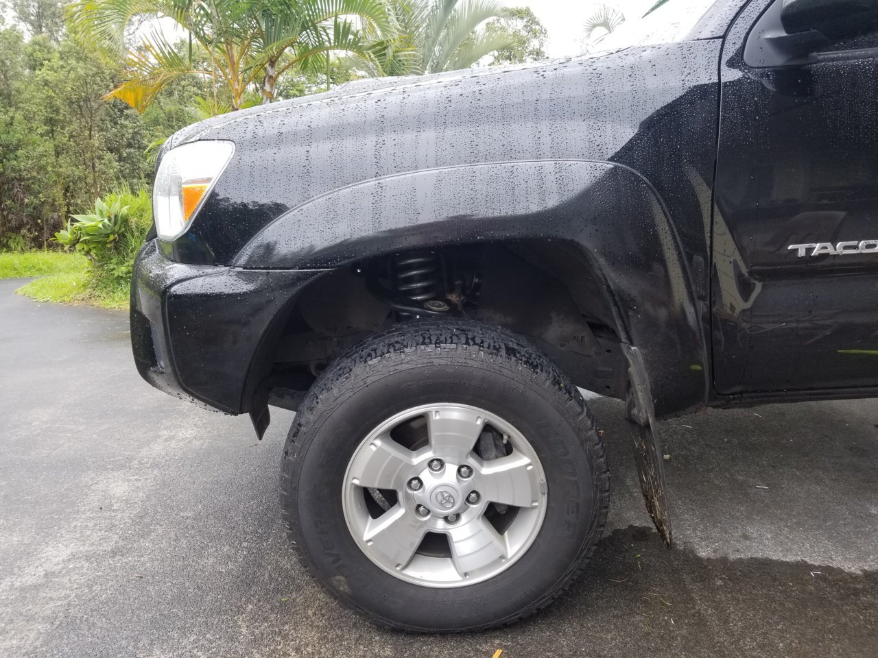

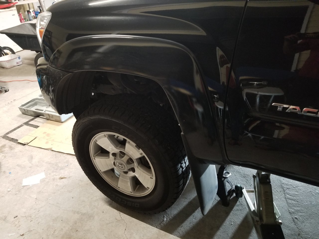

    Before
    After

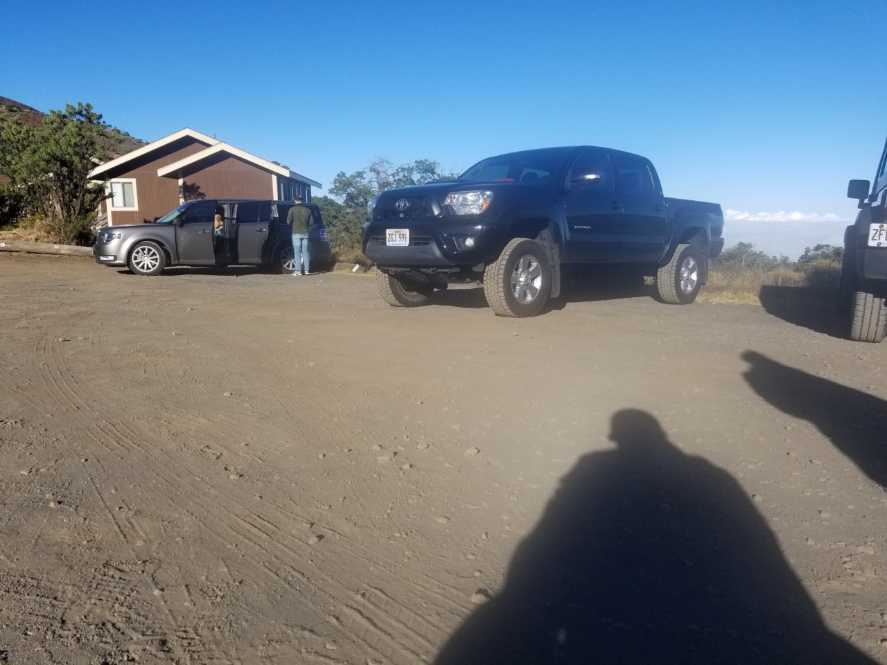

    I took the truck up to Mauna Kea the day I finished it and broke it in. It rides firm and confident. Not soft and foamy like the stock suspension. The handling and ride quality is so much better. No diving when turning or braking, and no more bottoming out on speed bumps. There was a tiny bit of rebound from the front, but it went away a day or 2 after the install and the springs had a chance to settle. I gained about 4" of lift on the first day. It's settled down to 3 1/2", right now, and it'll probably settle a tiny bit more. My next step is to get some new UCA's, probably the Light racing ones by SPC. I got my alignment in spec, but I don't like the angle of my UCA's right now. One of these days I am also going to do a tutorial for a 6" Drop bracket lift along with a 3" body lift so keep posted. 12" lift here I come!

    Who told you to do anything with your control arms? I remove/Install mine frequently with nothing more than dropping the sway bar...

    I found it easier to do because I can rock the entire sway bar back and strap it out of sight. If you are talking about the LCA, I am interested in seeing how you fit taller coilovers in without loosening at least the bottom LCA... stock replacements wouldn't require it, but unless you're handy with a crowbar and have a partner I'm sceptical about how you fit taller coils by only dropping the sway bar
