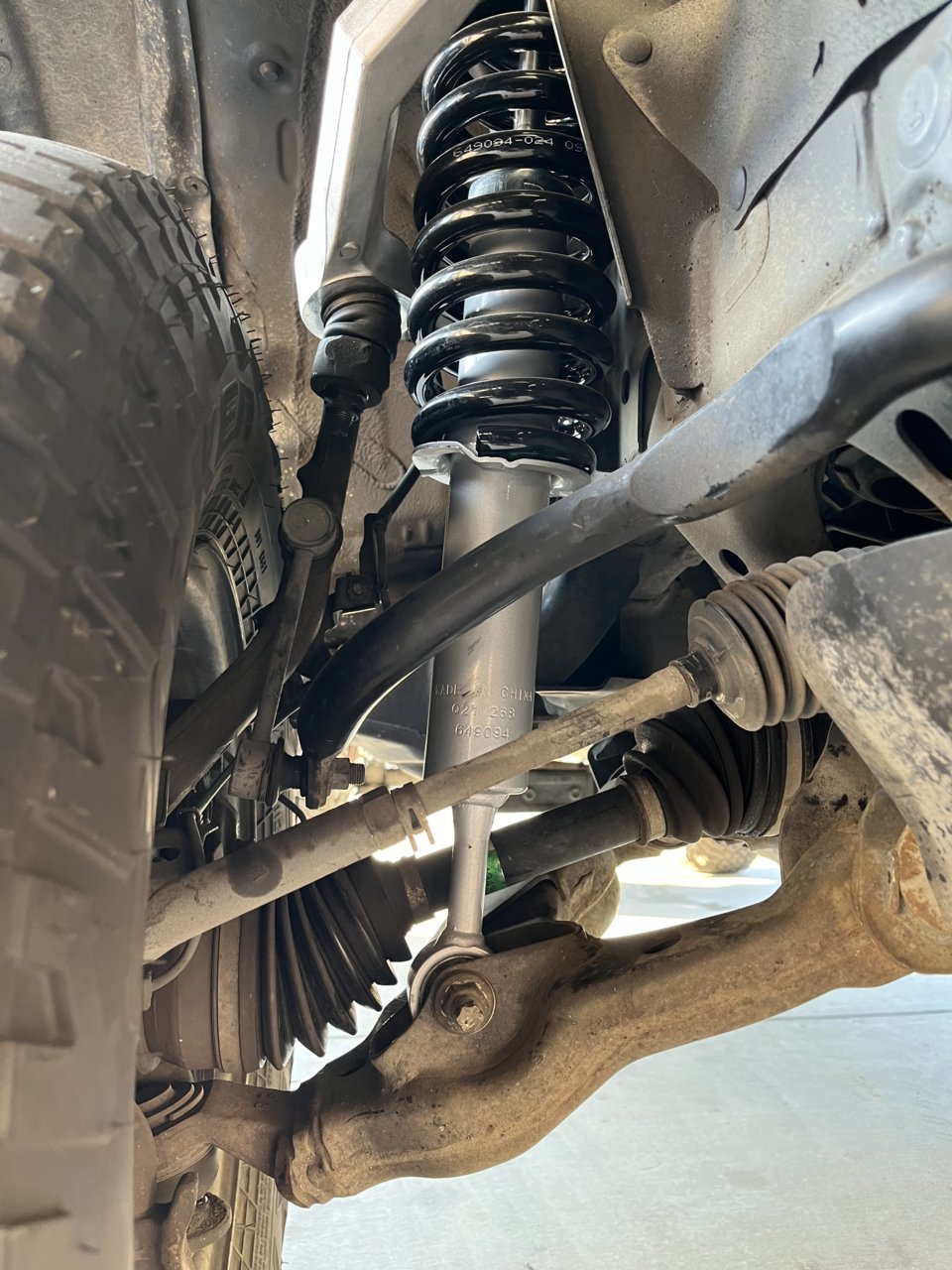

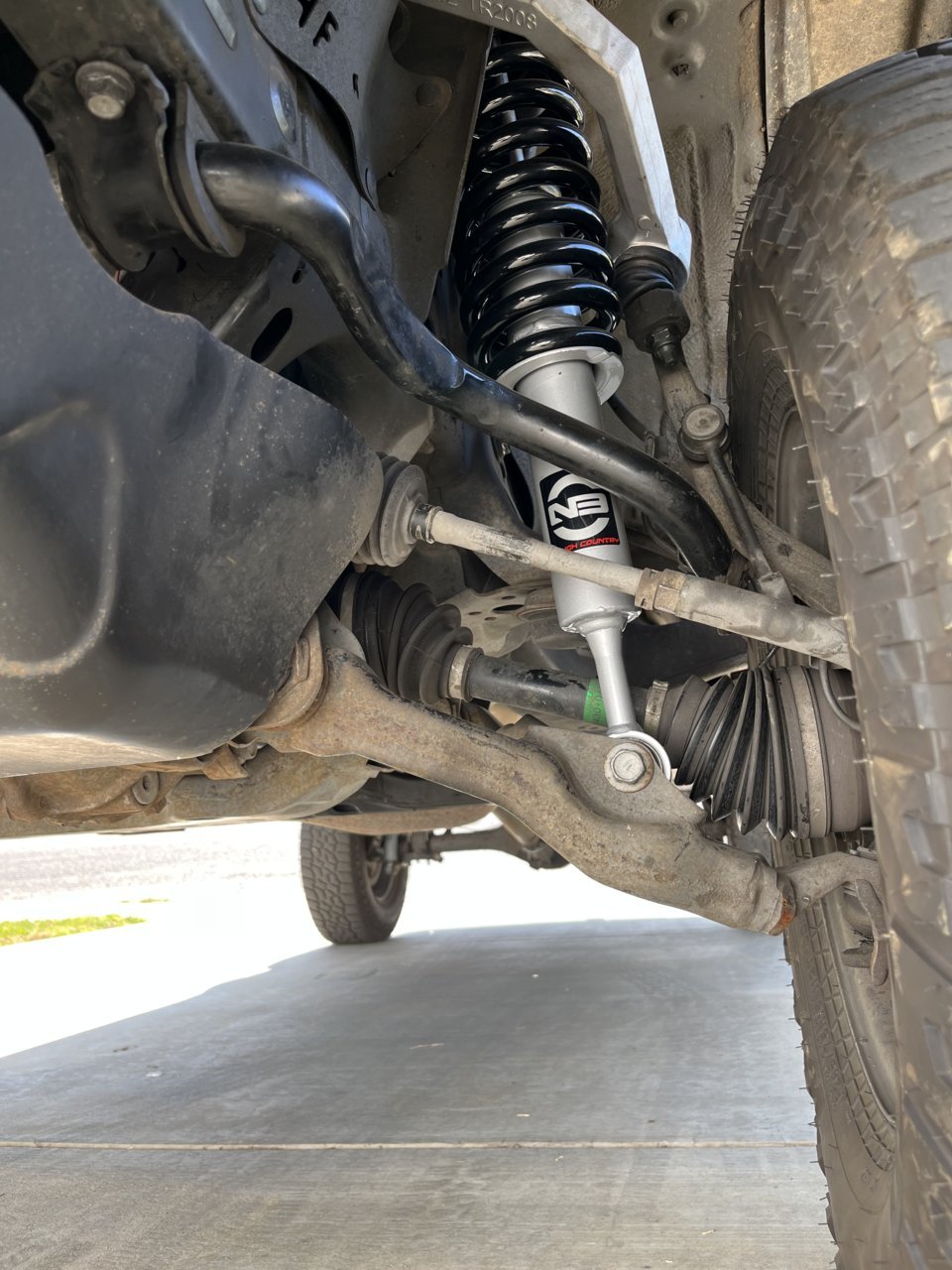

    Hello everyone. I’m new here, thanks for having me. I have a 2012 Tacoma Base model 4x4. Just added 3.5 RC lift. Upper arms/coil overs/ diff drop/ rear leaf packs/ rear shocks. Can you guys and gals let me know if my UCA angles and my CV angles are bad. I have about 200miles on the lift. Maybe it needs to settle but to me they angles look too steep. FCC2CE67-CABB-4136-9D56-3F32B481D8F2.jpg3D2FE6BD-FC96-4596-85DE-AA5065B8F5FD.jpg72C75056-ECF4-4FE9-AFDE-8D4B507176FC.jpg9B4F99FD-0418-4657-B6D0-F553D180E828.jpgFCC2CE67-CABB-4136-9D56-3F32B481D8F2.jpg 3D2FE6BD-FC96-4596-85DE-AA5065B8F5FD.jpg 72C75056-ECF4-4FE9-AFDE-8D4B507176FC.jpg 9B4F99FD-0418-4657-B6D0-F553D180E828.jpg FAEEECD4-34DA-4371-8891-2384CC2BFB77.jpg

    Yup, they are bad. The uca is dropping to far and the cv boot fins/accordion/baffles are rubbing. Going to lead to less down travel and going to wear out cv boot and possibly break/ruin the front axles.

    That’s exactly what I was thinking. I’ve seen others with this kit and doesn’t look as bad as mine.

    My alignment came out good. Drives straight.

    Good eye. I just noticed the clamps are off!! Thank you!

    Good catch

    Yes the diff drop spacers are installed.

    I also have the Taco lean spacer installed. Still sits a hair lower on drivers side.

    those are STEEP.
    anything over 3" of suspension lift on a 4x4 is a lot on these trucks.
