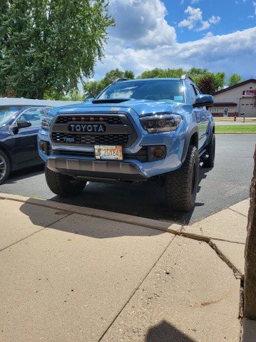

  8. Jul 26, 2022 at 9:03 AM
    Aqualoon
    Aqualoon More stickers!
    Jun 22, 2016
    #190263
    1,452
    Minnesota
    2019 Off-Road DCSB Cavalry Blue

  17. Jul 28, 2022 at 11:19 AM
    #17
    Aqualoon
    Jun 22, 2016
    #190263
    1,452
    Minnesota
    I wanted a certain look, I don't wheel - just rough gravel roads in Northern Wisconsin is about the extent I off-road. I did the lift, wheels and tires and in the summer I get a little over 18 mpg, which isn't bad.
    I'm happy with that stance, little bit of poke but with 285s it doesn't look all that lifted.
    Dkurtz42 and FloridaFree like this.
  18. Jul 28, 2022 at 5:16 PM
    #18
    Jer1623
    Jer1623 [OP] Member
    Jul 25, 2022
    #402111
    22
    Jeremy
    2021 Tacoma
    What lift did you end up going with the Rc? Looks nice I was thinking 285’s as well
