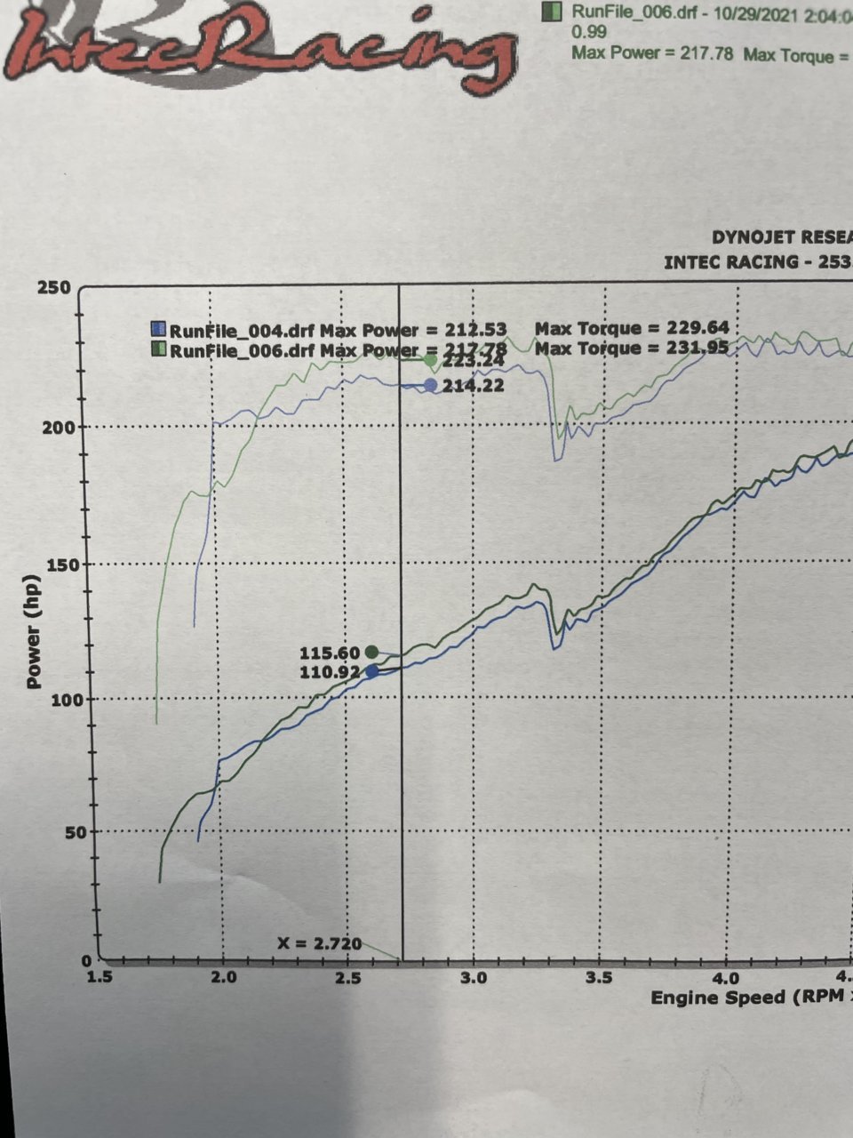

    Good on you for looking into a Y pipe replacement. The stock Y is very restrictive. I will have dyno results for the URD SPEC U system which has an equal length Y pipe very soon.
    I just Dyno’d the standard URD Y pipe last week which gets rid of the restrictive as hell crushed OEM pipe. As suspected by several members who installed this system that said it makes a difference, it gains 9 WTQ down low from the moment you hit the pedal. This is noticeable.

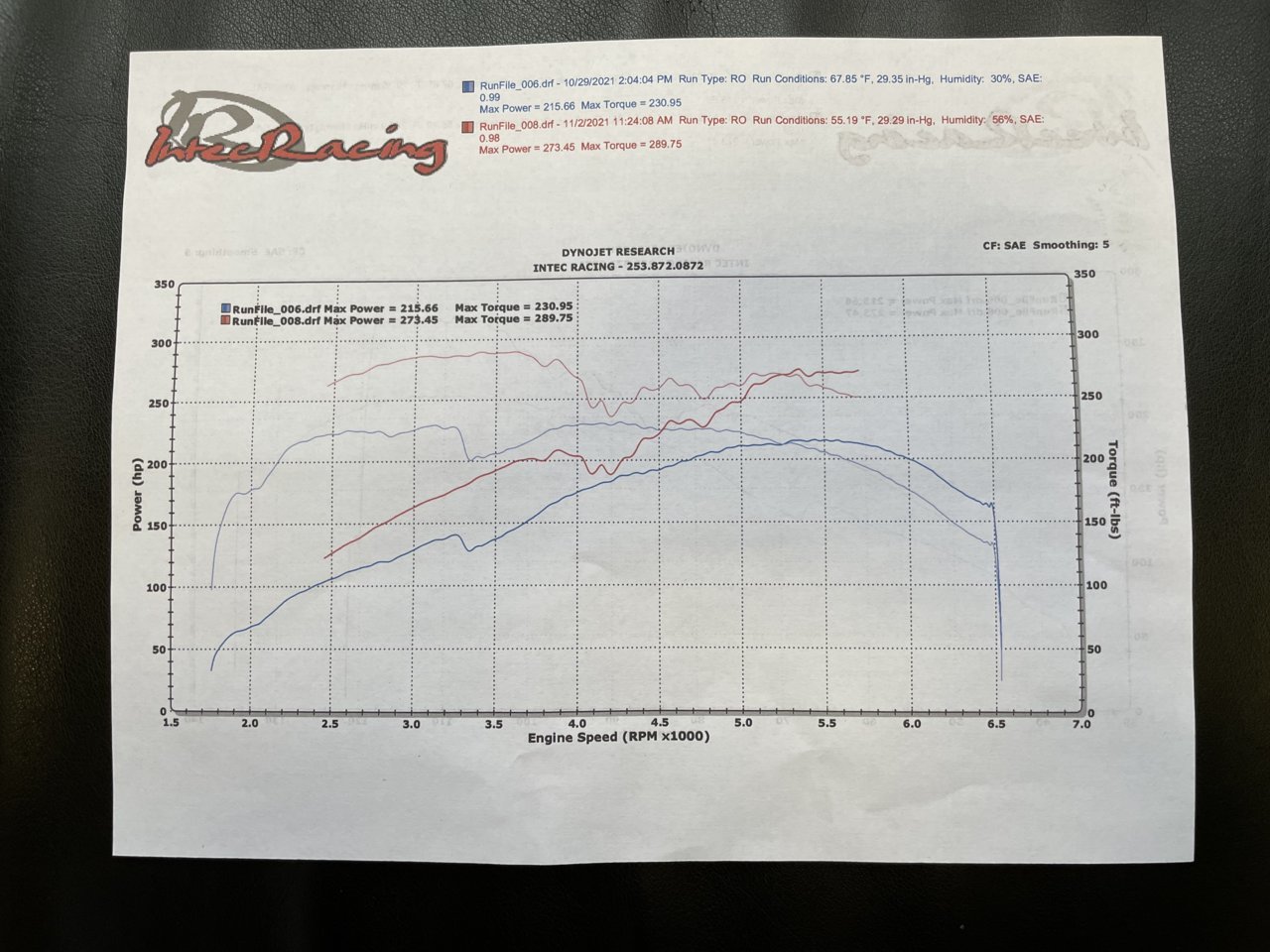

    The supercharger dyno was somewhat of a disappointment. See below. We got 273 WHP and 289 WTQ. The curve looks like dog shit and we are working out the potential problems one at a time. One of which is clutch slip, (just replaced yesterday with clutchmasters FX250). Second is rear brake drums sticking on dyno. Stoptech rear disc replacement about to get installed. Third is the tune. Working with @mZiggy to get his Yotawerx FI tune ready for release and it is coming along very nicely.

    Was also 4th gear pulls instead of 3rd, no?
    Formidable[QUOTED] likes this.
  19. Dec 9, 2021 at 7:13 AM
    #19
    Formidable
    Formidable Well-Known Member
    Jun 25, 2015
    #158158
    554
    2017 TRD PRO 6MT
    Yes. To bring @758_Moto up to speed, 4th gear pulls are no bueno. There’s a very good reason all the dynos for the third gen Tacoma are done in 3rd gear. The thought is the Toyota ECU has some torque limiting code when the truck exceeds 100 mph. I think OV tune confirmed in a prior thread that the ABS gets activated and the rear drums are physically engaged to limit torque despite traction control being completely off. Only way around it is to pull the ABS fuse. This will be done on the next run. In the meantime just going to get rid of the drums entirely. Rotors you can see and feel that they heat up. Drums we have no clue what’s going on.
