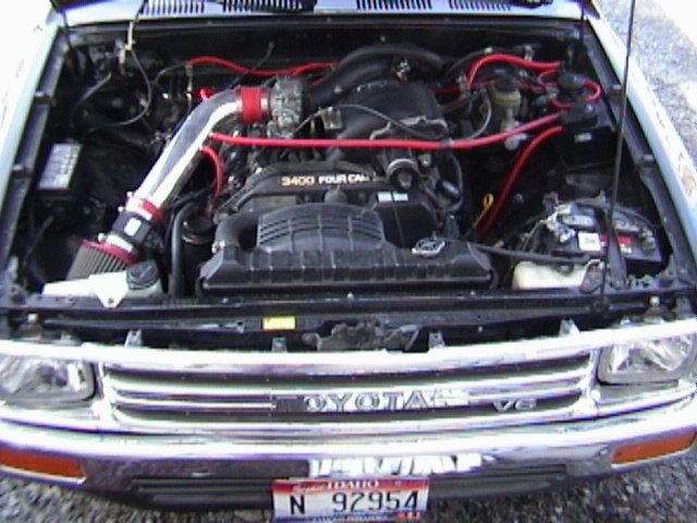

    Did you install your headers before putting your cab back on? That is what I have done knowing what a pain in the ass any header kit is to install on these V6 models. I have had 5 1st gen V6 Tacomas. First one I bought new off the lot late 2000 which was a 2001 SR5 V6 5 speed Xcab. All the Tacomas I had. I quickly passed on the idea of headers when the idea was considered because of the installation process. 24 years ago I did do a 3.4L swap into a 1991 V6 two wheel drive truck. I did put headers on that truck. Back then Downy Off Road sold headers that dumped down each side which made that install super easy. Joined the two sides together under the truck at the rear of the transmission. No cross over pipe over the transmission at the back of the engine. The high resolution big photos was this truck just before I sold it in 2007. The 3 photos smaller photos over 23 years old after I did the engine swap so the resolution is pretty crappy, but you can see the drivers side Downy header drops down. They are shorty style headers ending just a little past the mating point of the engine and bell housing. Someone should make these kind of headers. They make the install a breeze and can custom rout your pipes where ever you want them.
