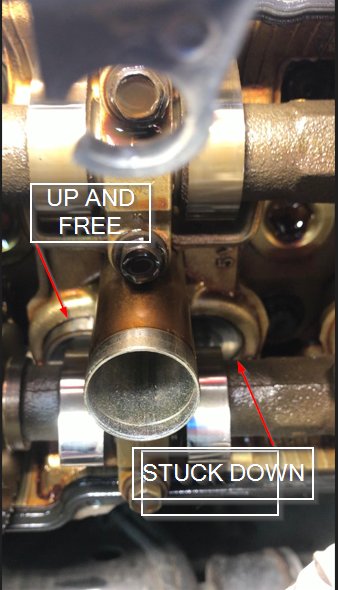

    I have similar problem with my 2002 tacoma with almost 90k miles. One of my exhaust valves on #4 stuck open after it sat for about 6 months. Ran flawless when I parked it, but when I went to start #4 was misfiring. Had new oil.
    Inspected with borescope and clearly see one of the two valves stuck open. Pushed a bunch of rope in the cylinder and rotated the crank a little to see if the valve budged, which could let me know if the spring was broke but the valve didn't budge.
    Just removed valve cover and can see the bucket is recessed. Poured about a tablespoon of marvels mystery oil over the bucket but no miracles so far. I am going to purchase some brass punches to see if the tapping method works, but I am not sure how much motivation I should apply. With the cam shaft installed, there isn't much room to place a punch on the bucket so I'll likely tap toward the perimeter of the bucket.
    Advice much appreciated!
  19. May 1, 2023 at 11:48 PM
    #19
    mechanicjon
    mechanicjon They call me "Jonny Stubs"
    Dec 2, 2016
    #203828
    10,141
    Jon
    Scottsdale Arizona
    04 Taco SC 4dr SR5 TRD Prerunner
    Supercharged, AEM FIC/6, Meth Inj, ION Alloy's, Radio & Phone steering Wheel controls,Fabtech AAL, Billie's wrapped with 880's , Tundra big brake conversion, bully bars and Pioneer DDin Stereo/dvd with exterrnal usb ports. 290K and going strong.
    Hmmm...
    You coulds give it a fairly good tap-tap with a brass drift punch and hammer. Next thing is pull cams. But that combustion camber looks suspicious. Any chance someone put suger in your tank? Why did you park it?
  20. May 2, 2023 at 5:54 AM
    #20
    forestrider
    forestrider Member
    Aug 1, 2022
    #402662
    5
    No chance. Gas cap is locked and parked in garage. Debris likely came from exhaust side.
