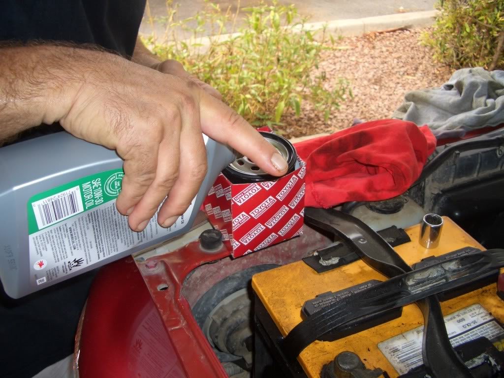

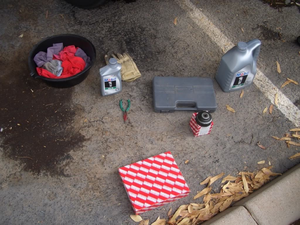

    First, You want to make sure you have all your things ready to do the oil change:
    Needle nose Pliers
    3/8" ratchet wrench
    4" extension (3/8")
    14mm socket (3/8")
    Filter wrench
    5.5 quarts oil
    Oil Filter
    Oil Catch Pan
    Lots of rags
    You want to park your truck on a level surface, with the front wheels turned all the way to the left.

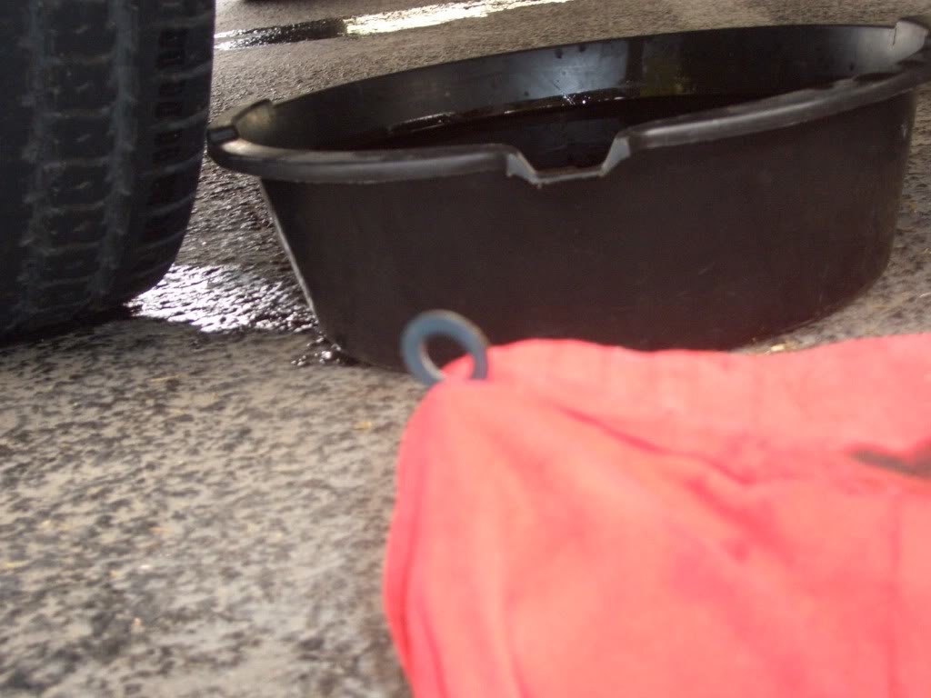

    Locate the Oil drain plug, and useing a 14mm socket, and extension, remove the plug, and drain the oil.

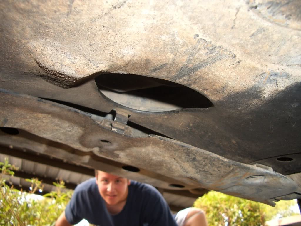

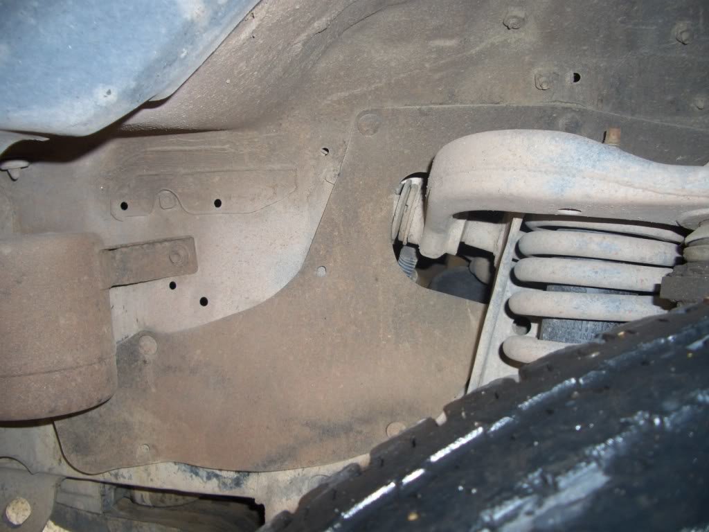

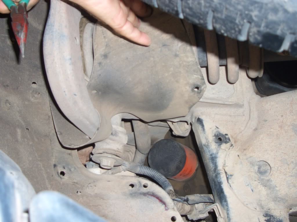

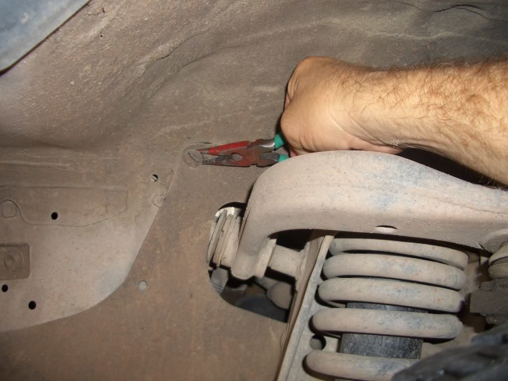

    While the oil is draining, Look into the driver side wheel well. Useing the Needle Nose pliers, remove the push pins holding the wheel well liner on.

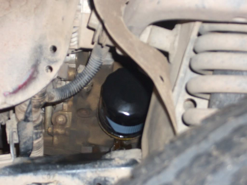

    You will then see the oil filter.

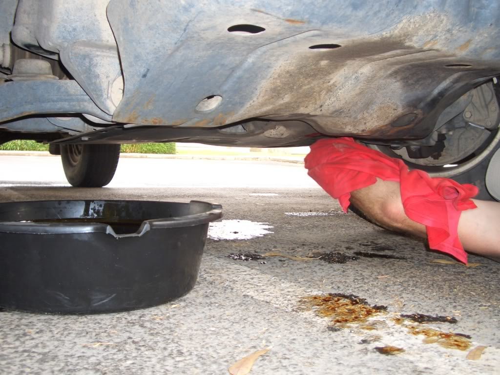

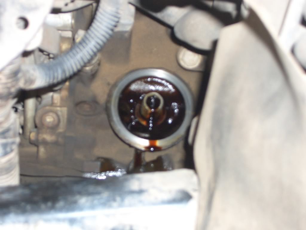

    Place a bunch of rags under the filter, on top of the skid plates, so as to absorb any oil that spills from the filter when its removed.
    Remove the old oil filter, and clean the filter mount of any dirt around it.
    On the new filter, Lubricate the filter gasket.
    Then install the new filter.
    Check the oil pan to make sure the gasket is not stuck to it.
    Clean the Oil pan around the drain plug, install the new gasket, and drain plug. Tighten the drain plug to 29 ft-lbs.
    Fill the engine with 5.5 Quarts of your favorite oil.
    Start the engine, and let it run for a few mins., then shut it off. Check for leaks around the drain plug, and filter, then check the oil level.
    All done! :)

    isnt there a cleaner way of getting the filter off without spilling the oil all over the freakin place? i just bought mine and when i changed the oil it went freakin every where. all over the skid plates and everything. it was dripping for a week. i thought i developed a new leak at first.

    I have the same problem as s2k, not sure if we have different skids or what but mine has no place for the oil to drip from the filter other than on the skid then goes everywhere..

    Use a 2-litre plastic bottle and cut the bottom off (about 4" from the bottom). Wedge that up in there underneath the filter & the lip. Unscrew the filter and let the oil run into the bottle. I would also let the oil filter drop in there. It is somewhat difficult snaking the bottle (with oil in it) out...but it's much better than having oil everywhere.
