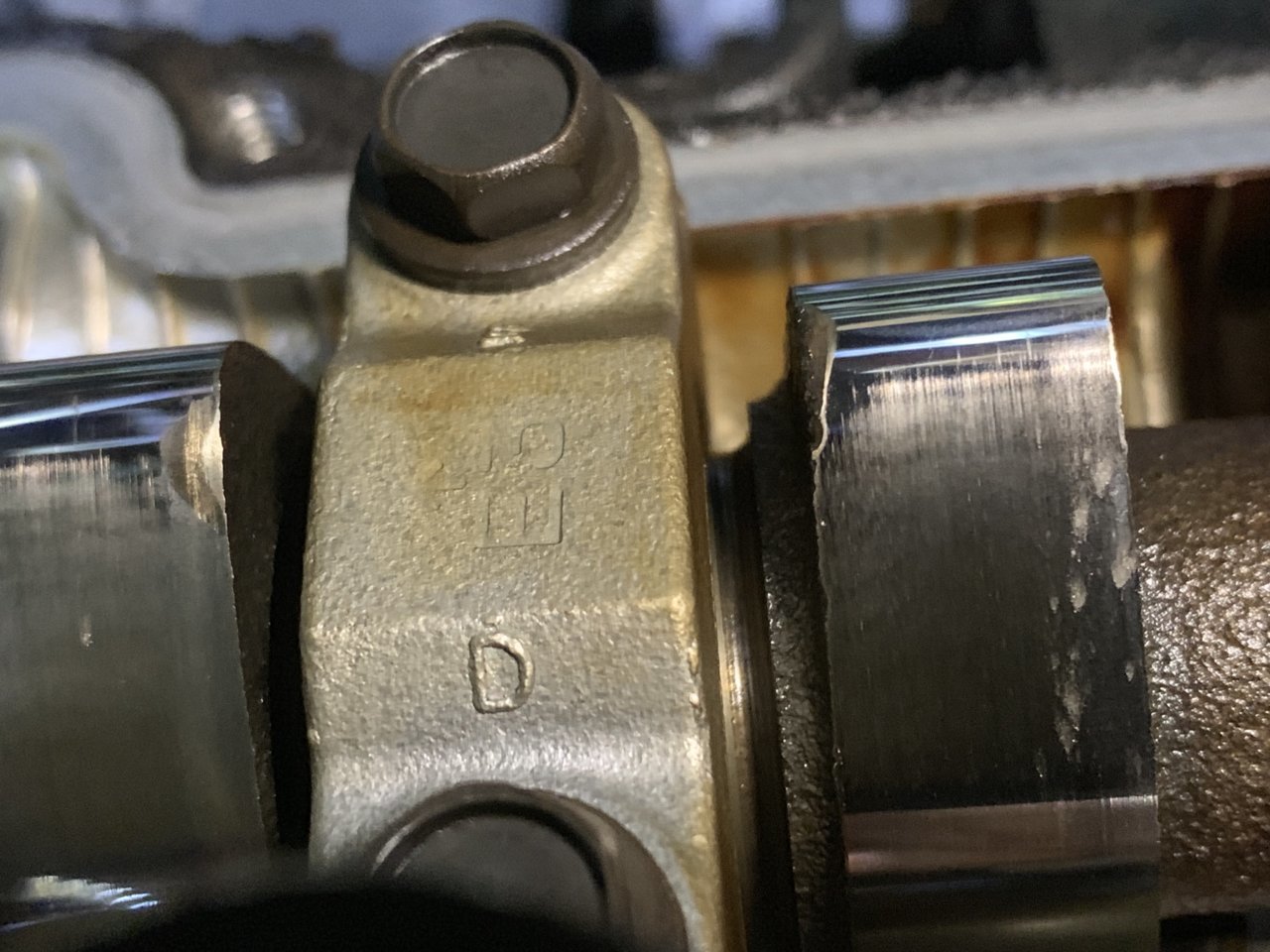

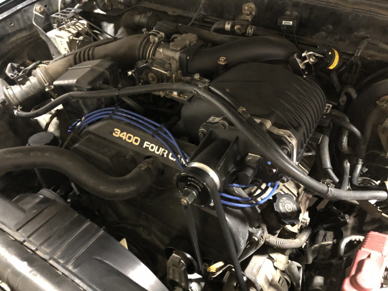

    57BC079C-8D4D-4280-8859-E4418B71B52C.jpg EF068272-0B5A-43C5-A5B2-56BC71AC8E8D.jpg Thanks guys! I will post when I do the install. It appears the 3.4 Stock internals are solid. I’m just going to throw new factory cams in mine because they are a bit worn.

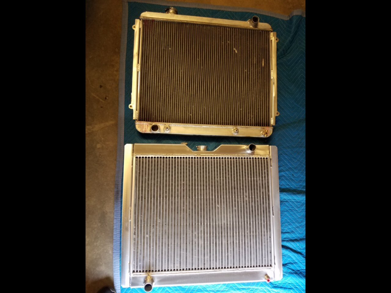

    Probably your best bet is to have a custom made radiator made for your truck,
    Stock radiator is only .75” thick in the core area. Have one made that is 2.25” thick and run a cooler stat
