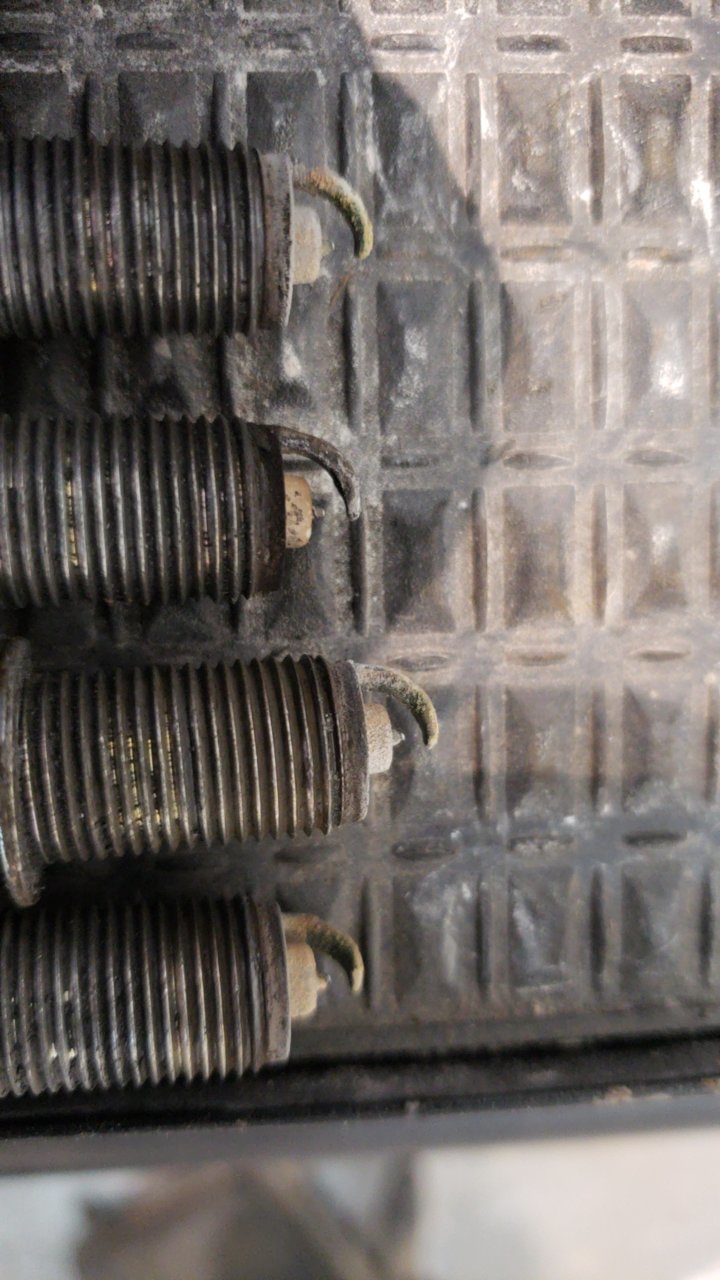

    So was the plug that came out if #2 a bit white? You mentioned corrosion but coolant can cause this symptom if you have a small crack in the head or the head gasket.

    The plug that came out of #2 was black around the bottom of the threads because of the misfire. They were all a bit white, but I wouldn't call it white enough to make me think I'm burning coolant.
    I'm also not losing coolant at a rate I would call above natural. I'm going to keep and eye on it and I'll do a compression test and see if I can get my dick beaters on a coolant pressure test, just to be sure.

  5. Jul 1, 2018 at 3:44 PM
    TacoMitch93
    TacoMitch93 [OP] Tasty Taco
    May 25, 2014
    #130530
    4,128
    Mitch
    Nova Scotia, Canada eh
    09 Tacoma SR5
    Here's a picture of the plugs, they run #1 through #4 top to bottom. Plugs are NGK Iridiums, aprox. 140xxx km
    Sorry for the blurry picture, I swear my phone isn't a potato.
