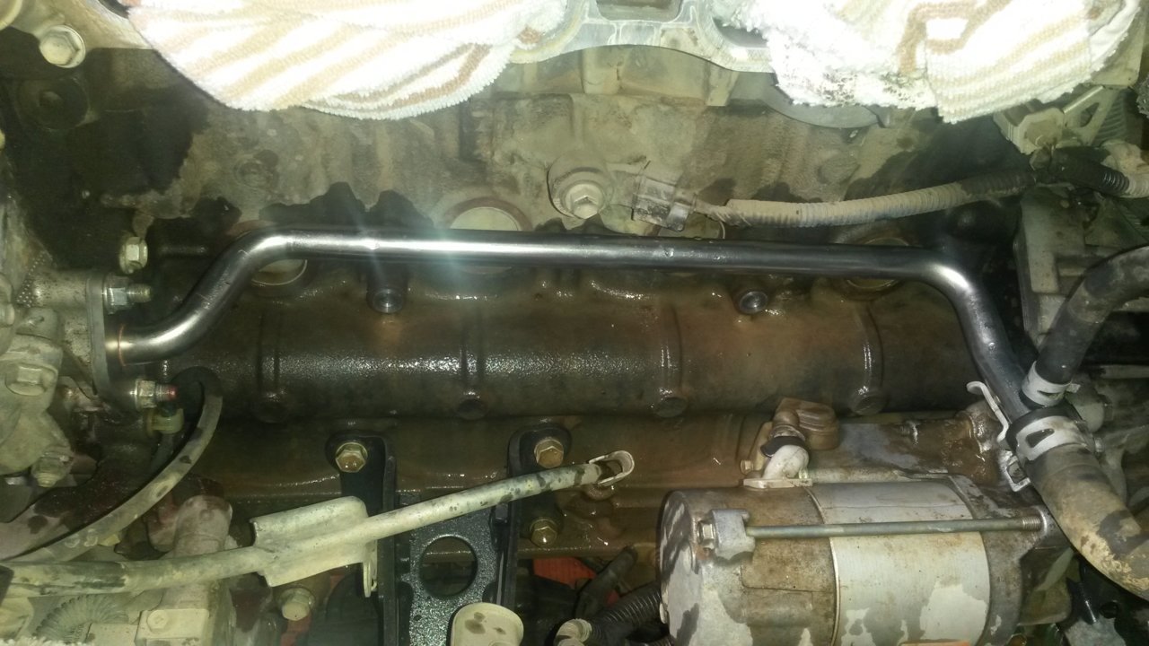

    Easy job if you have DIY car/engine experience. If you aren't confident enough to DIY it and you have a 2005-2008 2TR-FE you should REALLY go get this done ASAP at your trusted shop. Holy shit I can't believe it lasted this long. It literally disintegrated in place as I took the intake off.
    Look as my first pic. You see the vertical nipple coming off the new metal piece that's absent on the old black plastic pipe? That's because it snapped off inside the rubber hose as soon as I wiggled the intake manifold/throttle body after unbolting them. But I needed to re-use the hose part so I needed to get the broken nipple out of it which I did with a wood screw. But it literally came out as MUSH. That little pile of shit is the broken off nipple that I pulled out of the hose. That's how it came out. The other side with the two-bolt flange wasn't any better, it snapped off as soon as I touched it and was about as strong as wet cardboard.
    Get this fixed if you haven't!!! And don't go poking around touching it unless you already have the parts because it will break! This absolutely should have been a recall.

    And to provide an answer to my original question: I didn't end up draining any coolant from the block or radiator because the disintegrating pipe did most of the job for me before I even got to that point. About half drained out and up until this point I've put in slightly under one gallon to bring it back up to full. I'll wait until it's had a few more heat/cool cycles to let the air out before I make this my final answer but so far it looks like if you just pull the pipe and let it pour out you only need to buy 1 gallon.

    Not sure if I agree with the overall sentiment of your post, at least in this situation, seeing as they switched back to metal in 2009. I'd say they quickly realized that whatever latest and greatest cost-saving pipe design/material was sold to them turned out to have an unforeseen inability to perform as promised resulting in an "oh shit" moment and a prompt redesign with the hopes that it doesn't result in so many blown head gaskets that they're forced to do a recall. I guarantee they were prepared for that if it turned out these things were failing even sooner/more catastrophically than they actually are.

    I think the major issue of it it that it attaches to largely unsupported lines. So as the plastic gets more brittle (as plastic is apt to do next to heat) the bouncing of the heater and throttle body lines makes it more likely to crack around the barbs. The pipe you guys use is actually the same old part that fits the 3RZ, so at least they had that ready to go, and it is a good upgrade. But I wouldn't be too surprised to see other plastic/nylon/PA6 parts like this begin to creep back in, it keeps production costs super low and typically they hold up well beyond the warranty years (which is all they're worried about)
