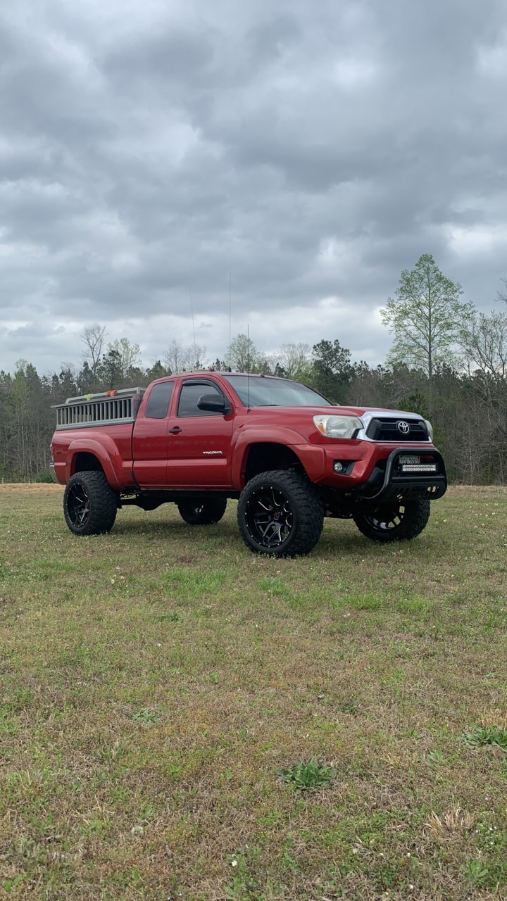

    Hey guys, I have a question about whether I should change my transmission fluid or not. The truck has 140k on it. 2013 Tacoma access cab 4wd Automatic 4.0. As far as I know, the fluid has never been changed. The dealership last had it at 87k when the last owner purchased it but no records of any service done to it. In some cases, I have heard it is better not to touch anything. It is lifted 6inches with 33s and the truck does also have a dyno tune with retuned trans shift points. Let me know what you guys think. Not sure if this has been talked about or not cause I could not find anything with similar info so sorry if this is a repost.
