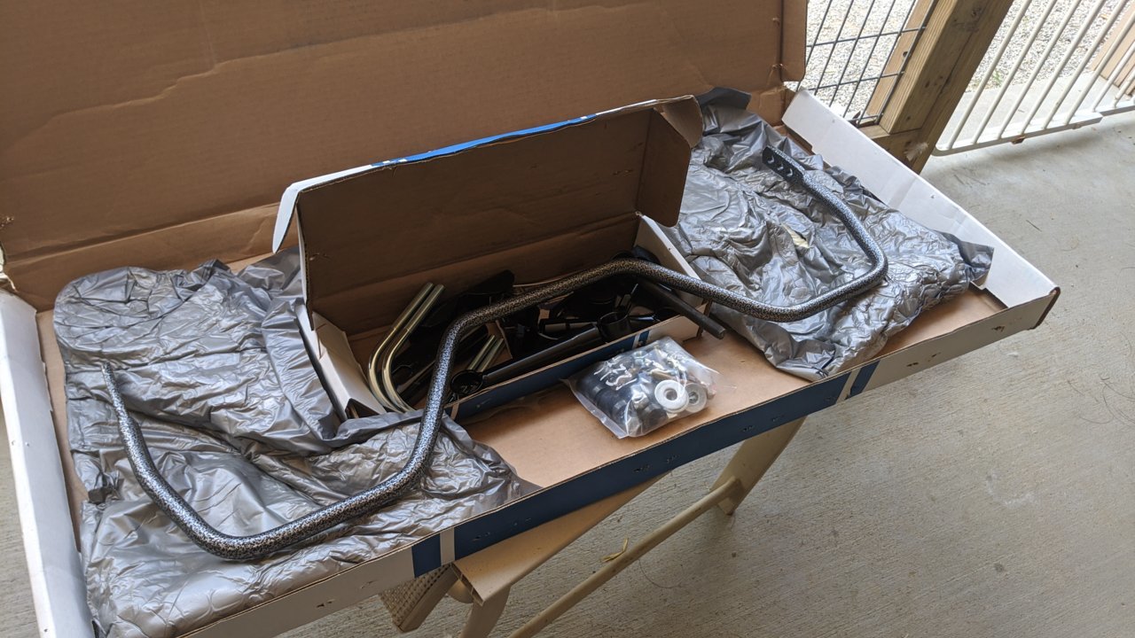

    I decided to buy the Hellwig rear sway bar for 2nd gen trucks. @Torspd made a good point to take some pictures, so I did. This isn't a real review, and its not really a full tutorial either, just a general overview of the install since I wasn't able to find anything similar when looking into reviews of this bar for our trucks.
    The bar cost me $240 shipped to my door, and the kit seems to of good quality.

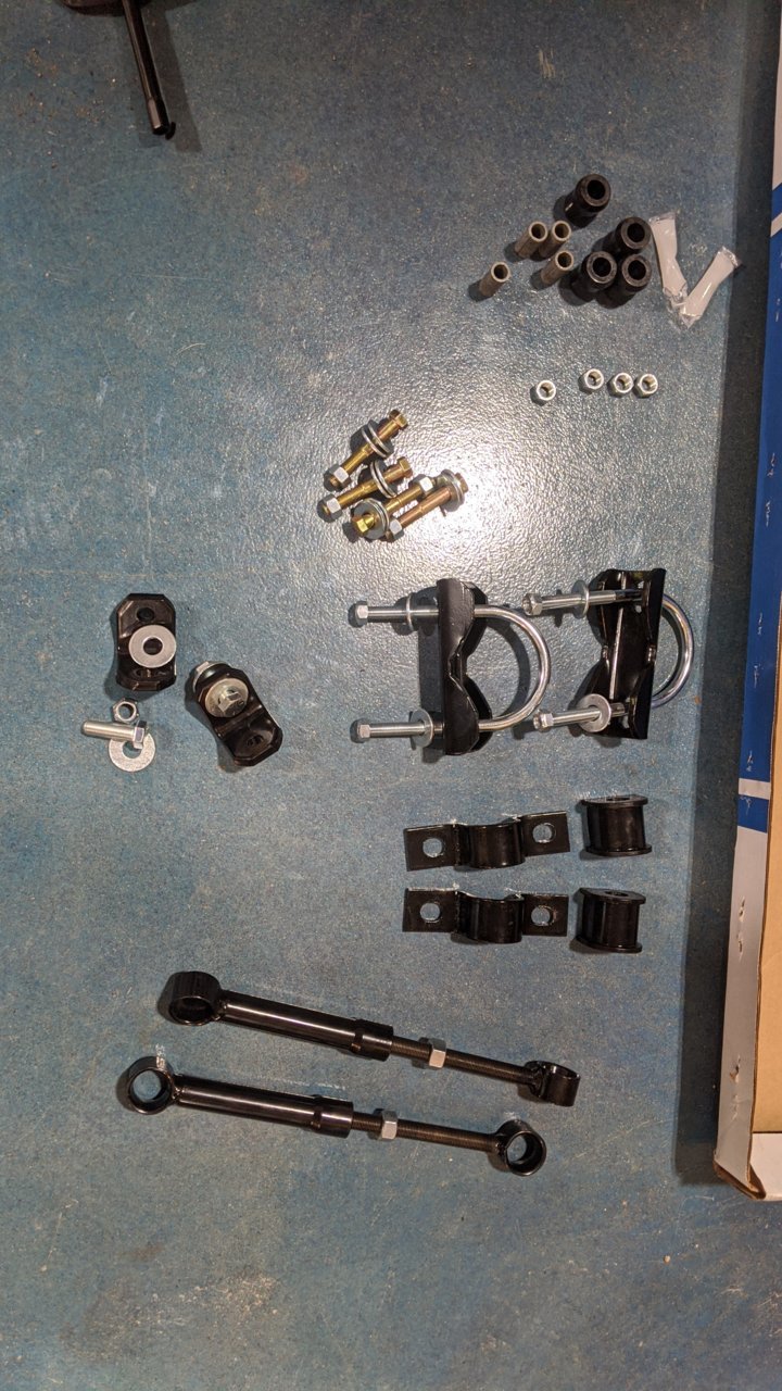

    According to the literature it is a 3/4"s bar that feels to be solid. (as opposed to hollow)
    I went ahead and laid all the hardware out in order to figure out what needed to go with what and how many. Its worth noting that the U-bolts are double nutted, normal nut first then a lock nut on top of that.

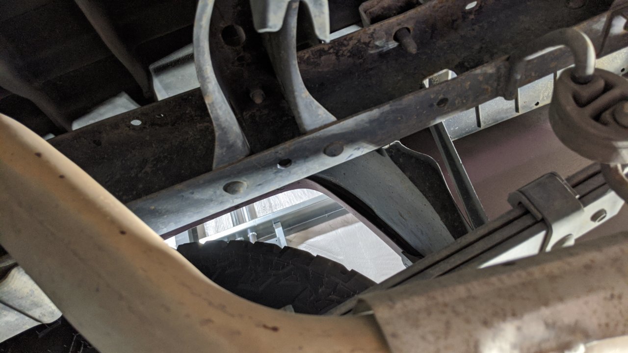

    This is where I drilled a 1/2" hole for the largest bolts the kit came with. I measured about 2" in from the center of one of the rivets holding the rear X-brace, as that is what Hellwig seemed to do.
    (Same thing on passenger side)

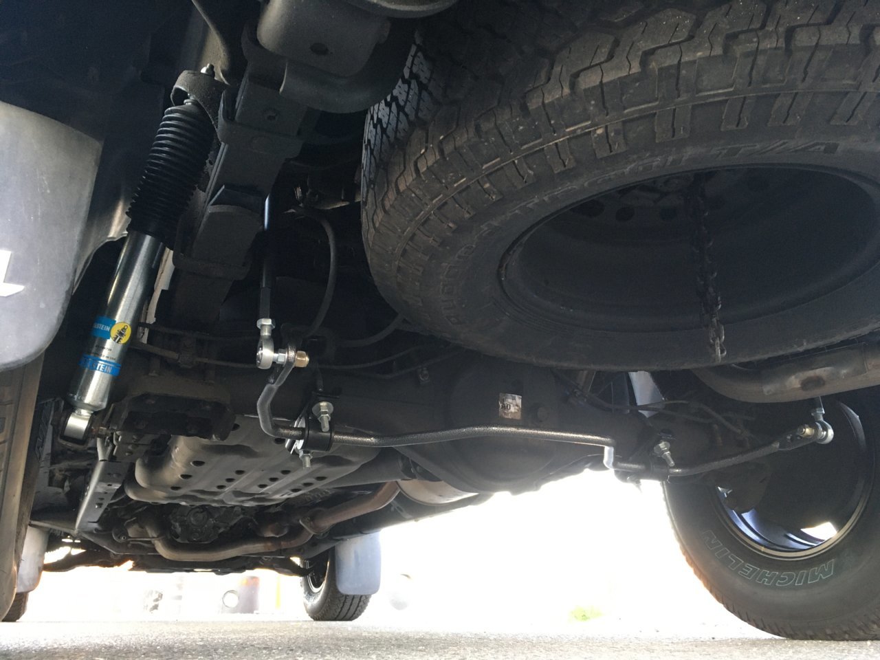

    I addressed it by making my own end links using PTFE-lined rod ends, and mounting to the outside of the bar, straight up into the frame rail:
    Coupled with Hellwig's front bar, the truck corners like it's on rails. Of course, this comes at the expense of off road articulation (not an issue for my use case).

    That's a much nicer solution! care to drop the parts detail on those end links? If not, no worries.

    The rod end joints are McMaster-Carr # 60745K661. They are alloy steel joints made by FK, rated for over 16,000lbs! The PTFE liner keeps them nice and quiet. I machined the main body of the links from 3/4" aluminum hex bar, tapped each end for the respective threads, and powder coated them. Energy Suspension bushing set # 9.8126G (88A durometer) along with some grade 8 threaded rod + washers top it off.

    Seems I have an upgrade to make now. :D Thanks!
