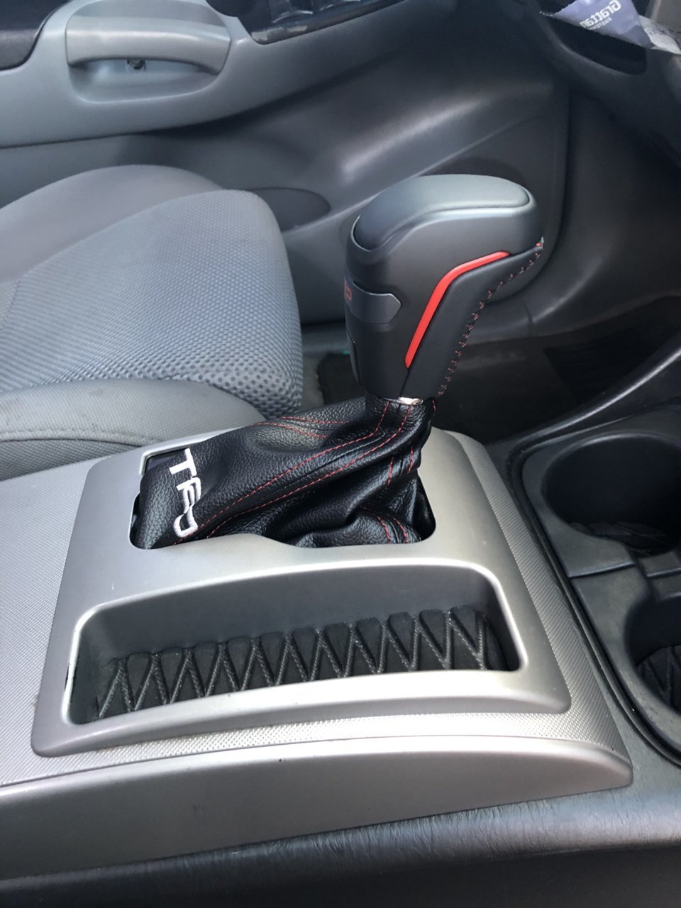

    I just wanted to share a mod I did to my truck with you guys. I think it came out really nice.
    First I started with a 2016+ Tacoma trd pro shift knob.
    Then I bought a trd shift boot off of eBay. (Universal).
    For the install, i trimmed the bottom of the shift knob so the sleeve that came with the boot can slip over.
    Next I bent a coat hanger to the shape I wanted the boot. Then I sewed the boot around the coat hanger.
    Lastly. I glued the boot to the shifter bezel and cut the gear selector cover to fit around.
    Let me know if anyone wants links and I will post them.

    Looks slick. Would drive me nuts though to have an obscured gated shifter. I can shift mostly by feel but getting to some of the lesser used gears on the auto takes a quick glance.

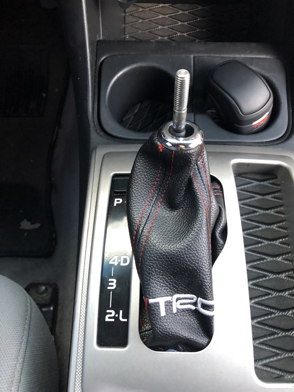

    My addition

    Looks amazing, and relatively easy to do. the only barrier to entry I see is the cost.

    I was thinking a reducer would be nice too, but I don't like the diameter of the rod, its way too thin and doesn't look robust enough. I think a leather boot like OEM 3rd gens look the best.
