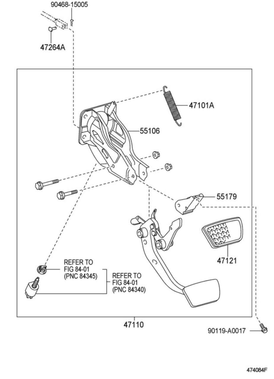

    Parts
    This will be mostly be just a dump of various exploded view screen shots. For reference purposes more than to provide part numbers.
    6speed Hydraulics
    5speed Hydraulics
    With VSC
    Without VSC
    FJ Clutch pedal
