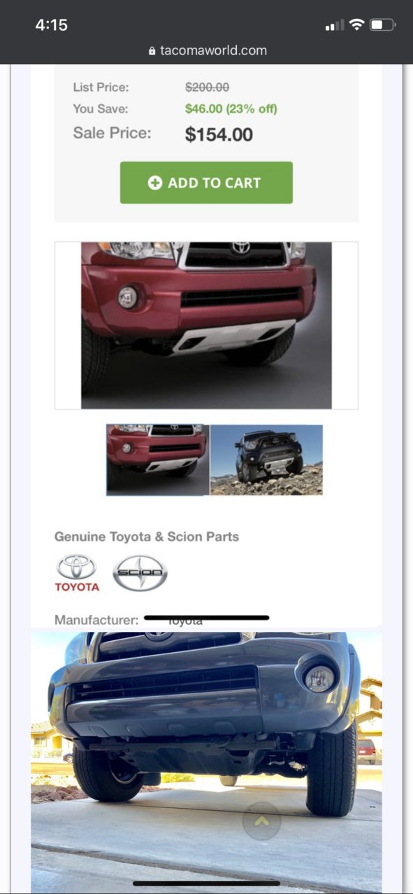

    Will this skid plate fit on my 2010 SR5 4x4? My MGM SR5 comes with a different looking skid plate.

    Yes

    Do you know if I need new/different bolts?

    It should come with everything you need to install.

    What you have under your truck now is a splash guard. It isn't really a skid plate, rather just a thin gauge metal shield to keep muck from splashing up under the engine. Mine rusted out (despite POR-15) after about 6 years and I just replaced it.
    The plate you are looking at isn't really much of a skid plate either. It is aluminum and reportedly folds pretty easily. I'd say it is more of an accent piece than true trail protection.
    FWIW, I bought a Bullet Proof Fab plate that mounts similar to the plate you are looking for and gives protection to that area under the radiator.
    It is a bit more expensive, but offers much greater protection.
    In both cases, the skid plate mounts over the existing splash guard. The rear of the plate uses the two existing splash guard bolts. The front of the plate uses two new bolts that pass through the splash guard and are captured by existing nuts in the front cross bar.

    @45calmike, that is a very good price on a new OEM skid plate. I think I paid $200 for mine new.

    I currently have the same splash guard/skid plate OP has in the picture above and just picked up one of those white stock skid plates used w/o any hardware. Anyone know if they use the same bolts? Don’t want to take the guard/plate off only to find I can’t mount the replacement skid plate until I order new hardware..

    Yes 2nd and 3rd gen skids bolt up to the same places same hardware etc
