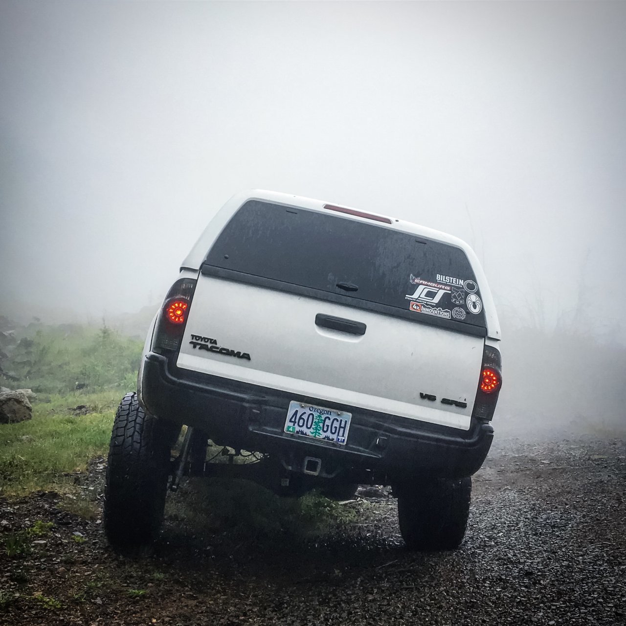

    Testing out the new rear set up.
    Dakar Heavy Duty leaf packs, Bilstein B110 and Wheeler’s u-bolt flip with Super Bumps.

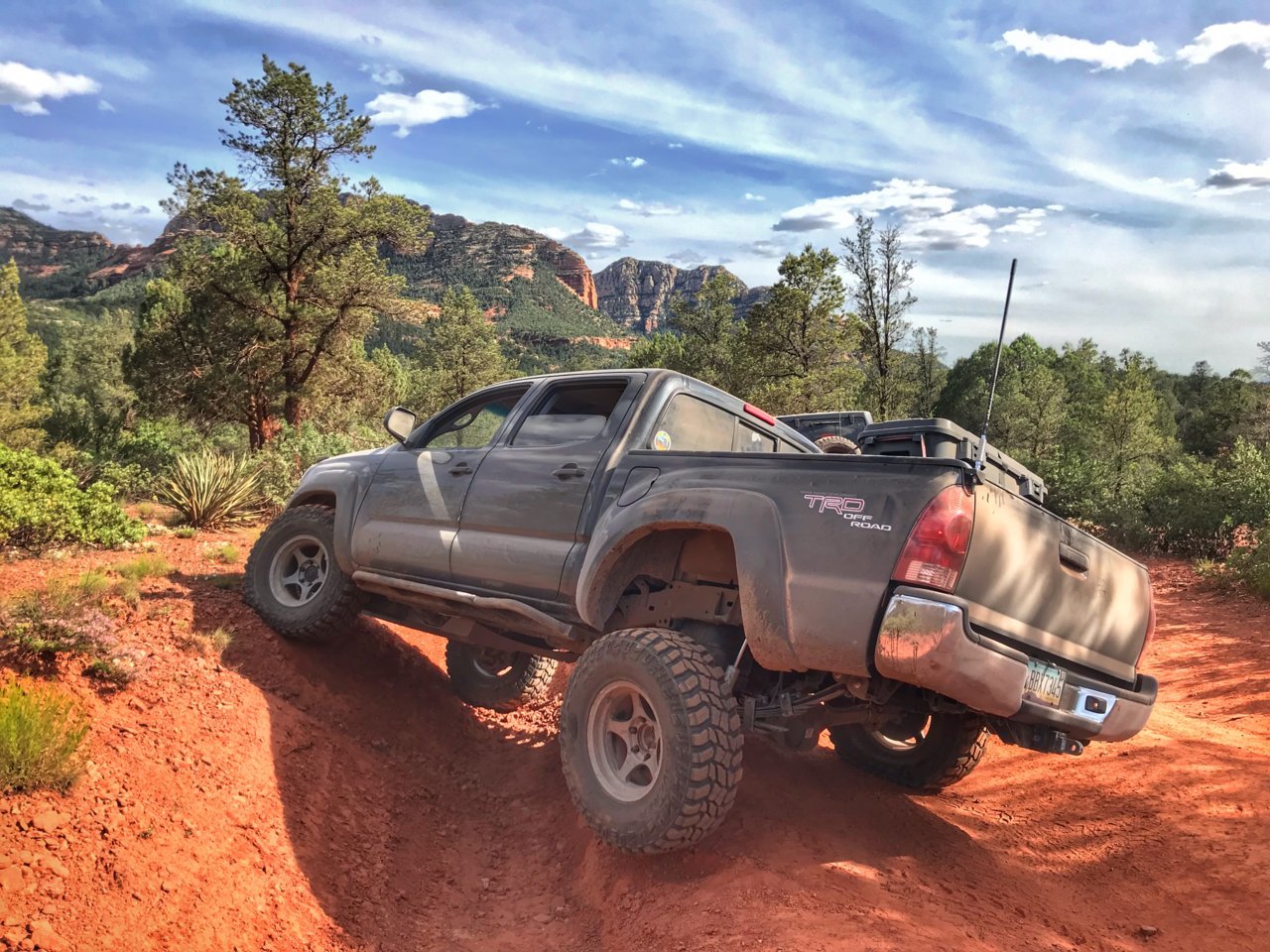

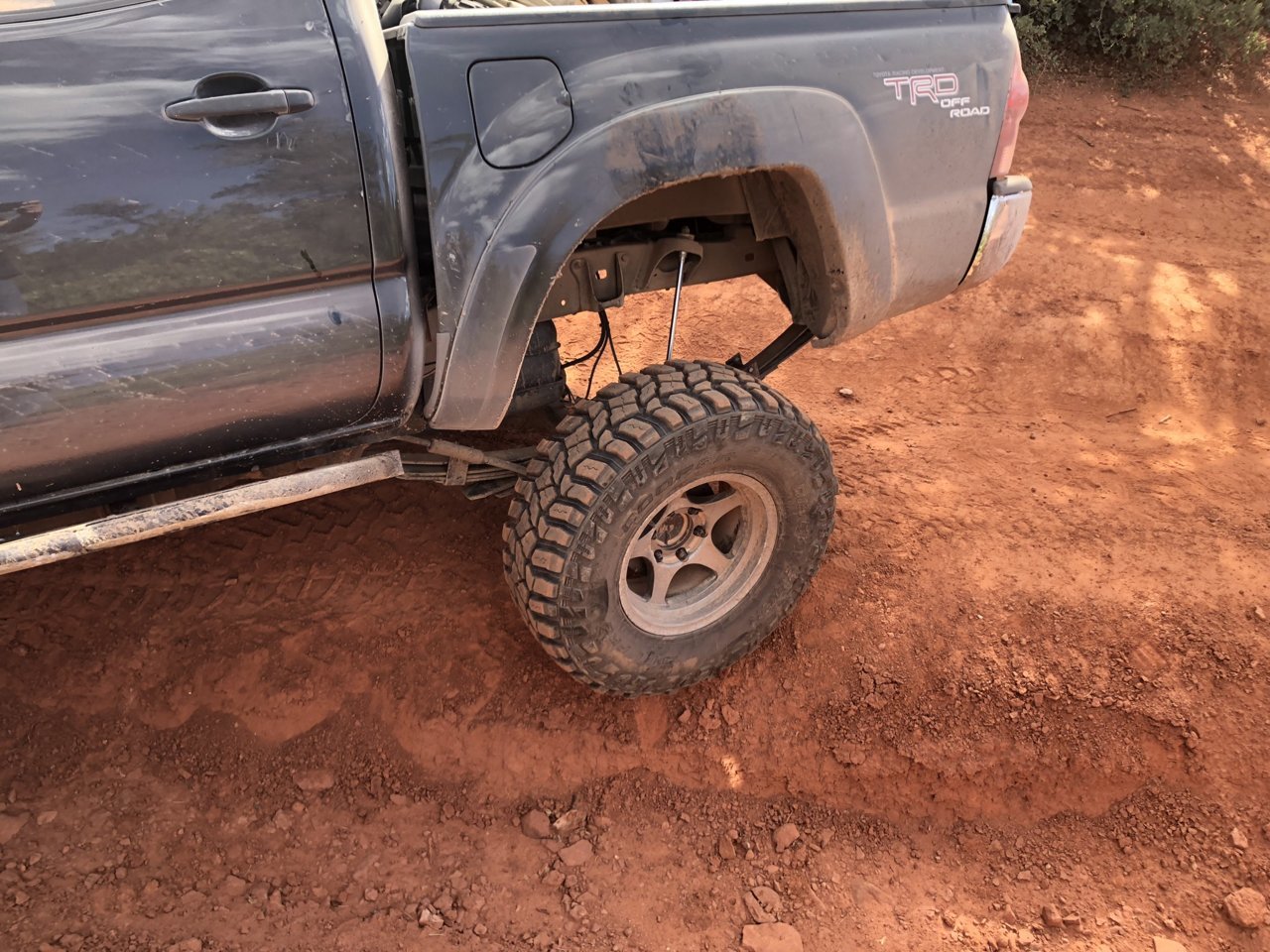

    Here’s mine just like Ryan’s.
    B110 shocks, Dakar standard duty leaf pack, superbumps, extended brake lines. And polyurethane bushings in stock shackles.
