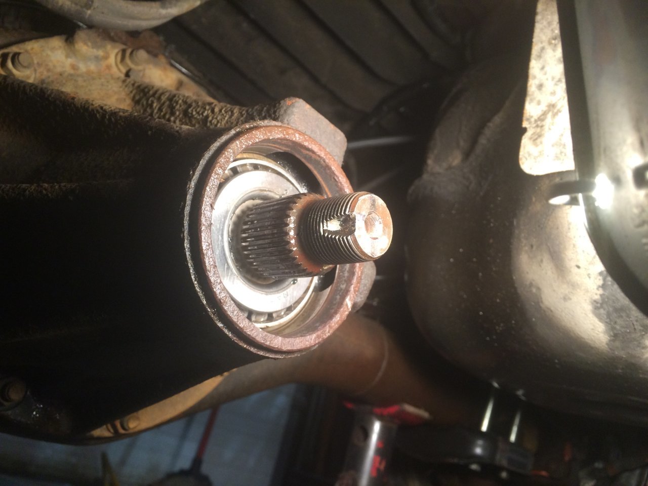

    On my 007 Taco Pro the rear end diff pinion seal was leaking gear oil. Its time to fix this
    Jack up your truck support with proper jack stands !!!! safety people safety !

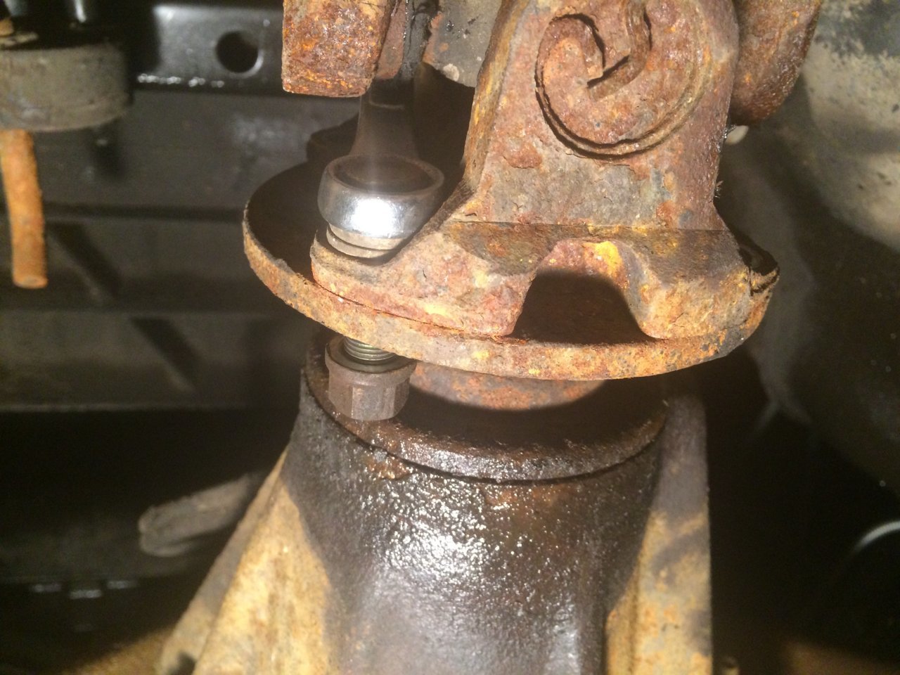

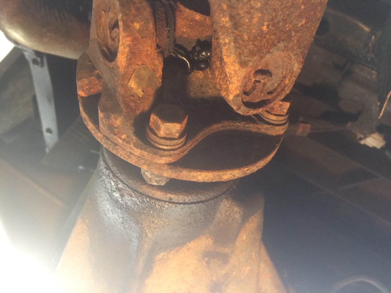

    Mark your drive shaft flange and pinion flange so it goes back the same way
    Start with removing your drive shaft, two 14mm wrenches will be needed to remove the 4 bolts. I placed the 14mm on the nut side so it would bind up and i would not have to hold it, i then took a bigger wrench and slipped it over the open end to use for leverage. Once 4 nuts and bolts were removed I had to tap the drive shaft flange to free it from the pinion flange. Take drive shaft and secure up and out of the way, If this falls and hits you it will hurt !

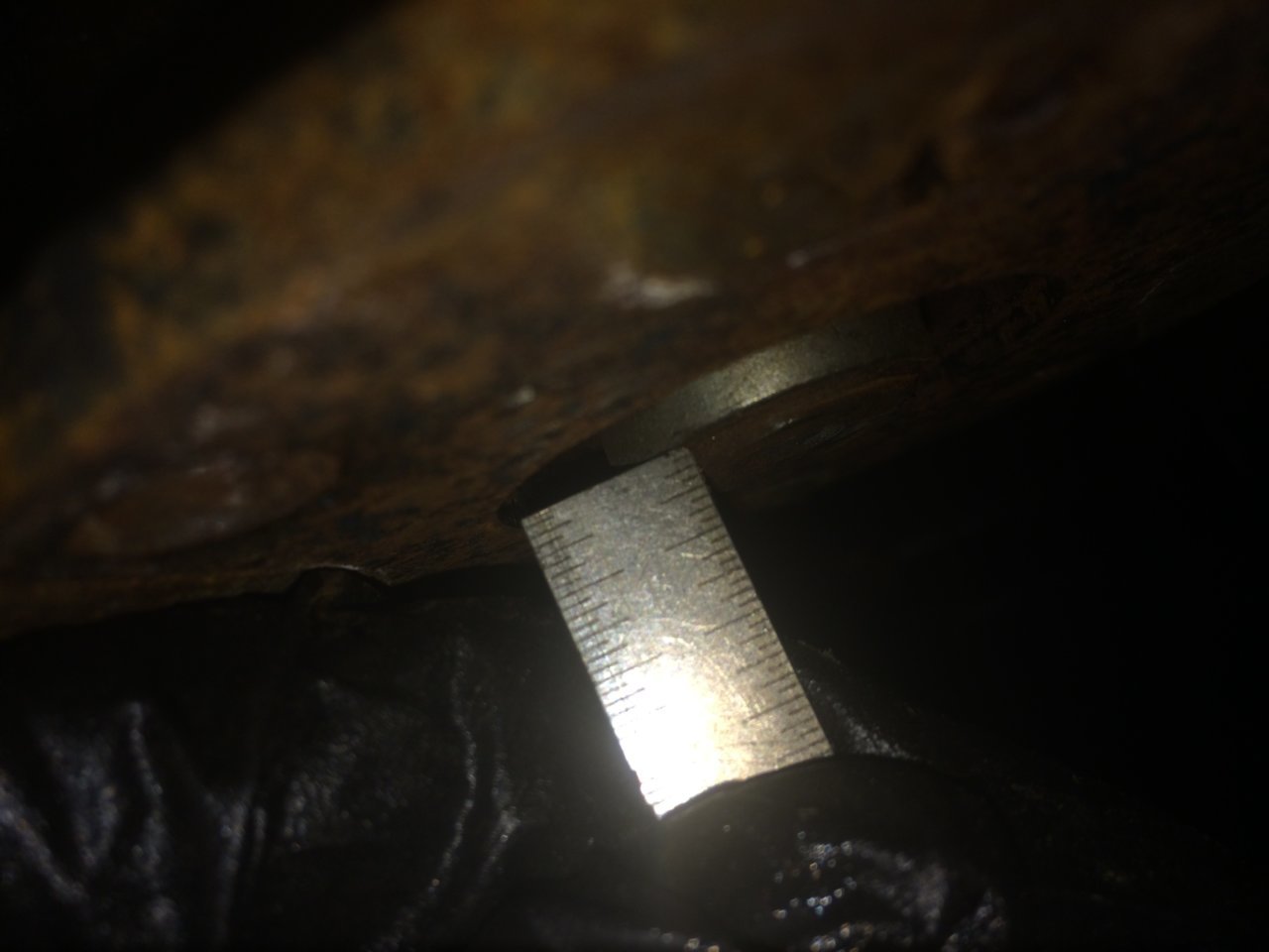

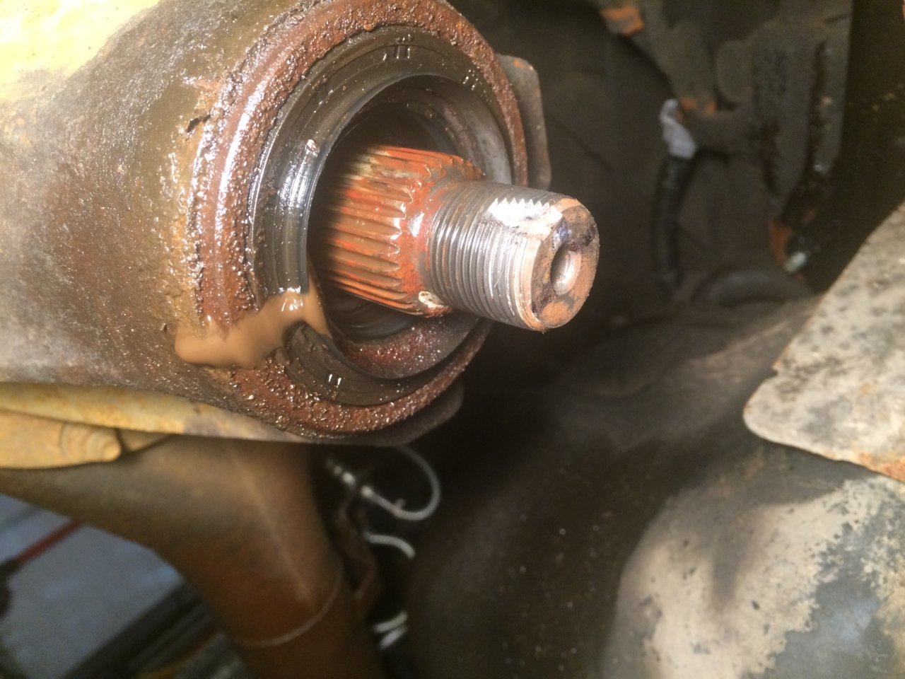

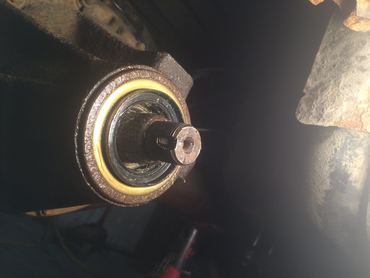

    I marked the nut in relation to the pinion shaft so i could count the number of rotations it took to remove, mine was at 12 rotations. I also measured the tread that is sticking past the nut.
    The previous owner has taken this apart before as the nut has a lip on it that is meant to be staked into the slot in the pinion to remove this i used a chisel and a flattop screwdriver. This nut has a part broken out of it and i will need to order a new one
    The pinion nut is a 30mm
    I took the truck off the jack stands and put the parking brake on and blocked the wheels. With a bit of effort i got the nut turning to back it off. REMEMBER count the number of times you rotate it as it will need to go back the same.
    Jack up and place on jack stands AGAIN :(
    Make sure you have the flange marked and a proper way to reinstall the nut to the same location

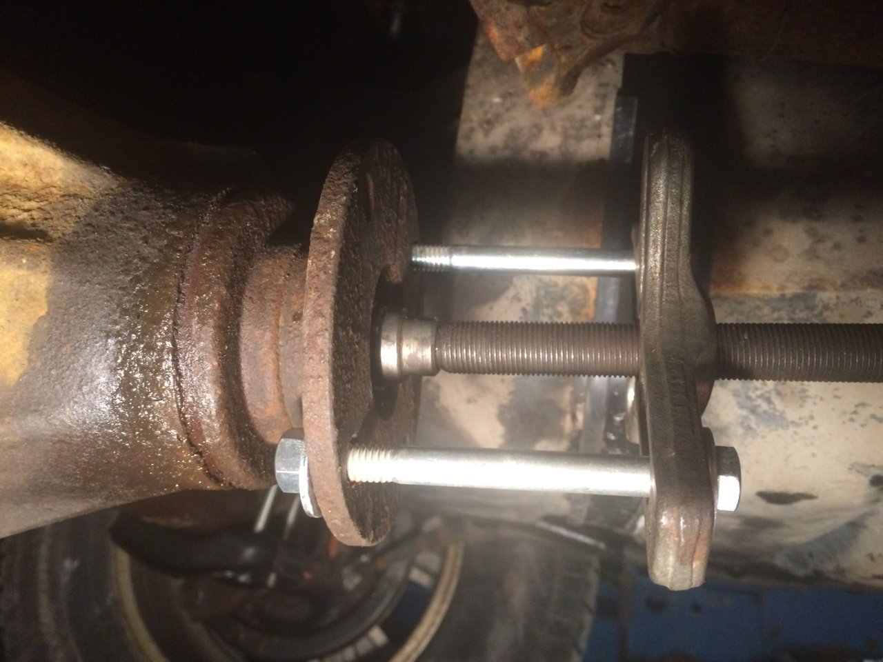

    I then used a harmonic balance puller to pull the flange from the pinion shaft, Inspect the flange shoulder that the seal rides on and remove any burrs.
    once shaft is off a selection of pry bars and screwdrivers were used to remove the old seal

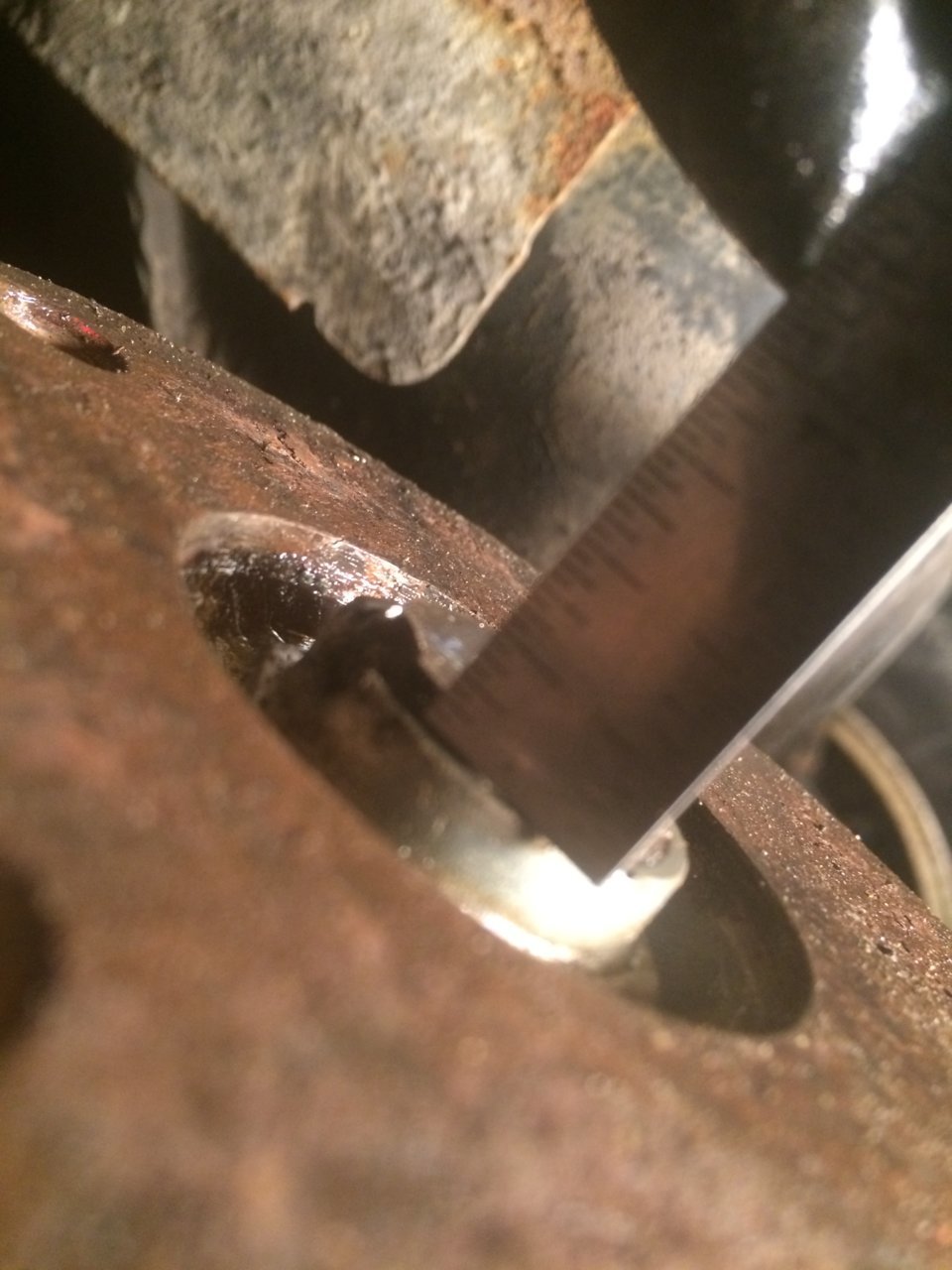

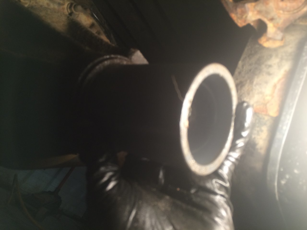

    I cleaned up the area with brake parts cleaner and wiped it out. I applied hard grease to the outside of the seal housing to ease with instillation. I found that a electrical conduit joiner fit the seal perfectly, i used this to drive it in straight and flush. Applied more hard grease to the rubber part of the seal so the lip that contacts the flange would not be dry, I also applied on the splines of the pinion. I did this for ease of insulation & removal, once lined up with the correct marks i tapped the flange in a circular motion driving it back down. Reinstalling the nut counting the turns it requires to get it back to where it was originally, measure and once satisfied it is in the same location re stake the nut to prevent it from backing off. Reinstall the drive shaft.
