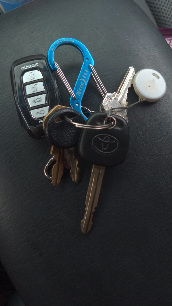

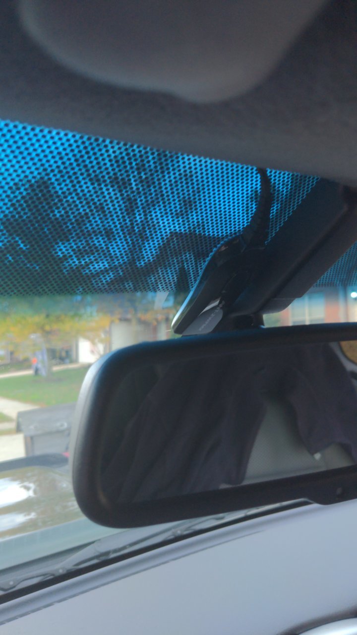

    I just finished installing my Accessorides remote car starter with two-way controls. It was definitely plug and Play I watched the install video the whole time and it was simple. The only trouble I had was finding the 16-bit plug it had a black cap on it and I was looking for a white connector .
    I was able to tuck away the antenna through the side column and I put it right next to the rear view mirror it's pretty seamless and you don't see any wires. There was no video on how to do it probably because of the airbag that's in the side column. Overall I'm happy and ready for winter, it gets cold in Ohio.

    2-way remote is slightly thicker than the 1-way remote, but comparable to the OEM. See photos. The blue light and audible feedback from the 2-way remote is great!

    Mounted the long range antenna in the upper left corner of the windshield. Others have mounted it in the A-pillar or behind the rearview mirror.
