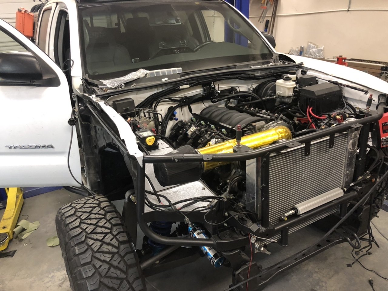

    LS Swap with RSG Tranzilla, Custom hi clearance front bumper, Relentless: Slider's, bed rails, rear bumper, Prinsu with 40" BD s8. Dirt Designs 3.5 LT. Archive Garage rear towers/shackle flip/SUA. King Air bumps. King LT Coilovers in front. King 12x2.5 in rear. ARB rear air locker and twin compressor. SCS f5's with 33" Ridge Grapplers. 20" S8 mounted in bumper, squadron sport fog lights, squadron pro backup lights, LP6's bumper mounted.
    LS3. cost alot to get a 6.2 aluminum block to keep the weight down and also kept it a manual which made the cost prohibitive for alot. overall the swap wasn't bad just had alot of trial and error parts and configurations.

    Northwest Indiana/Chicagoland
    Impressive. I respect the LS engines. But they hate me! Viable option if someone is looking for power on the cheap (vs Toyota options)
