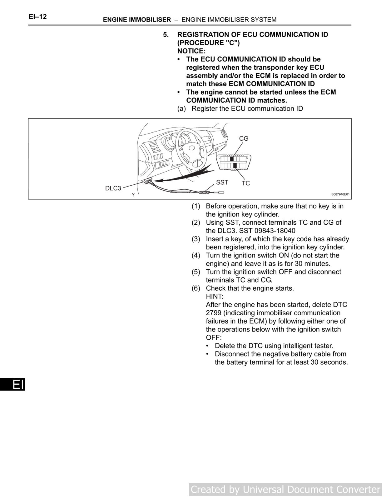

    Do note you will need to do the Immobilizer handshake and write the VIN to it (changing the VIN isn't necessary for it to run but it should be done), you will likely have to re-licence HP Tuners since I believe the licence is tied to the VIN and calibration numbers (M/T has a different calibration number than A/T).

    Immobilizer reset is just 30 min with a jumper wire.
    He would probably need to make you a different tune file since manual and auto calibrations are different but I'm sure he would work with you there.
