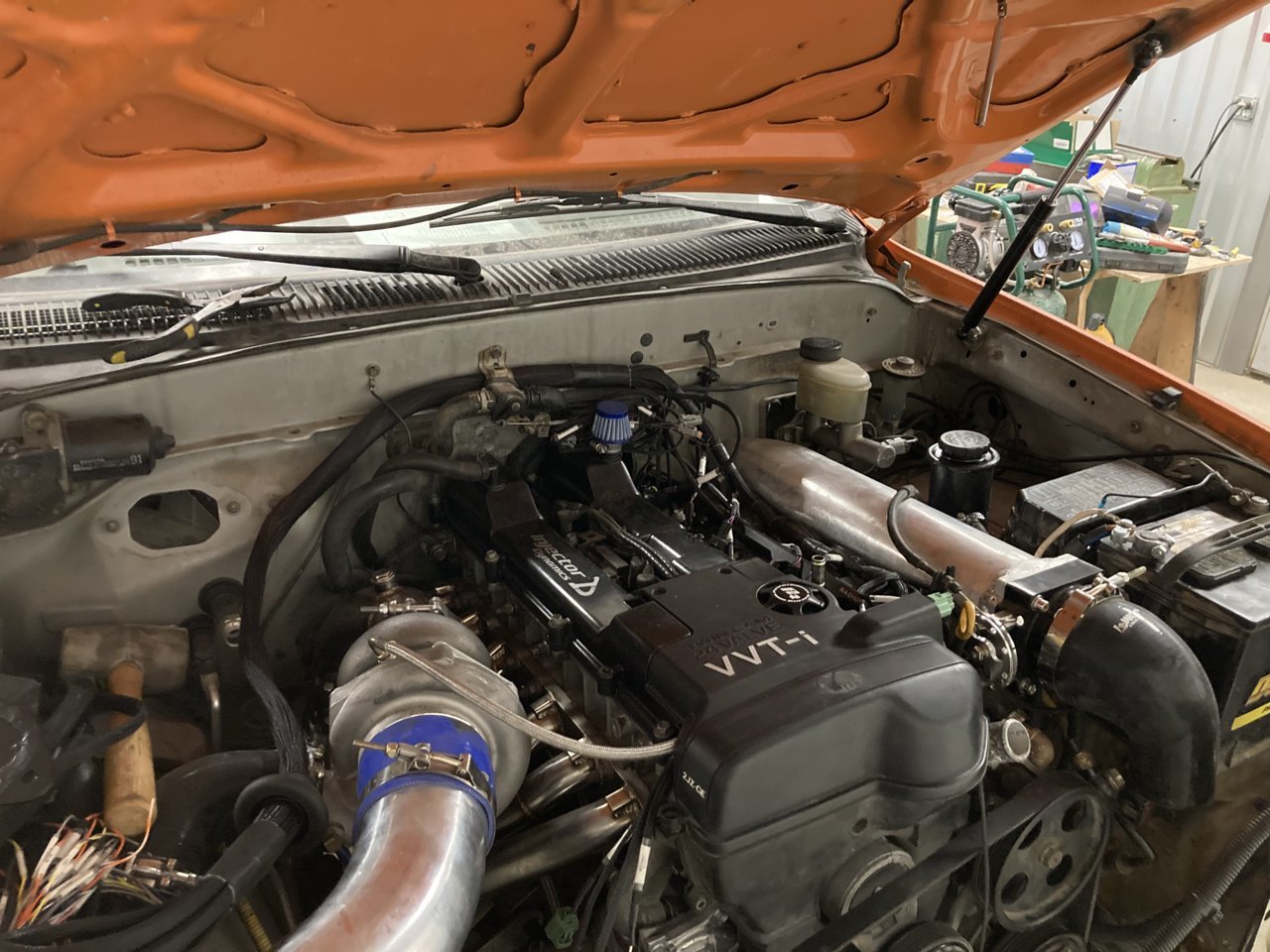

    Thank you man. That was my first real big project but it was way over my head at the time years ago. Ended up selling it and the buyer drove it the near 200 miles home without issue. That had to be more exciting to me than anything else haha.
    You can also look at Willwood or other brake companies that sell master cylinders designed to be used without boosters. Those may be a smaller bore to give you more PSI but with more stroke maybe? Surely someone else will have more or better info than me on that... Just tossing a couple options out there that may make it easier/better given the case.
    I wouldn't believe a new pump would be totally necessary for a hydro boost unit. Isn't like they suck a ton of juice or anything for the small piston movement. Pressure is one thing and volume is another. Just kind of depends on the system you're running. Probably wasn't necessary for me to change the pump, but I did anyways as I found a good deal on one. Also, on the Lexus pump I had, the pump had a solenoid that controlled the flow which I didn't want to deal with.

    Well after looking at the picture, I'm almost positive that'll fix my issue. Plus I got buddies with tons of parts Chevys. I'm sure I can find one for free!

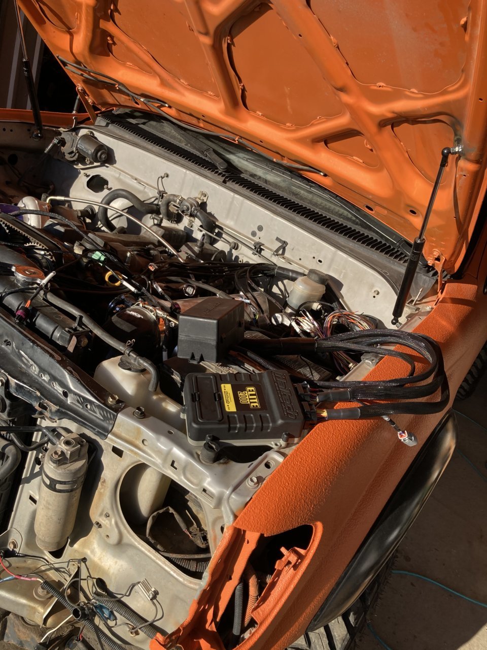

    I just pulled out my old wire harness. I have a stand alone harness and computer coming from Haltec. Tell me what you think about it. I personally love it. But I will try to find vvti gte valve covers later onupload_2021-5-14_21-16-55.jpgupload_2021-5-14_21-16-55.jpgupload_2021-5-14_21-16-55.jpg

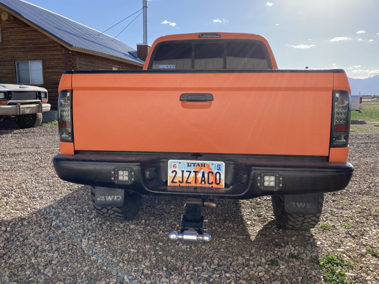

    I just got my license plates in the mail today. I freakin love them. upload_2021-5-18_21-20-35.jpg
    My Haltec EMU and stand alone wiring harness got here today. It’s getting really close to being done.

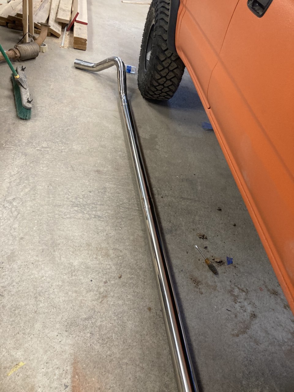

    It’s looks sweet. I am waiting on a few more parts for my truck. But she is all but done. I got a 3” stainless steel exhaust for it. I will run a ultra quiet muffler with a electric y pipe cut out. upload_2021-5-26_22-1-41.jpg

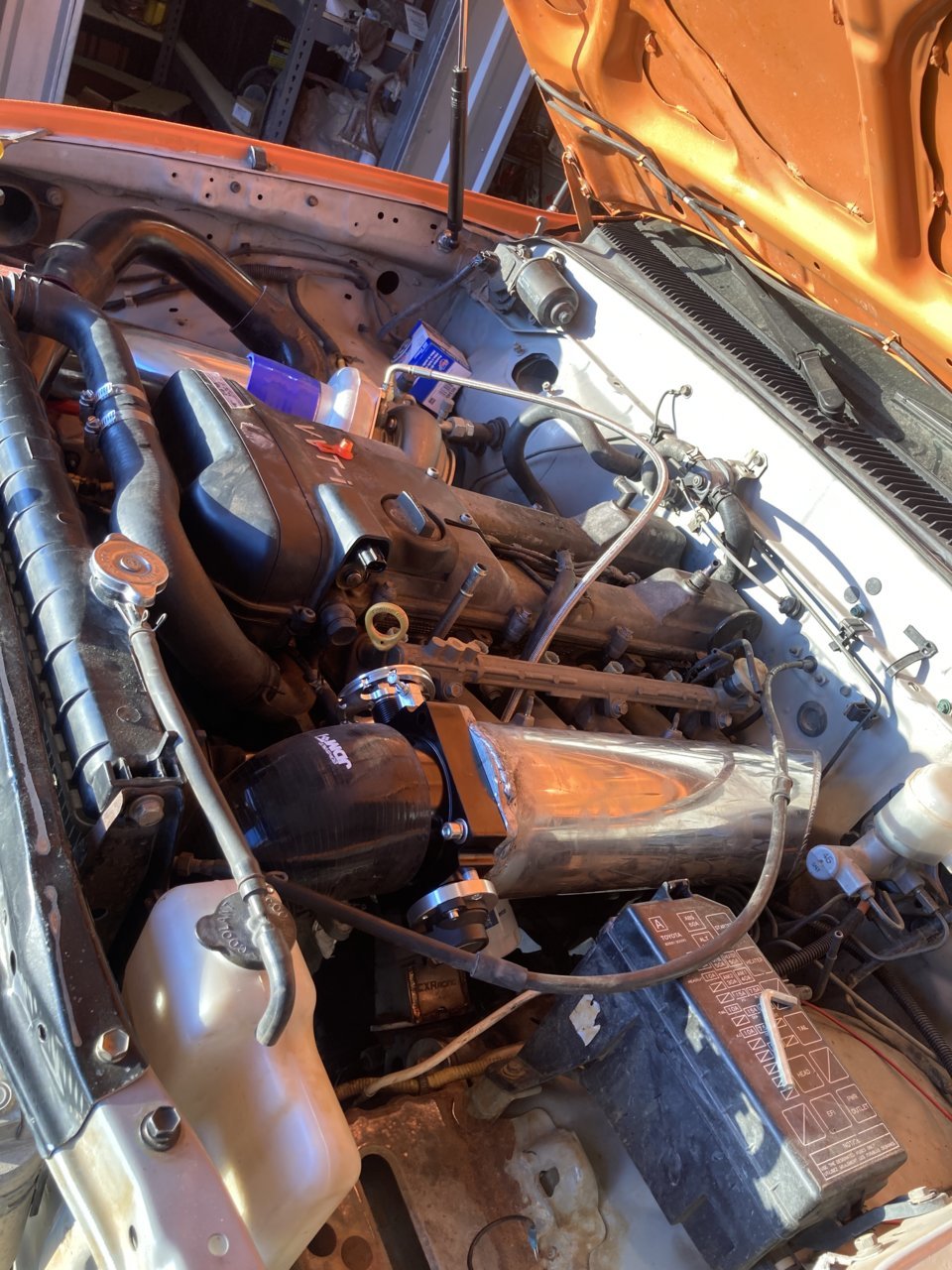

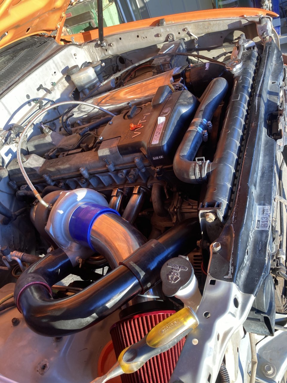

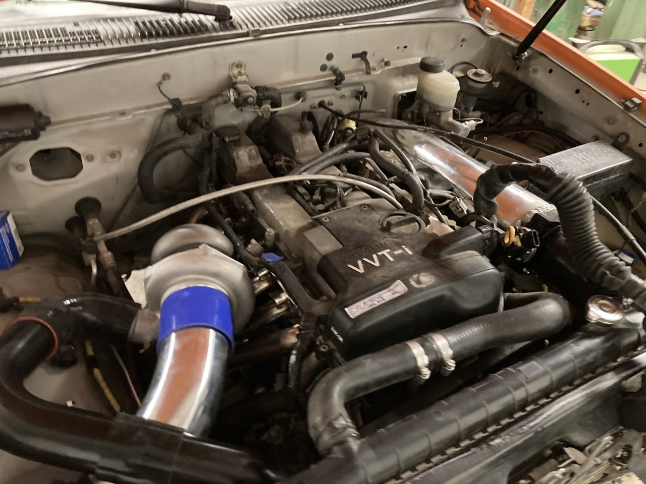

    I am just giving you all a update on my build. I have almost every now to finish it. I will make a list of everything when I am done and cost of the swap. Thanks for all that are watching this build. upload_2021-6-5_21-1-53.jpg
    I just put head studs in. A new timing belt. I have all the new fueling from Radium. I will try to have most of it installed soon. I am putting a high flow pump in the tank. I have Haltec Elite 2000 stand alone computer and harness. It’s almost just a matter of putting it together. My tuner is headed of to Rocky Mountain race week this weekend. So hopefully when he is back I will have it ready. You should check his 4Runner out on YouTube. His buddy has s channel there @ Hook937. He has a couple videos there. And he should have more in a week or so. My goal is to have it running in about 3 weeks at the most.

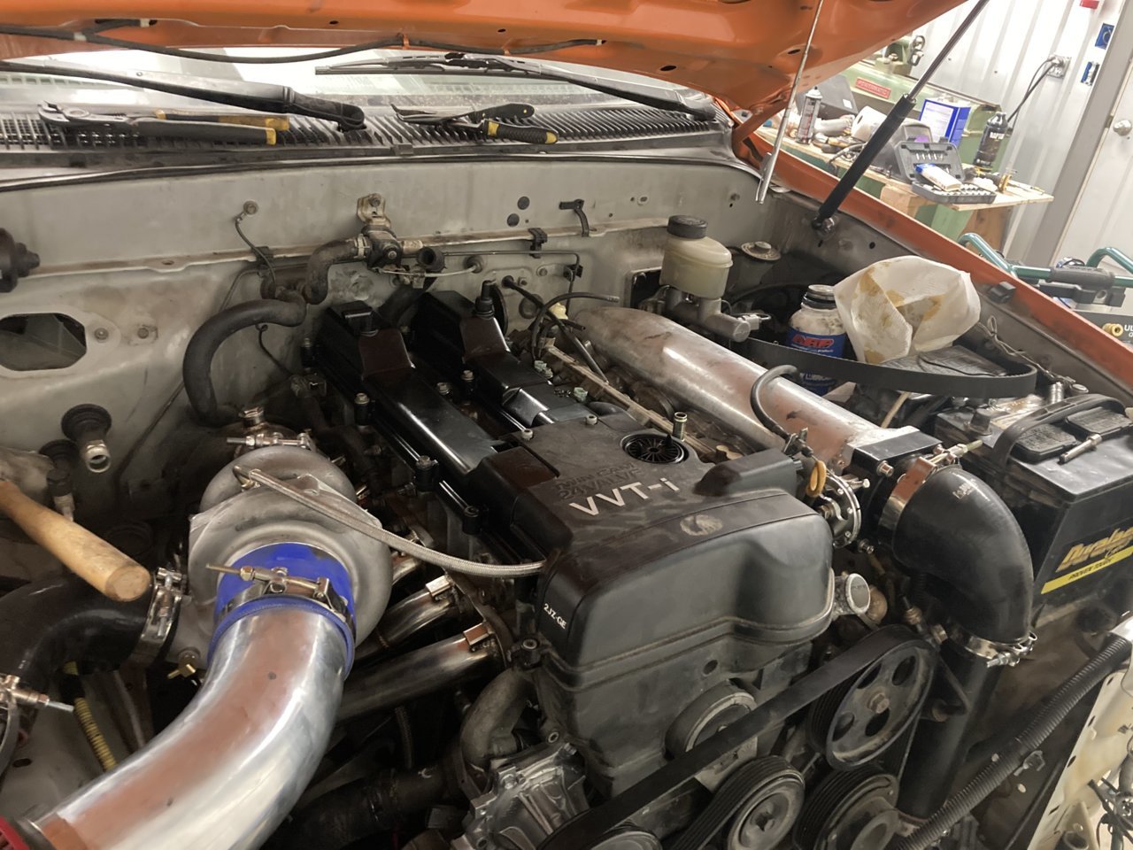

    It’s looking so good. upload_2021-6-8_20-18-59.jpgupload_2021-6-8_20-18-59.jpgupload_2021-6-8_20-18-59.jpg
    I started this Swap with no knowledge what the hell I was getting into. I just hit 10 grand into the swap. I was thinking before I could have it in and drive with about 5 grand. I was so wrong. But I will be pretty happy with it.

    5k?? Maybe if you chose a SR20. No way with a 2J. Looks good though.
