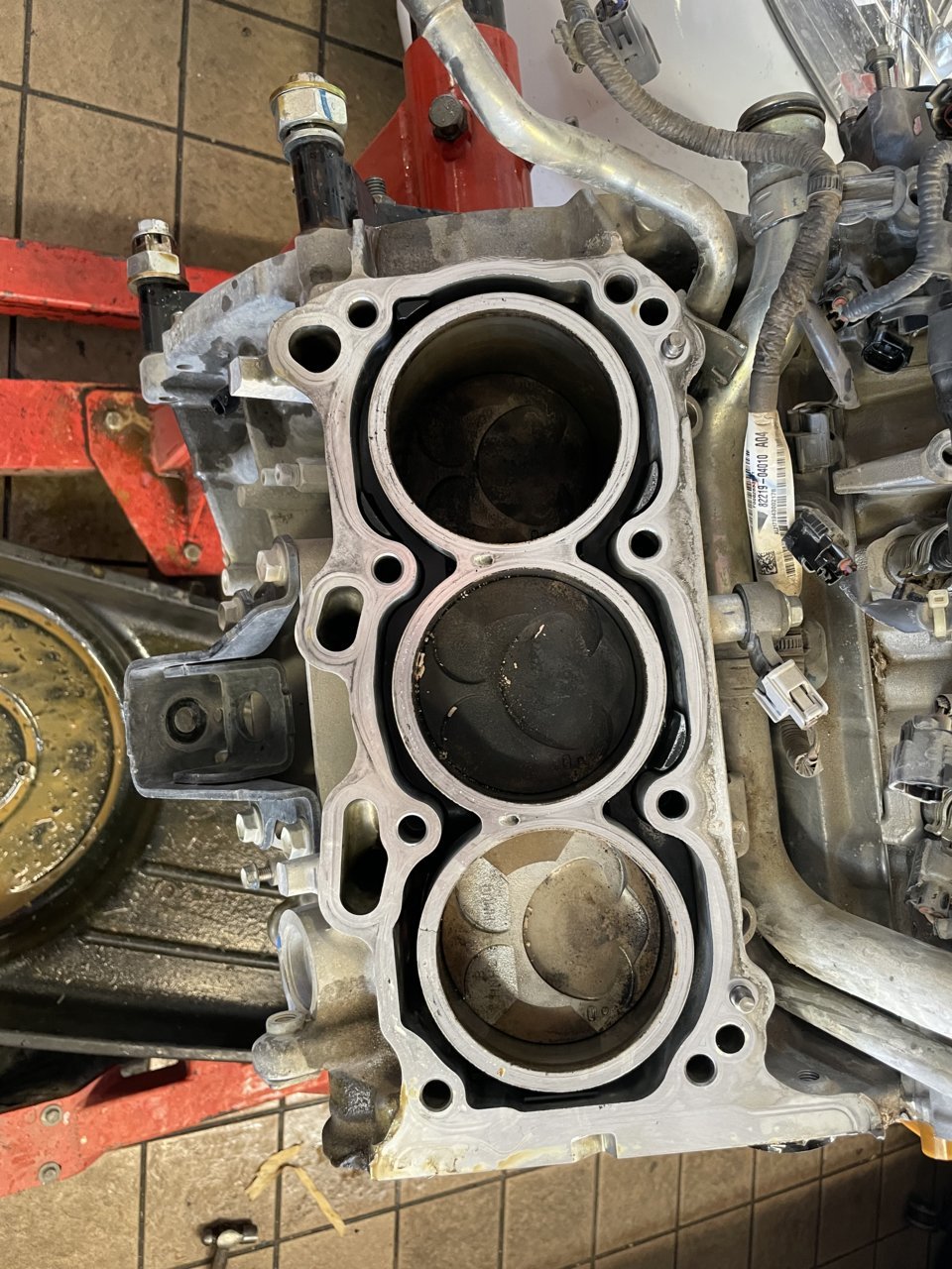

    2020 SRV6 4x4 White
    1st owner
    65000 miles
    Failed head gasket and cracked block
    What happened:
    Mid June 2022 Driving down highway at 65 mph lol normal, heard a lil pop sound, then check engine light came on and ran like crap all the sudden. Temp gage was in the middle as normal. Pulled over within a few hundred feet and saw coolant over flowing and vapor coming from tail pipe while motor off..
    Maintenance:
    Oil change and service inspection every 5k miles
    Usage:
    -Light off roading (dirt roads, a few beach trips)
    -Some towing but within tow rating and only about 100 miles per year towing
    Mods:
    Almost all stock
    K&N air filter
    265/75R16 BFG KO2
    FJ Wheels
    Cell phone booster
    Coverage/Status:
    -Outside of factory powertrain warrant so not covered there. Had MPP extended warranty and they covered it, but they’re putting in salvage mystery motor (55k miles on motor from truck that was totaled in rear end collision).
    -Still in shop getting new motor and fuel pump recall repairs.
