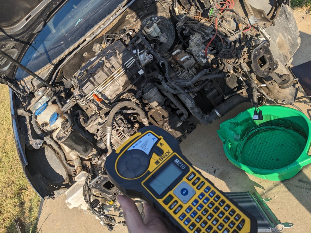

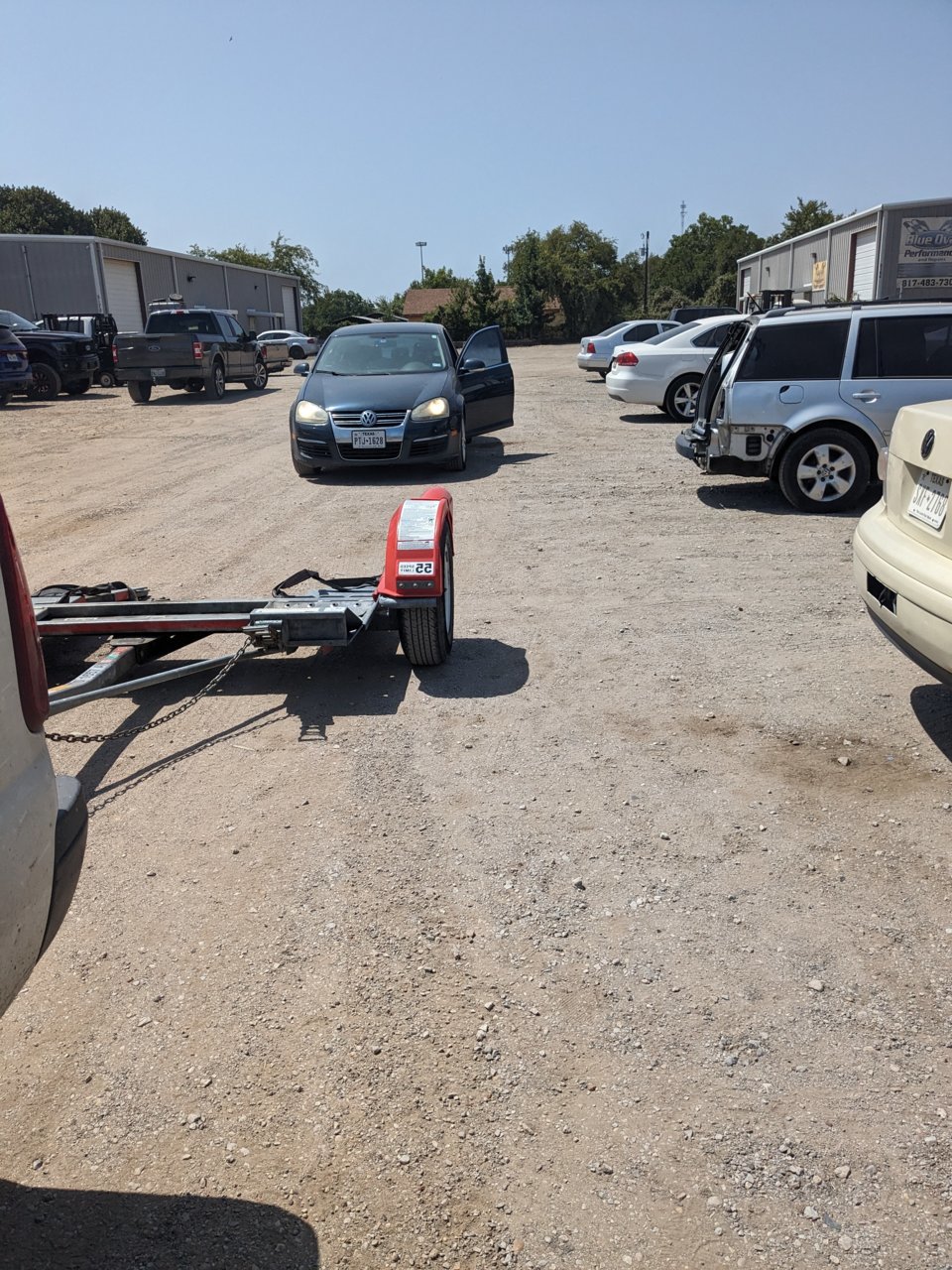

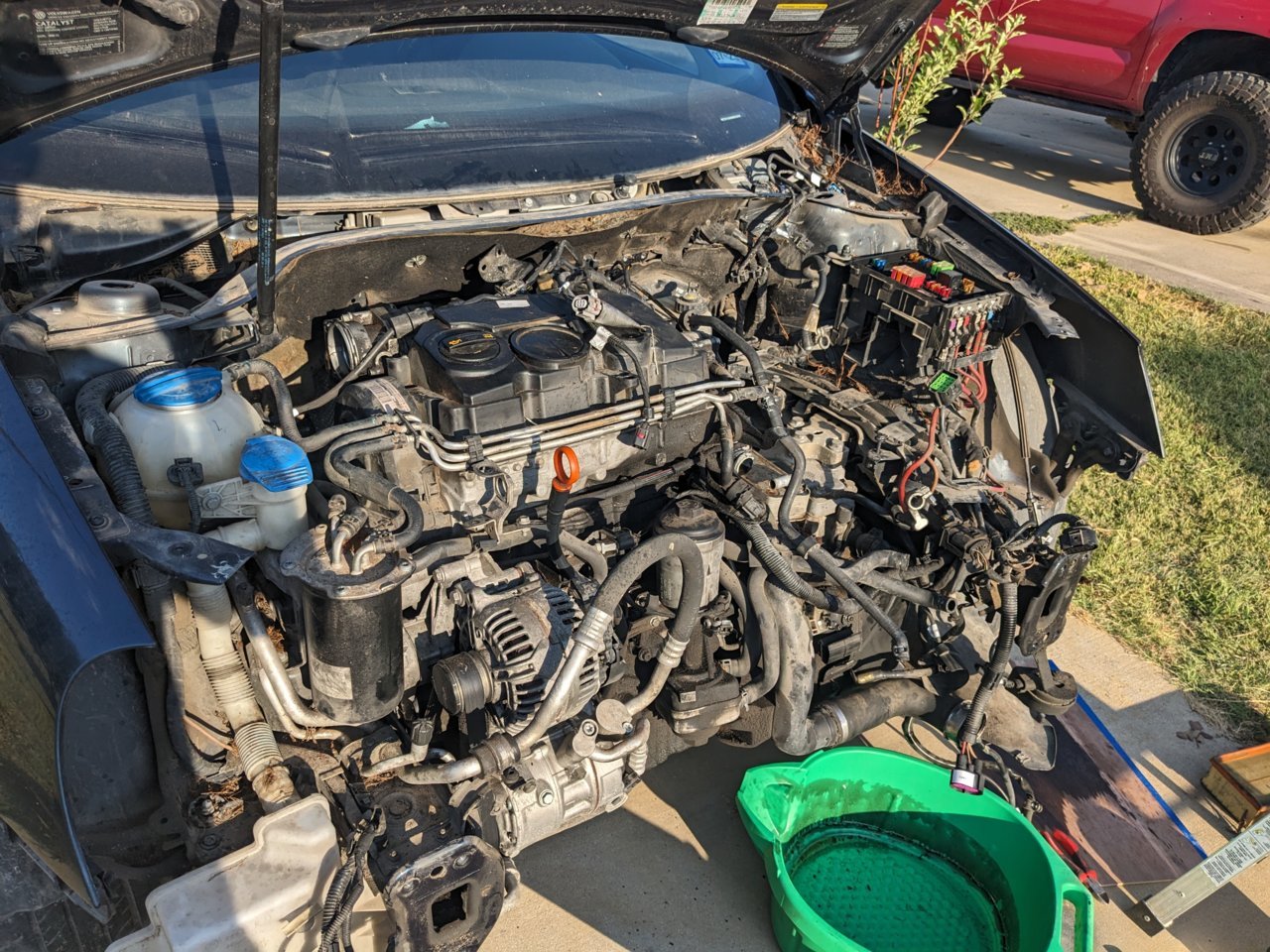

    So today I started the process, of swapping in a Volkswagen turbo diesel into my 08 Tacoma.PXL_20230727_164731389.jpg PXL_20230728_012347586.jpgI was able to find a 06 Jetta with 166000 miles on the odometer, which is nothing to these engines.
    Step two.
    do not sleep on the wife's lable maker!
    PXL_20230728_234530943.jpgI don't really know what I'm doing, so I figure it best I lable everything clearly.PXL_20230728_234558037.jpg
    It's to damn hot. Going to get the transmission separated. And hopefully get the motor on an engine stand tomorrow so I can start working in the garage.
