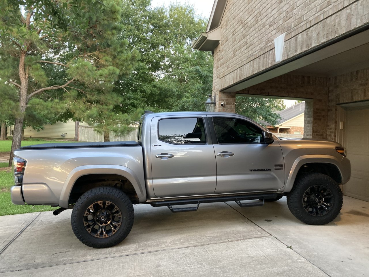

    That looks good. Tomorrow I get a 3/2 lift with 265/70r18s on 18x9 rims with-13mm offset (equivalent to 1.7” spacers). I’ll post pics when done.

    Here are the pics. The “before “ pic is in there for comparison.

    Her’s another one.

    No rubbing when driving normally (even in full lock-both directions). The front right tire rubs momentarily if I pull (turning right) into my driveway hard and fast.

    Man looks good look mean.. ridge grapplers? So what are you rubbing?

    #360069
    9
    Stan
    Humble, TX
    2020 Tacoma limited 4wd
    I’m pretty sure it’s the front fender well. I’m thinking of doing a viper cut to create some room. Again, it only happens when I pull into my driveway to fast. Never does it any other time
