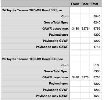

    EDITED 12/16/23 with new curb info from C&D Test of '24 TRD-OR Auto:
    First time I saw a clear curb figure, in this case of 4794 lb for TRD-OR, DCSB, Auto.
    Source: https://www.caranddriver.com/news/a46148551/2024-toyota-tacoma-vs-old-test-results-compared/
    Here is the information I was able to discover in the published owners manual:
    Owner manual here: https://www.toyota.com/owners/warranty-owners-manuals/
    Relevant data is on page 613 (payload) and 665 (GAWR/GVWR)
    Curb data is from C&D article above for the Auto, estimated for MT
    While I aim at staying within GVWR (and missed by a mile in my 3rd gen), the much higher GAWR is very good news for me (I am especially overloaded now in front with bumper/skids/winch/long-ranger tank).
    A few thoughts:
    - EDITED - payload now seems to be ~1450 lb. Getting closer to the magical 1700 lb
    - Front axle GAWR is 540 higher than Gen 3....maybe to support the heavier iForceMax drivetrain
    - Rear GAWR is practically same as Gen 3
    - Payload will be reduced by options....my 3rd gen also had close to 1200 lb payload "spec" but in practice, after options, 990 lb.

    is that curb weight calculated? I dont see that published anywhere in the pdf. Its funny, i cant seem to find that spec anywhere (like the exact weight of TRD OR DC 4x4 for example), only some vague range on google. Feels like Toyota doesnt want people to see that number, likely because the hundreds of extra pounds this thing packed on aint gonna look good with the modest bump in power.

    Sorry for lack of clarity:
    - Your are right, the curb was calculated from GVWR and payload.
    - I am sure the curb will be higher than the number above with added options (meaning payload will go down)
    - And, the second set of numbers in the table are for the manual transmission, the first for auto.
    I am hoping (but not holding my breath) that the Trailhunter will have higher payload, as this stated so by many reviewers - 1700 lb was mentioned in the spring. But I am totally ready to be disappointed.

    Am I reading the Owner's Manual Correct? Looks like a TRD-Offroad (Double-Cab, 4WD Long or Short Bed) will have somewhere between a 1200-1270# payload?

    Edit: that table can't be correct. Curb Weight on the TRD OR is 4700, not 5000+

    You are right - Corrected above - I calculated the curb from GVWR less Payload - no curb figures I could find in the manual. I substituted now in the table the curb numbers from C&D test drive.
