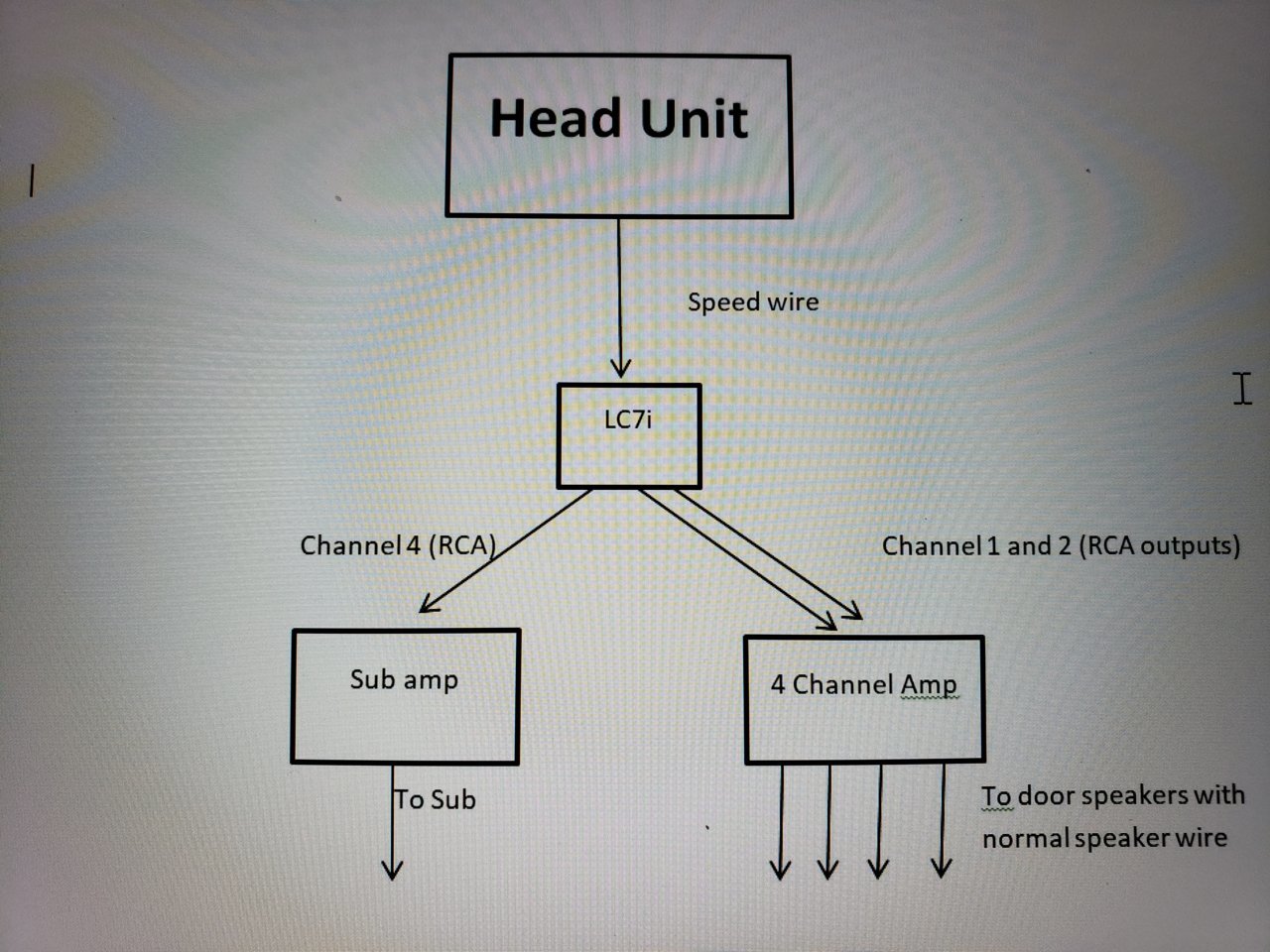

    This is how I wired mine. But I will remind you, I did a full component setup in the fronts with a crossover for the mids and tweets.

    Ok and you guys confused me when you said mids and tweets for the front doors so I cant run the factory speakers to the lci7? Why would I need to buy components for the front? Is this something I need to look into more? I'm just wanting to add an amp to the front door speakers that I am upgrading but still using factory harness on them with adapters sent from crutchfield with the door speakers I bought that was listed in the $250 upgrade post on here.
    I'm gathering that I need to process the door speakers to the amp as well but that's what the lci7 does. I understand I'll need rcas for both amps will I be able to do this with just the lci7 outputs or what would be the best way to achieve this while still using all factory wiring.

    Ok so I could essentially just run new speaker wire to the new upgraded speakers straight to the amp and run the lci7 to the amp for output to it. The HU will be supplying it's output to the lci7 which processes it and then sends it and amplifys it then the amp will send it to the speakers as well as to the sub amp and subs.
    I think I get it now. I see.
    I was under the assumption i could keep all factory wiring and still use it and the lci7 would take care of the processing.
    I can keep current tweeters as is right? Just run new speaker wire to door speakers to amp only? I'm just trying to keep from ordering anything additional that I wouldn't need to. I'd hate to have to find a buyer for these already purchased 6x9s and tweets. But if I'm going to have to I suppose I will.
    I guess I'll just leave factory plugs hanging in door un used correct?
    Thanks for the diagram as well! Was very helpful for me understanding it though!

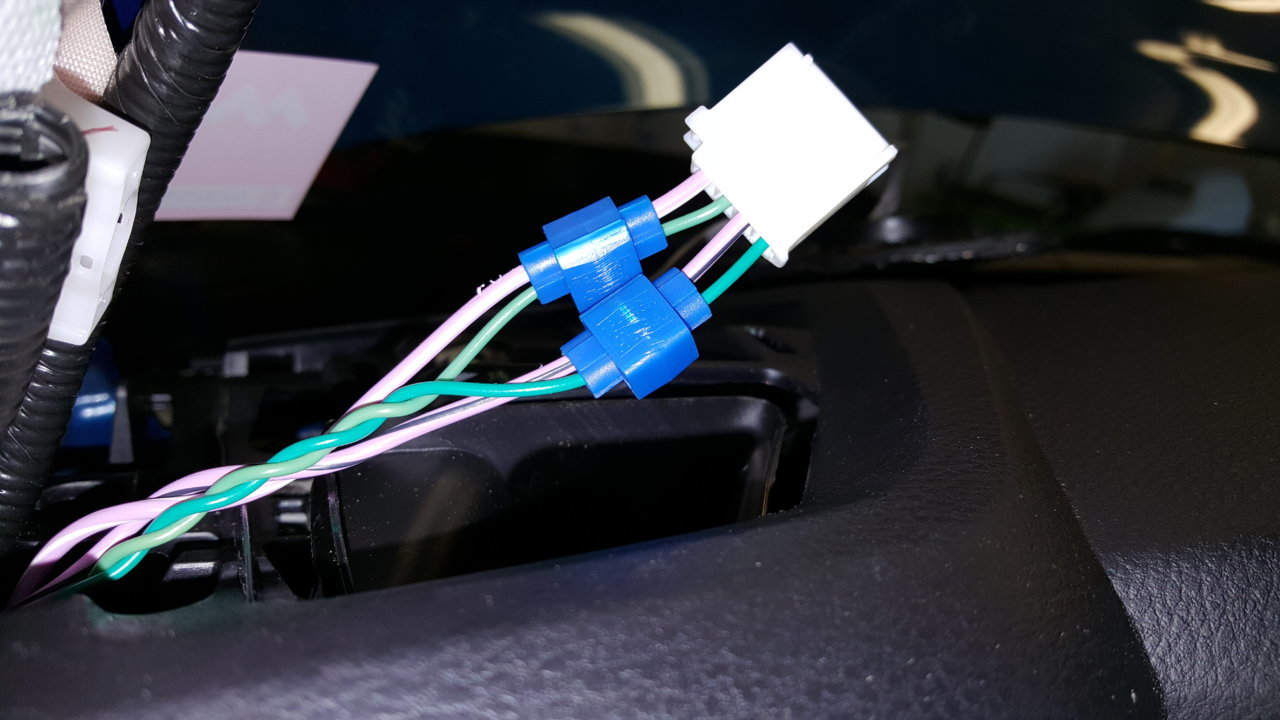

    No you can't. The head unit runs to the tweeter first then to the door speaker. I'm telling you, the way you are thinking about this is just too complicated. I tried to do what you are thinking first and the shit didnt work. I have already tried this and wanted time. I really want to help you but I would not tell you to do it this way if I wouldn't or hadn't done it myself. I have more that 70 hours into this audio build.
    This is what the tweeter harness looks like and I tried to splice the input from the deck and the output to the door speaker. Nothing worked doing it that way.
