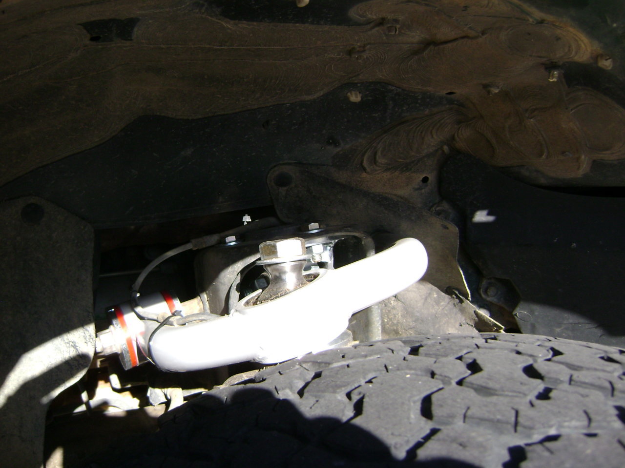

    Those UCAs are on the wrong side and upside down. The uniball should be relatively flat at ride height.

    Thank you. I thought they didn't look right. The installer said they were and he is much more knowledgeable than I. After reading SqueakyP's post I did some reading and found out he is exactly right. When all brands of UCA's are installed the gussets should be on top. Mine are upside down and on the wrong sides of truck. Thanks for pointing it out.
