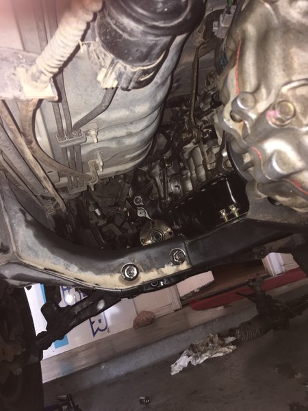

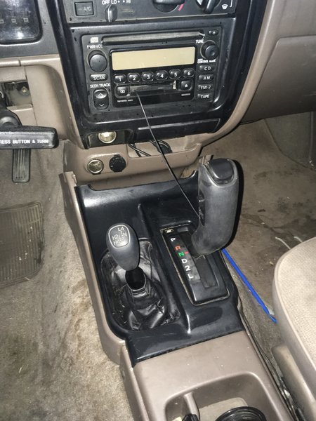

    Well after the first day I'm callin it a night finally, 2wd tranny out... 4wd transmission and t case in. Interior is in for the most part, front driveshaft is the correct length. Today was a good day. Swapping the speedo cable was easy as well just involved opening up the oil pan and accessing from the inside. I'll snag a few pics in the morning!

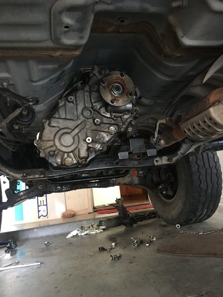

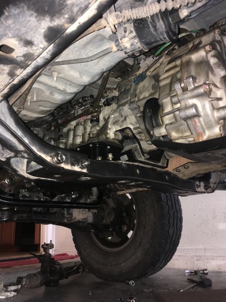

    A few pics from Saturday's progress. Didn't even touch the truck today since I just need to pick up parts so should wrap it up here this week if I get some free time.

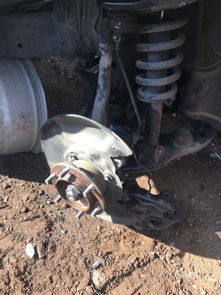

    Today I went back to the yard with the two runners and pulled the entire front drive assembly and a steering rack. I only took a picture of the 2000 4Runner I was pulling parts off today. I almost just felt like I should buy the whole thing and build it but another bites the dust I guess.

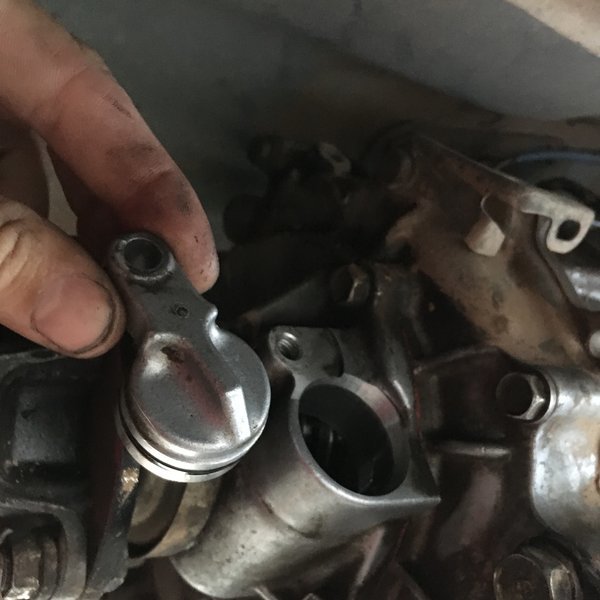

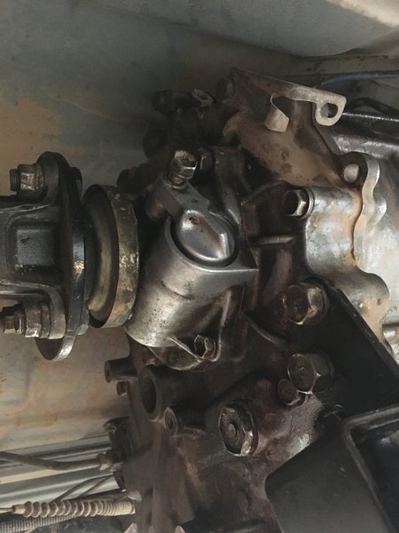

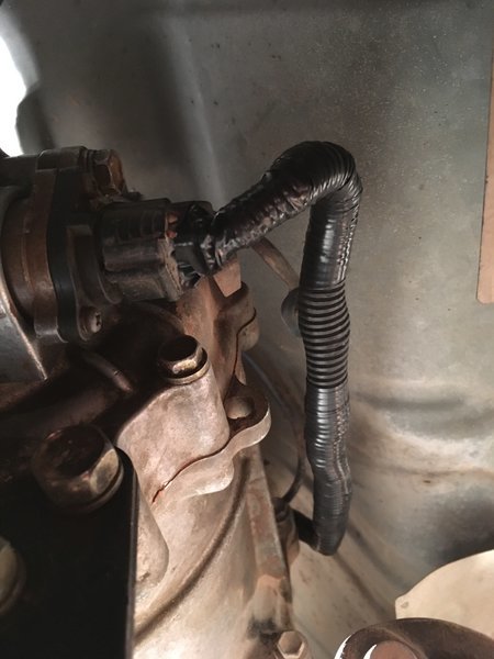

    First two pictures are of the plug that's in 4Runner 340f transmission and transfer case. Because I did this conversion on a Tacoma I need a Tacoma speed sensor in order to get an odometer reading and display speedo.

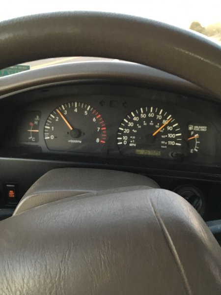

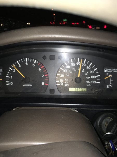

    This last picture is when I finished wiring up the VSS and put some loom on it and wrapped it up nice.
    That's what I call success! No CEL, no issue mobbing down the freeway with the 4wd system installed.
    After an alignment we're good to go. Still cruising 80 at 2500 rpm!

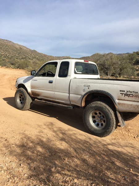

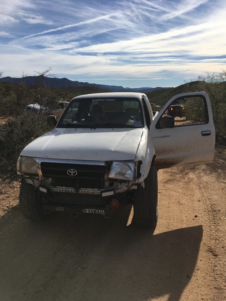

    Here is what my truck looks like, these pictures are from last Sunday. I decided to meet up with the AZ 4x4 group and check out the trail to Crown king. I will be starting a build thread soon, I'm going to Exo my cab so as soon as I get my 1.75" 0.120 wall DOM in.
