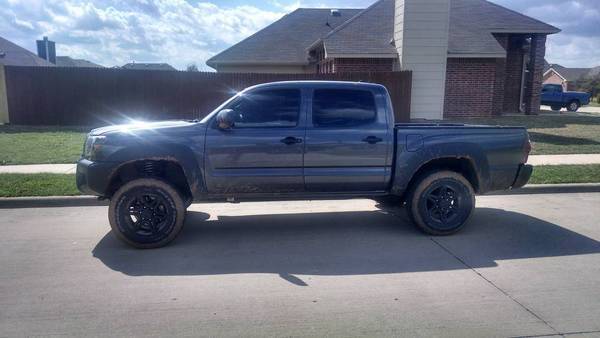

    This is 5100 at .85 and eibach coils stock in the rear but gives you idea up front its 2.5" of lift and on 275/70/17 tires rides amazing and was a fraction of the price of adjustable coil overs and will serve me just fine for my needs.

    The front looks good, the back now seems a little lower. I would want to level this off but keep the ride quality equal or better. What would I need in the rear to level the truck to match the front?
