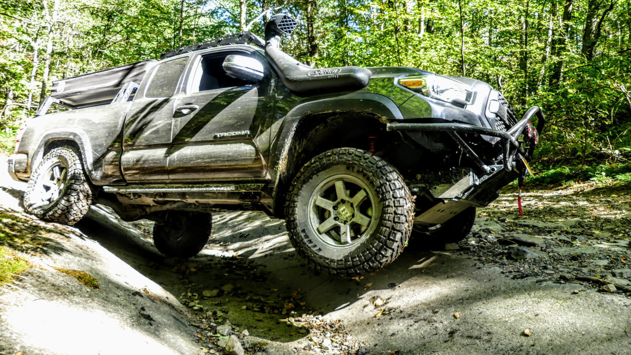

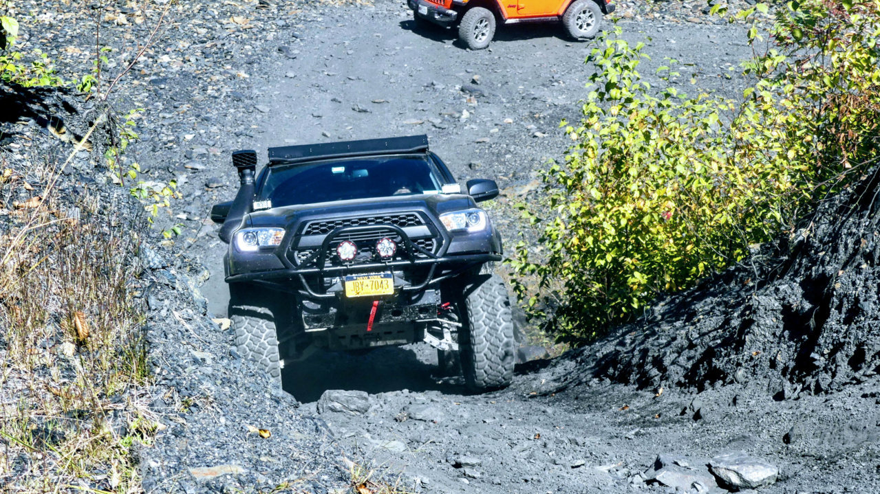

    Don’t over look Toyotech 2” boss aluma, mid range in cost, adjustable if you ever want to go up. Have a set of the 2.5” on my 17 TRD or. Beat the shit outta that truck for 2 years since build and they preform well. The only need for reservoir is for fast whoopdy’s. If you mild to none off roading king is overkill and not a needed expense. OME dakars squeak, I couldn’t deal with that so I paid for deavers. I run total chaos control arms upper and lower, heim joints. Again, I abuse my truck. My limited will not see off road, I will still go with the toyotech in front and deaver in the rear, about 2”, pulls a small trailer, probably do the Total chaos uppers.
    As has been said by many, what are your plans for the truck

    Pinion...thanks for the intel. I have a 2019 Limited. I don't plan on doing what you show in the pics. I like the lifted look but like the ride quality as well. I want to use good parts and do it right the first time. Price is really not a major issue. But,I don't want to purchase SEMA items for the lift. Any help in the decision is great. I do like the Dobinsons application, and would like a kit like that. I've used Deaver products on past trucks.
