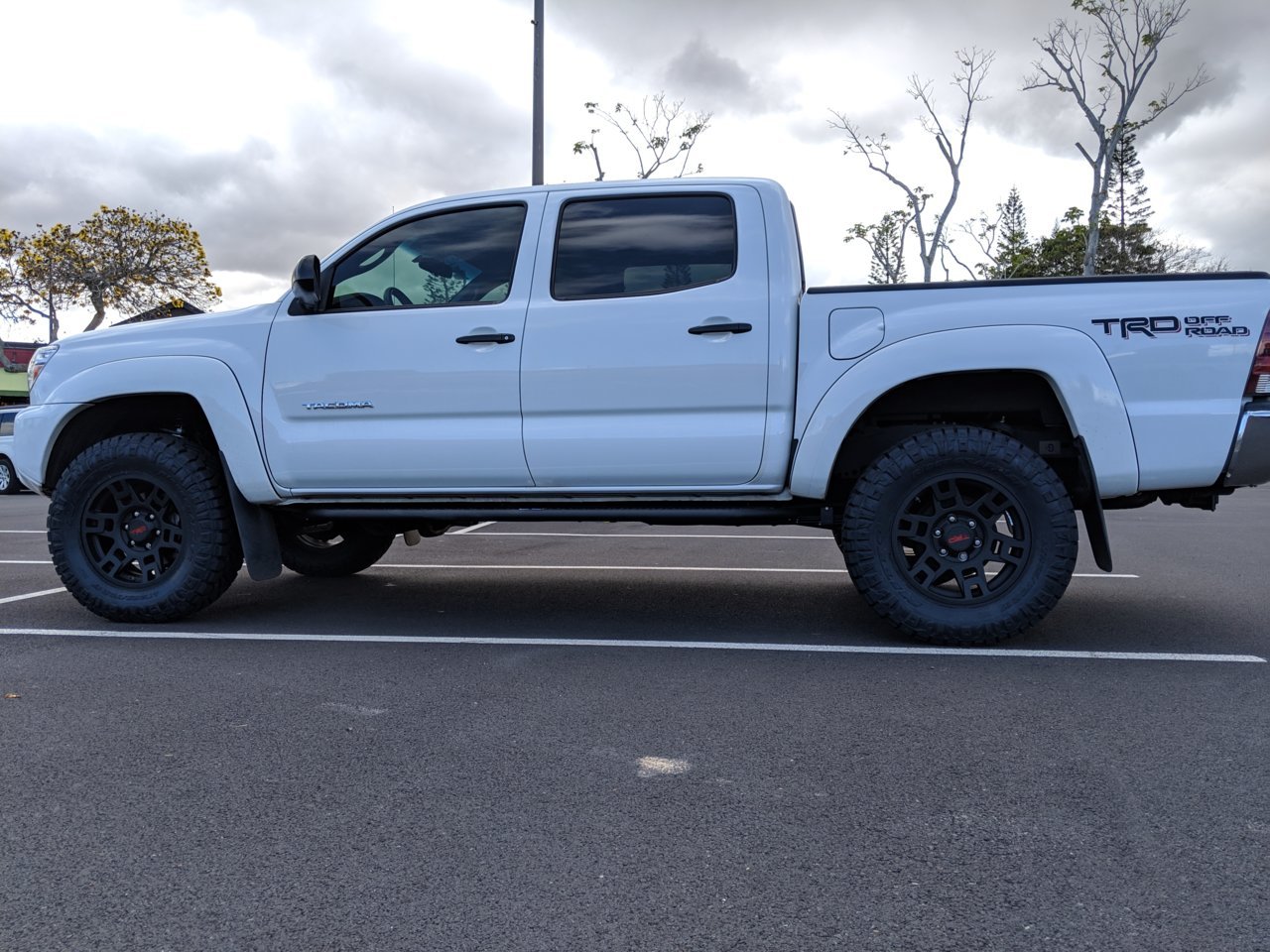

    zert808
    zert808 Well-Known Member
    Jun 2, 2015
    #156560
    109
    D
    Mililani, HI
    2015 White Tacoma OR DCSB 4x4
    OME Lift Kit: Front 90021 shocks with 885 coils. Nitrochargers 60091 shocks in the rear. Medium Duty Dakar leaf pack. 17 in TRD rims wrapped with Nitto Ridge Grapplers in 265/70/17
    OME makes another option. It's non adjustable though. Same set up I have on my truck. I even got some LR UCAs to make alignment easier. Ride quality did improve. You'll be able to do some mild off roading. IMG_20190416_194759.jpg IMG_20190416_152527.jpg
    Romaneo, Robsharp06coma and whatstcp like this.
