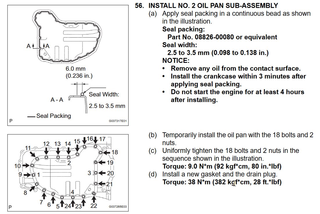

    OP - there are 2 oil pans shown in the diagram you posted?
    The one at the bottom appears to be -> NO. 2 OIL PAN SUB-ASSEMBLY
    Likely the easiest to get to.
    I see -> OIL PAN SUB-ASSEMBLY just above it.
    Looks cut-n-dry to me unless you are going after the upper pan.

    From the Toyota Shop Manual:
    Toyota uses FIPG Sealer ( Form In Place Gasket ) with no other gasket.

    Take note of the seal packing and how it’s applied in the picture above.
    I’d personally just go all the way around the bolt holes.
    I don’t see what it would hurt.
