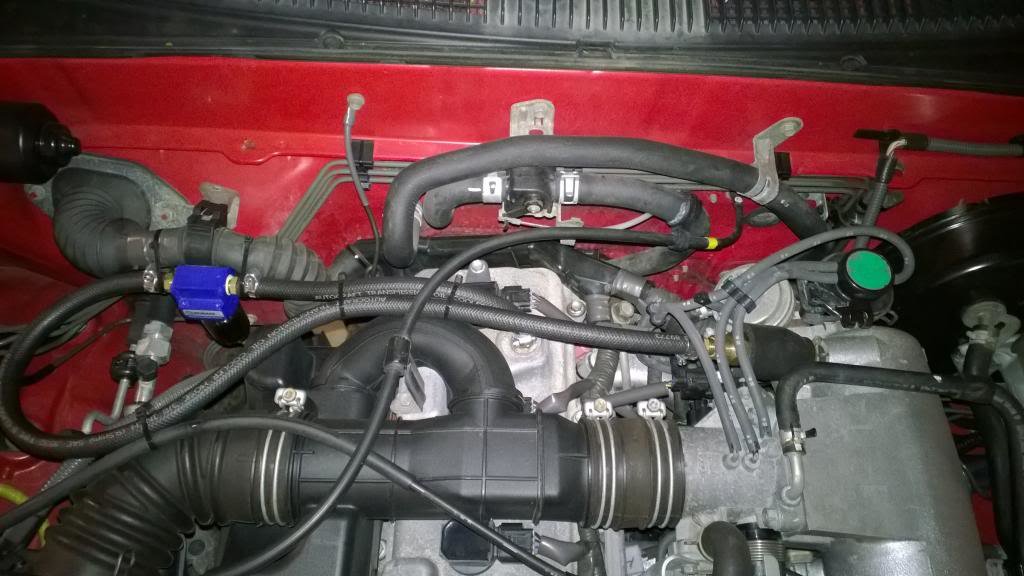

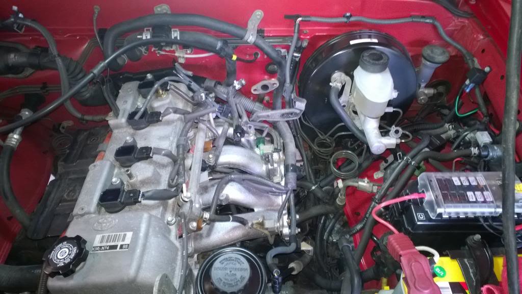

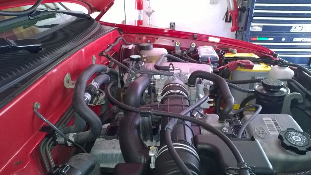

    First thing i did was take a few pics of my connections and vacuum hoses as a "just in case"

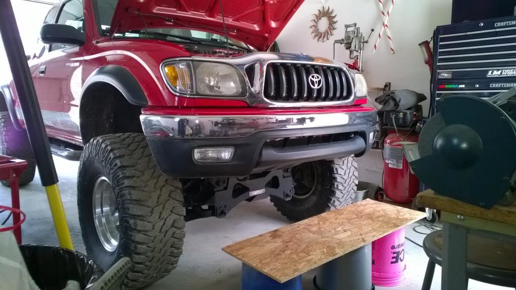

    And some homegrown scaffolding if your lifted:D

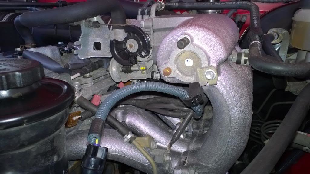

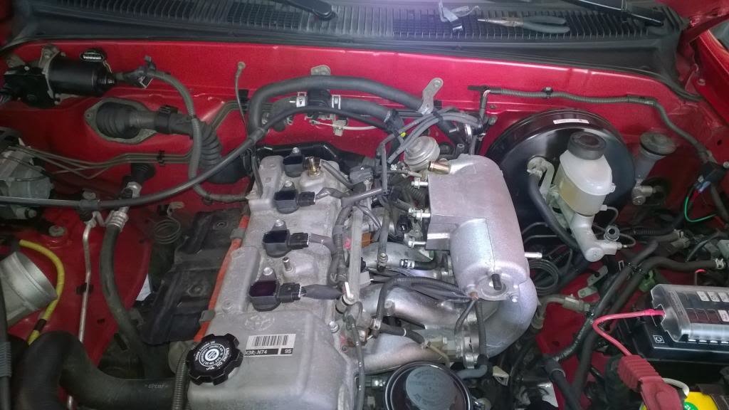

    Next thing i did was pulled the intake tubing and, vacuum lines, sensor connections and throttle body off (remember to take pics of your vacuum lines and sensor connections to help with reassembly as needed)

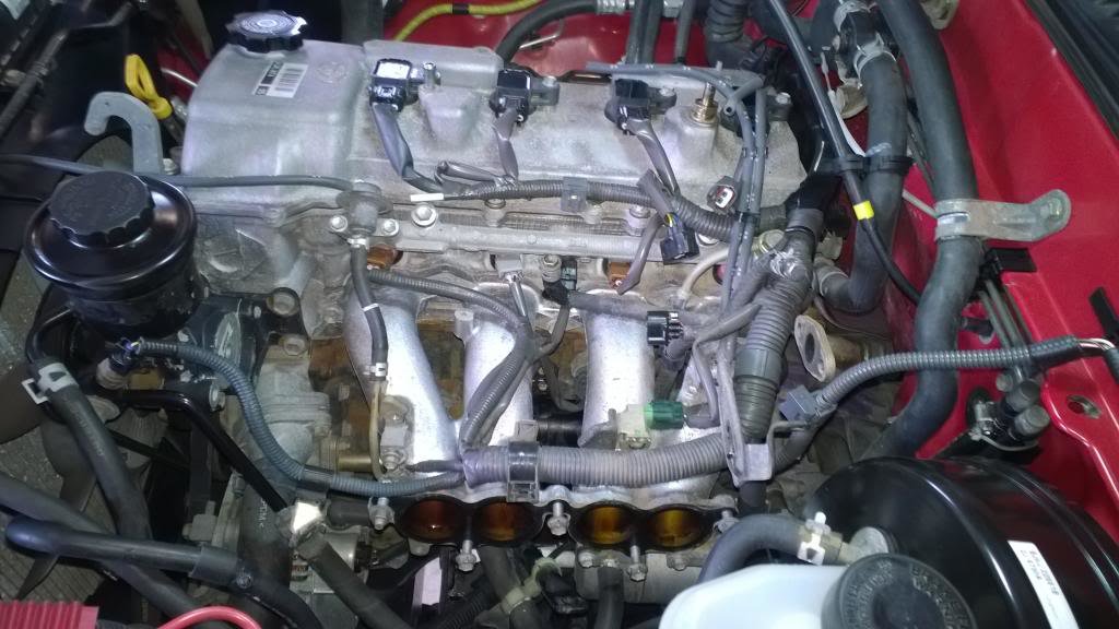

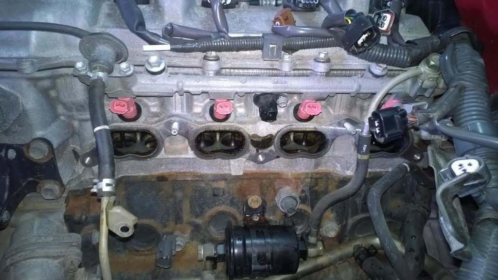

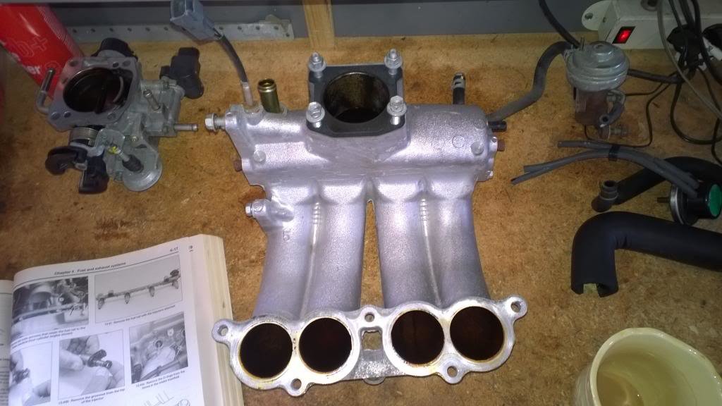

    Next i removed the Intake Plenum form the intake manifold (make sure you unbolt the EGR Valve from the back of the Intake Plenum and remove completely along with wiring harness mounts and sensors)

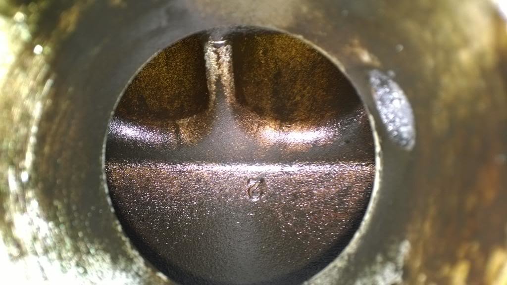

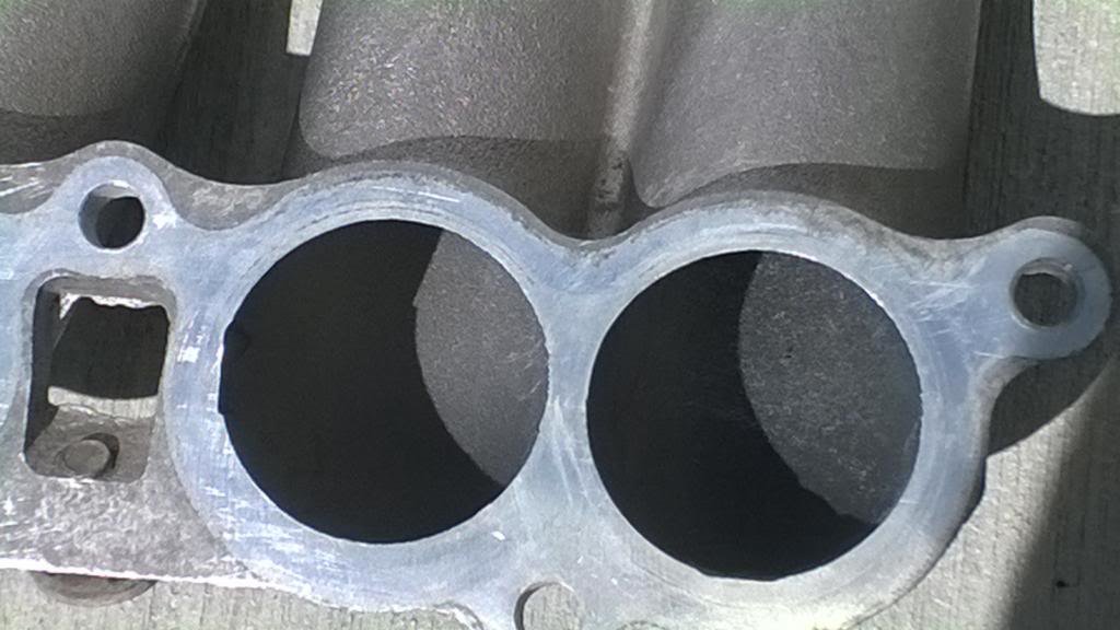

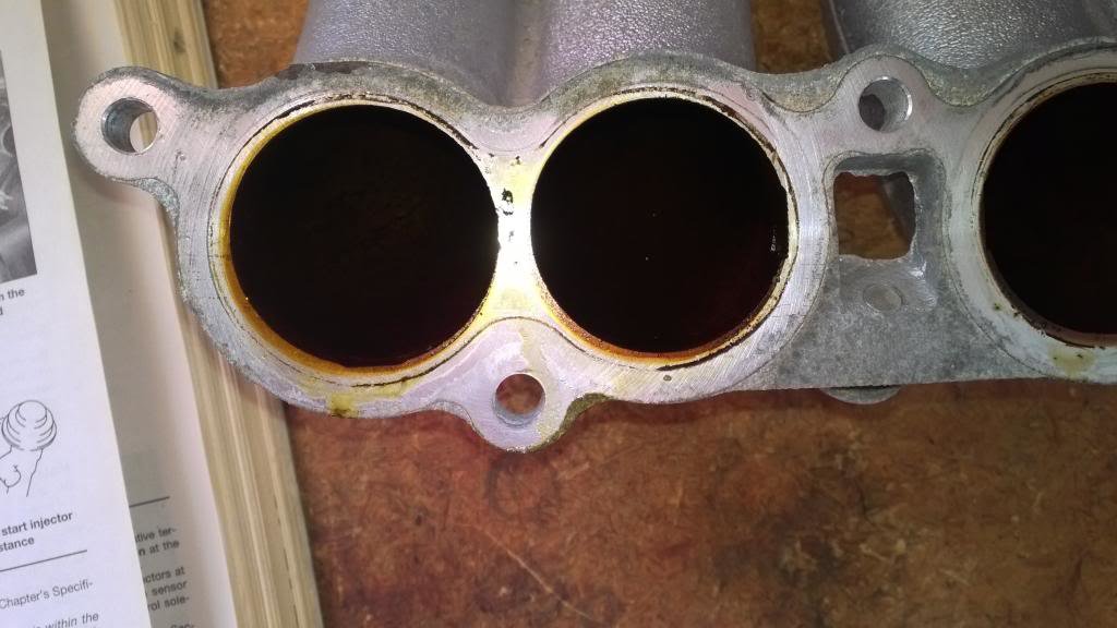

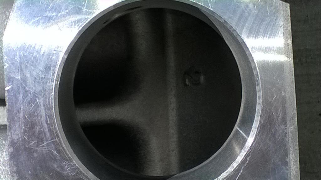

    Here are some pics of what my Intake Plenum looked like. Note my truck only had slightly over 100000 miles on it and to me this is kinda bad, but this is what happens when the PCV vapors get put back through the intake system and yes this is normal believe it or not lol
    Picture looking down past where the throttle body mounts to the Plenum

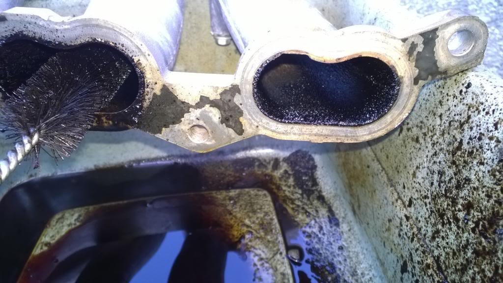

    Plenum runners

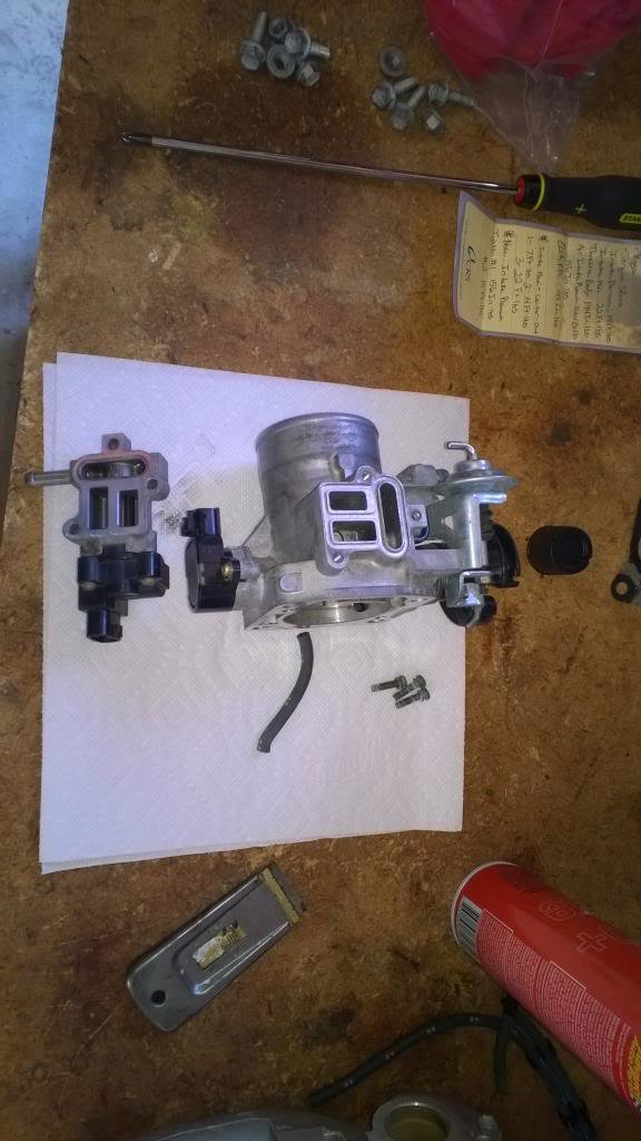

    I also pulled the IAC valve off the bottom of the throttle body and cleaned thoroughly along with the throttle body itself. These are notorious for sticking and causing somewhat of a rough idle. DO NOT use anything other than THROTTLE BODY CLEANER on the IAC and throttle body itself. NOTE!: The gasket for the IAC Valve is also a dealer item!!! Not to expensive though.

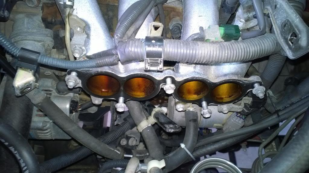

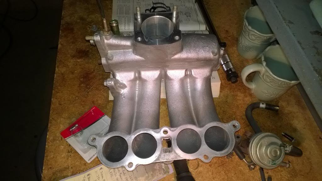

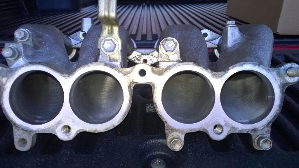

    Now on to removing the Intake Runners
    Now on to cleaning everything up. I used Diesel fuel to first soak the Intake Runners and Plenum to help loosen the majority of the gunk, then started brushing and running shop rags down each runner. Then after that i used Xylene to remove more of the baked on crap and finally finished everything up with a few cans of carb cleaner (yes you can use carb cleaner on the runners and plenum, just not on the throttle body). Hears some pics after cleaning

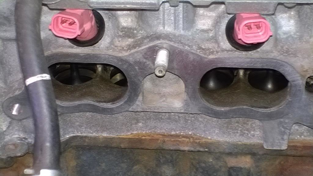

    I also took a a few moments to clean the intake port on the head as well with some Xylene and a rage.

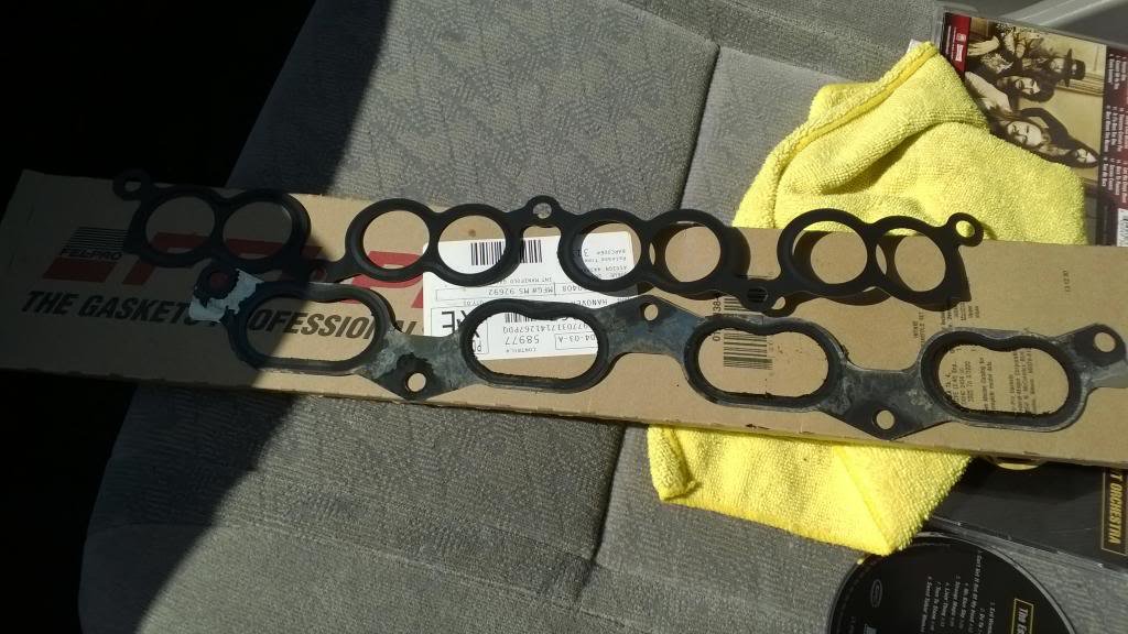

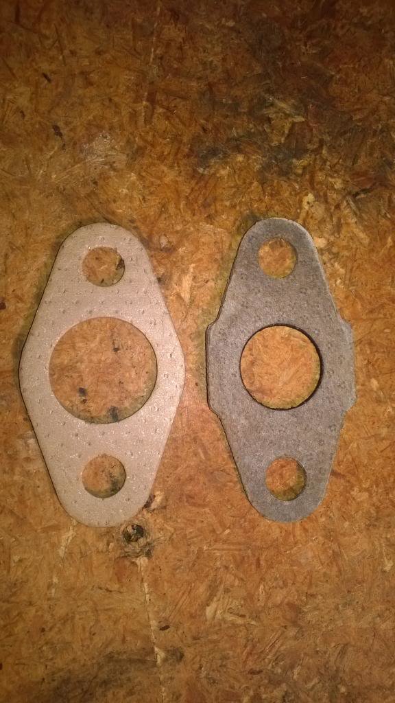

    Now time to reassemble. Hear are the gaskets that i was talking about and the mess up with my truck being California Emissions...
    Top gasket is for Federal Emission Tacomas, Bottom is California. Not sure if when exactly the break was but like i said either find out for sure what your engine is or just purchase both gasket sets and return the one you dont use
    Same goes for the EGR valve gaskets as well. The Gasket to the right is mine (California), one on the left is Federal.

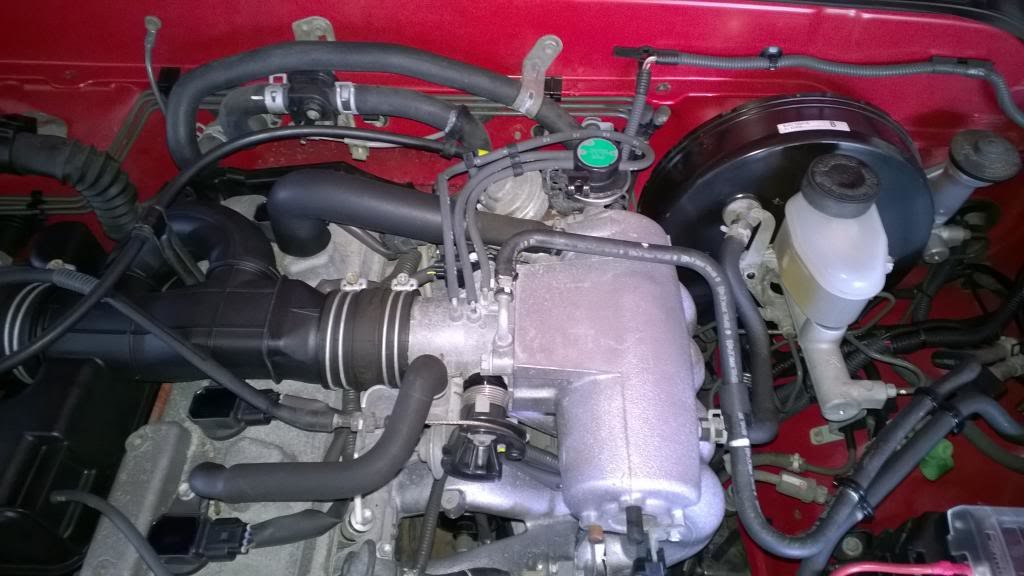

    Now reassemble everything making sure you torque everything down to the manufactures torque specs!!!

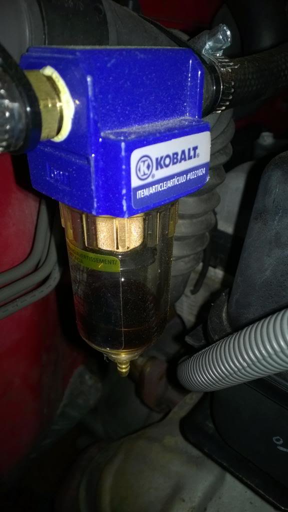

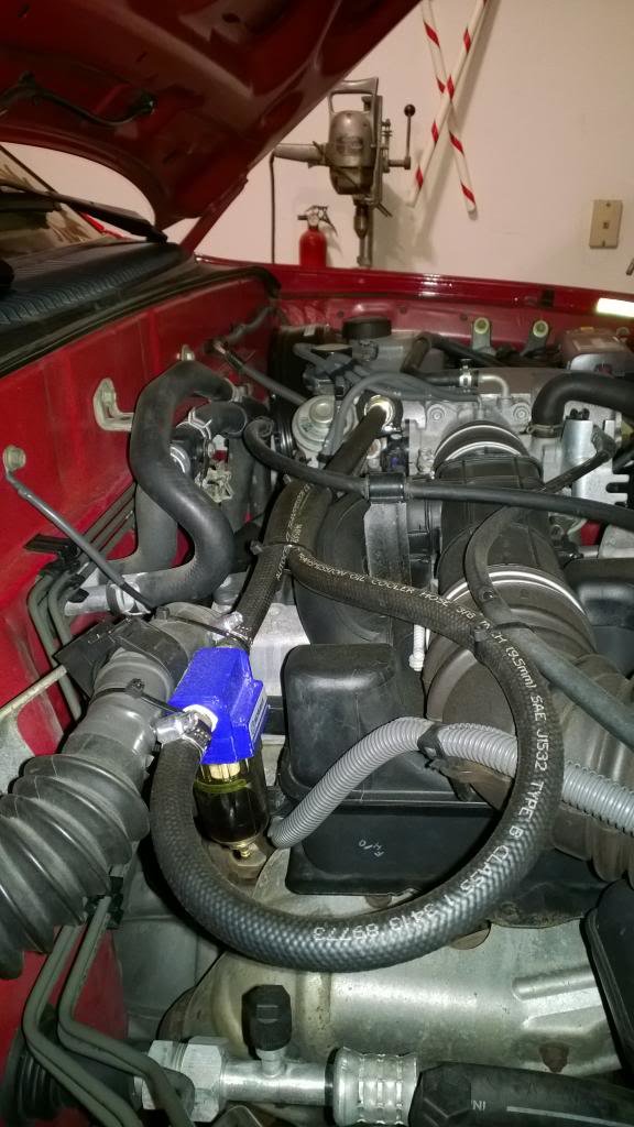

    Hear are the pics to my PCV Catchcan and its working like a charm. All i used was a Kobalt water separator for an air compressor. Also you will need some brass pipe fittings to custom make your connections!! I simply utilized part of the old PCV hose going to the Plenum and put a 1/2 inch pipe nipple in the stock hose then reduced it down to 3/8 to accommodate the Catchcan. I also bought 5 foot of Transmission Oil Cooler Line at Advance Auto to use for my new PCV tube which you will see in the photos below... (im going to take another pic tomorrow of fittings i used so you can visually see what i did).
    And hear is the Catchcan doing its job:D:D

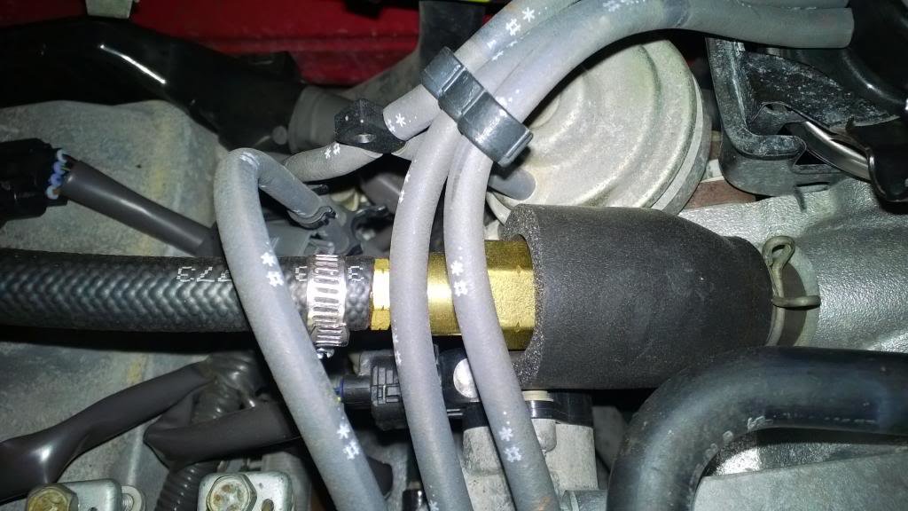

    Thanks man!! To keep everything clean looking, at the end of every season (summer and winter) i degrease and wash the engine and undercarriage down with Krudkutter mixed with 25% Krudkutter and 75% water. I put that in a pump up garden sprayer and spray everything down, let sit maybe take a brush to some things then rinse it down. Where i live they tend to use alot of road salt in the winter and i have about a 1/4 mile dirt gravel road leading up to my house. After awhile things tend to get a little grimy, especially after winter. Like i said i do the undercarriage to to help prevent any corrosion.
    The purpose of the catch can is to prevent combustion gases and oil vapor form going back into the intake manifold and gunking everything back up. The catch can simple pretreats the gases by means of removing the oil/gas vapors before it goes back into the intake to get burned. Every vehicle produces blowby. Blowby is when combustion gases escape by the piston rings and end up in the crankcase. These gases mix with oil vapors and need an escape route or the gasses will build up and blow out seals. So once you clean the intakes you will never have to worry about pulling the intake back apart again. The catchcan will need to be emptied every oil change, but i feel one extra step in an oil change it worth the peace of mind.
    After i did this i did notice that my truck idled smoother and felt like it ran better and crisper. All in all im happy with the results
    Hear are pics before and after modification
    And hear is a pic of the fittings from the intake going to the new hose.

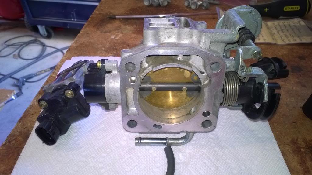

    I just wanted to thank you all for posting the pics and for the added technical comments.
    Last week my truck started idling higher than normal, and it also threw a code for the throttle position sensor. After doing some searching, I came across this thread. Instead of just buying a new sensor, I decided to remove the throttle body and do some cleaning.
    Because of being lazy, I ended up doing it twice. The first time I just removed the intake tube and cleaned inside the throttle body as far as I could with an old tooth brush and throttle body cleaner.
    After putting everything back together, the idle was still high. So I decided to do it right the second time around, and removed the throttle body as I should have done the first time.
    Some things I wanted to highlight based on my experience:
    - Good idea on taking pics before starting in case you forget where some of the vacuum lines go:D
    - You must remove the entire throttle body to do the job right. There is no way you can clean all the dirt behind the butterfly with the throttle body still attached to the intake. Even though I got a LOT of dirt out the first time around without removing the throttle body, there was so much more I couldn't reach with just the tooth brush.
    - Although it is a relatively easy job to remove the throttle body, there are two coolant lines that can be a PITA to remove. Not rocket science but lots of patience - especially if you have big hands. I could barely squeeze my hands in there with a set of small pliers to break the metal clips loose.
    - Definitely need to remove the IAC to complete the cleaning job. There was so much dirt inside those passages.
    -You must have an impact screw driver - just in case - to remove the four screws that hold the IAC in place underneath the throttle body. Those screws are tight! After reading on this and other forums, it is very easy to round them off.
    -About the gasket and o-ring: Autozone and/or other local auto part stores will not have the o-ring that goes with the IAC. That is a dealer only part, not too expensive. I think I paid like 4 bucks for it. The gasket for the throttle body can be found at autozone for like $1.50, lol. I ended up replacing both even though I didn't really needed it.
    I did not remove the rest of the intake for a more in-depth cleaning as shown on the pics above - because I needed to get the truck back on the road quickly. But that is something that I will do in the near future.
    Anyway, the idle is back to normal now. I assume it is because of all the nasty dirt that came off after I cleaned the throttle body.
    Once again, thanks all for the good info ;)
