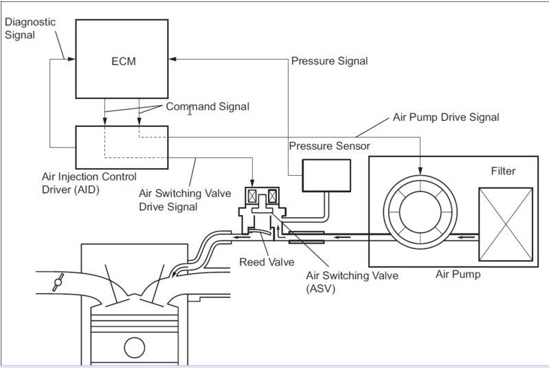

    There is more that can give those indicators other than the valve actually being stuck closed. The pressure sensor could be defective or the wiring.. or the ECU. Is the pump actually running when commanded?
    The below information is from the service manual:
    P2441:
    Pressure sensor detects no pulsation of exhaust gas despite ECM commanding Air Switching Valve (ASV) to open, while engine running (2 trip detection logic)
    Causes:
    •ASV (air switching valve)
    •Open or short in ASV circuit
    •Vacuum hose (ASV - pressure sensor)
    •Air injection hose
    •Pressure sensor
    •Pressure sensor circuit
    •Air Injection Control Driver (AID)
    •ECM
    P2445:
    Secondary air pressure less than 2.5 kPa (19 mmHg) despite ECM commanding air pump to turn on (2 trip detection logic)
    Causes:
    •Air pump
    •Open in air pump circuit
    •Air injection system piping
    •Vacuum hose (pressure sensor - air switching valve)
    •Pressure sensor
    •Open or short in pressure sensor circuit
    •ECM

    Additional information from the service manual:
    P2441:
    HINT:
    Air switching valve normal operation:When the Air Switching Valve (ASV) is open, exhaust gas pulsation occurs in the secondary air passage.
    When the ASV is closed, exhaust gas pulsation does not occur in the secondary air passage.
    MONITOR DESCRIPTION:
    The ECM monitors the pressure in the secondary air passage using the pressure sensor connected to the ASV of the Secondary Air Injection (AIR) system. If either of the following conditions occurs, the ECM interprets it as a malfunction of the secondary AIR system, and illuminates the MIL and sets a DTC:
    • Exhaust gas pulsation is detected by the pressure sensor despite the ECM commanding the ASV to close.
    • Exhaust gas pulsation is not detected by the pressure sensor despite the ECM commanding the ASV to open.
    P2445:
    The ECM monitors the pressure in the secondary air passage using the pressure sensor located on the Air Switching Valve (ASV) of the Secondary Air Injection (AIR) system. The sensor measures the pressure in the secondary air passage and transmits a signal to the ECM. If either of the following conditions occurs, the ECM interprets it as a malfunction of the AIR system, and illuminates the MIL and sets a DTC:
    • The pressure indicated by the pressure sensor does not reach threshold levels despite the ECM turning on the air pump.
    • The pressure indicated by the pressure sensor exceeds threshold levels despite the ECM turning off the air pump.
