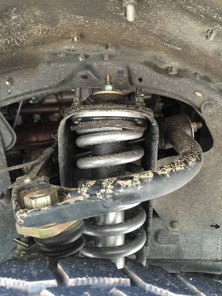

    I installed my Eibach 521600 2.5" coils 10 days ago without the top plate spacer on either side and was 21 7/8" both sides
    What I don't know is what the stock TRD OR 4x4 measurement is from center of Hub to under edge of fender. I didn't keep that measurement when I changed to 5100s. But I think it is around 20".

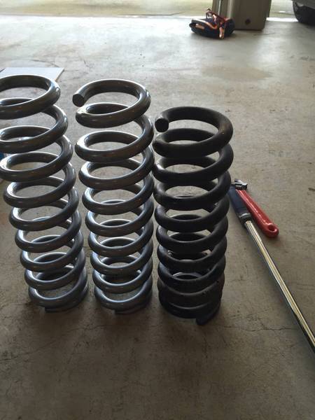

    The new 521600 Coils on left - a TRD OR could on right:
    Installed without top plate spacer:
    Truck before spacer:
    Then I added top plate spacer:
    And am just shy of 23"

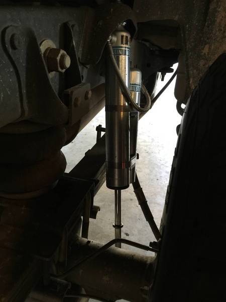

    I did put 5160s in the rear....they are really nice btw:
