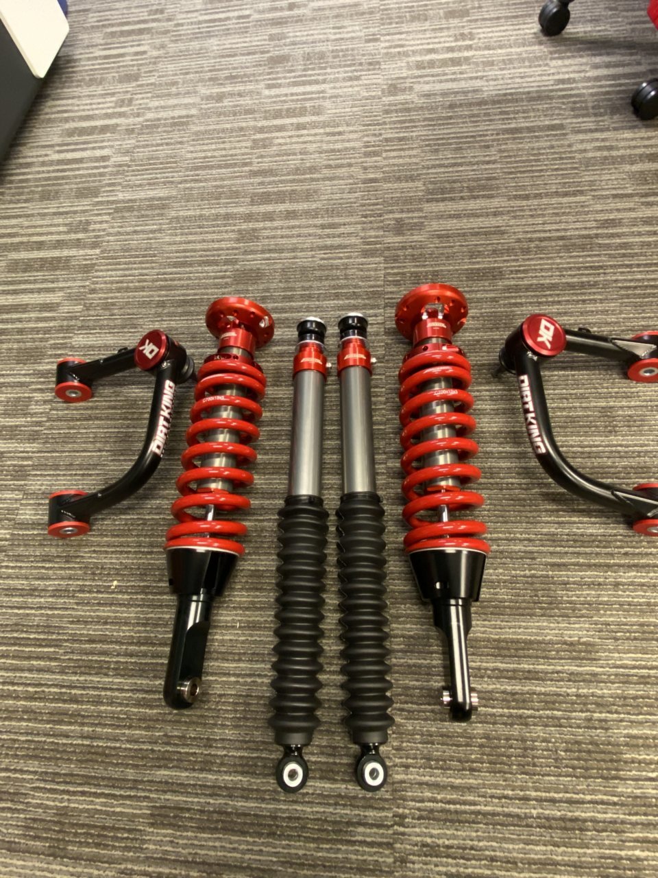

    This is my set up going on next week, is it the best nope. There is no best, it's what works best for the individual who wants it. I am a New Englander. and a Uni Ball UCA in the Salt Belt is not a good idea as it won't last long. There are a lot of other better choices out there than TC UCA's

    Thanks John, just love fan boys that because they say it's the best we all should think that. I have had JBA 2 times now and had no issues with them except the powder coating flaking off, and the rusting Ball Joint tops which Marlin replaced for free for everyone. Had SPC 2 times and both times sucked before they made some great changes, even had Camburg which were complete junk. Now Dirt King as I have yet to see or hear any negatives about them.

    Thats great except that this is the 1st gen section and dirt king unfortunately doesnt sell anything for our truck :D
