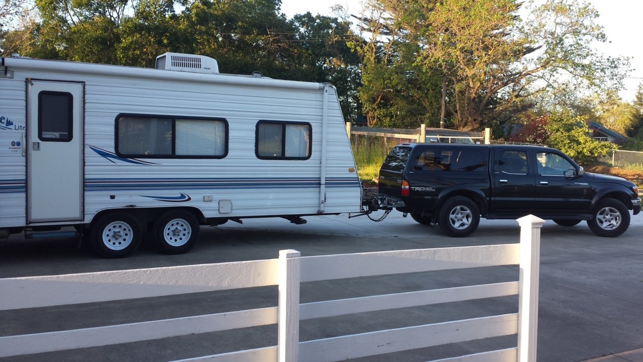

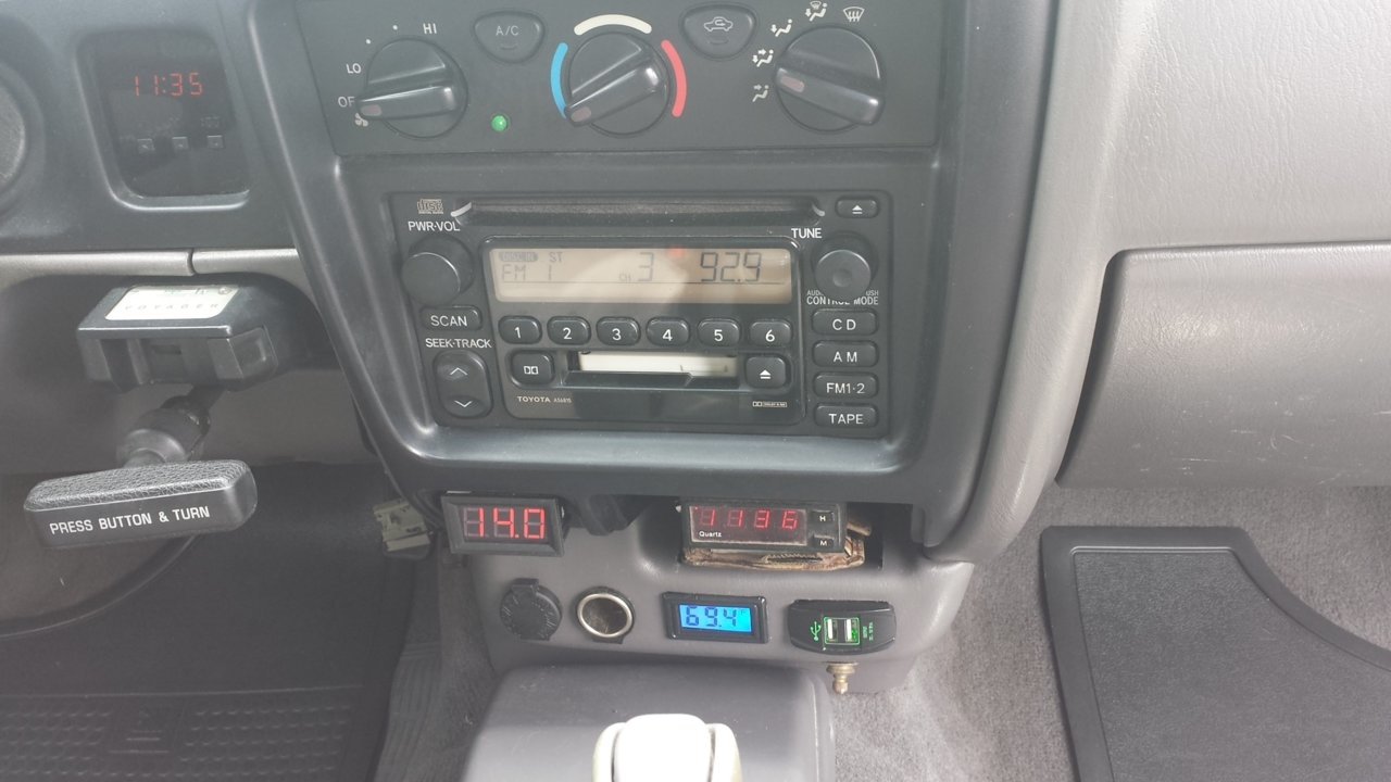

    20200429_113556.jpg 20200426_190946.jpg I'm really new here and my 1st Tacoma but years of experience towing.
    1st find the "Towing Bible " in this site it's got great info . In fact I should edit this and post there.
    I just finished setting up my 01 exactly same truck except 4dr. 4x4 automatic.
    Check my brake controller location in the photo.
    I like to have the controller accessible for easy manual operation and imo this was the best spot. Spent a lot of time fabricating the mount to clear the Parking Brake. I wear a large size glove but not a thick hand and works for me .
    2nd photo is my 2ft , 3700lb trailer on a test drive over Donner Pass in Calif.
    I have 4.10 rear end gears and 265 tires.
    I pulled the grade in 2nd gear 50 - 55 mph right around 4000 rpm passing most of the 18 wheelers .
    I have no Toyota experience but the specs list max torque @ 3800 rpm and max HP @ 4800 rpm. The tach and owners manual indicates you're OK up into 5000 plus so I felt comfortable with that. You may have noticed I have transmission temperature monitoring and stayed below 200 deg f @ 75 oa temp.
    Engine temp climbed a couple degrees 163.
    Hopefully someone with Tacoma experience will jump in and say "Yeah, you can run em all day @ 4000".
    Avg. MPG up and down and flat back home @ 55 - 60 mph was 12mpg.

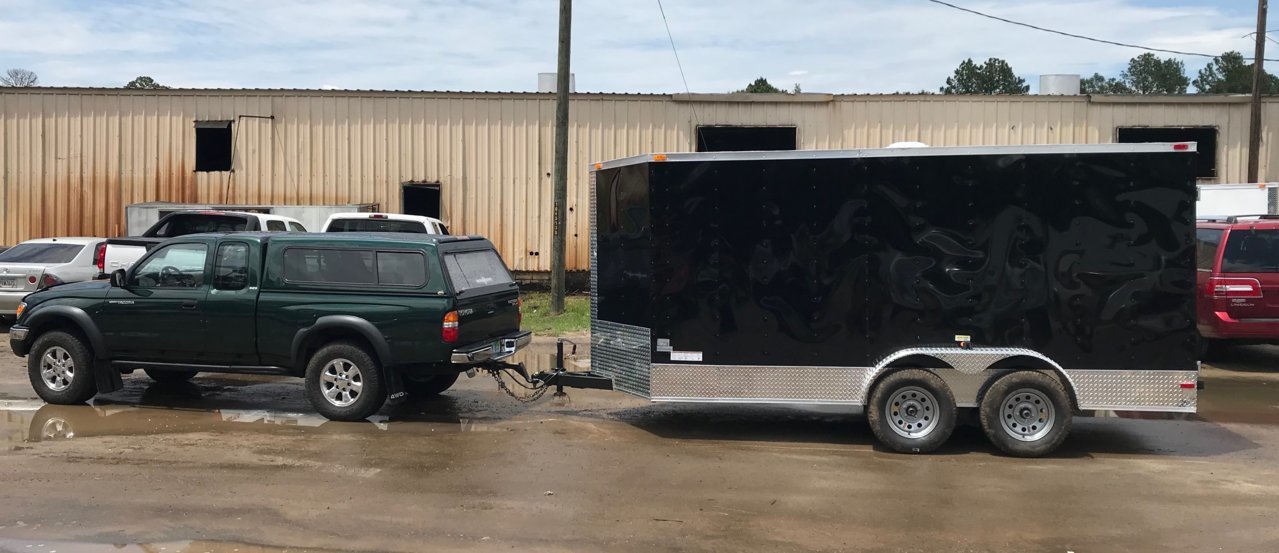

    Truth, I did the EXACT same thing 2 years ago. Only difference is that my truck is a 2001 auto trans with tow pkg.
    My friend bought a brand-new 7' x 14' from a trailer mfr in Pearson, Georgia (probably where you are getting yours - & what a dump!), and I was "drafted" to pick it up at the factory and deliver it to him in Granby, CO.....what a trip THAT was! I added a Tekonsha P3 trailer brake controller before the trip, (mounted just in front of my left knee-cap, & angled it up so I could see it when I looked down). Took off on a Monday morning from where I live in Lansing, Michigan.
    Towed the empty trailer from Pearson, GA to Granby, CO (interesting in the mountains). I got as low as 7mpg on the leg across Kansas since I was going into a 28mph headwind with gusts to 40mph, and it was 95 degrees! It towed it fine, but you certainly weren't going to go anywhere fast, and I frequently turned off the OD (not a problem with a manual) to keep the truck from shifting constantly.
