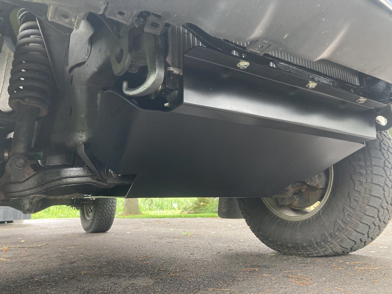

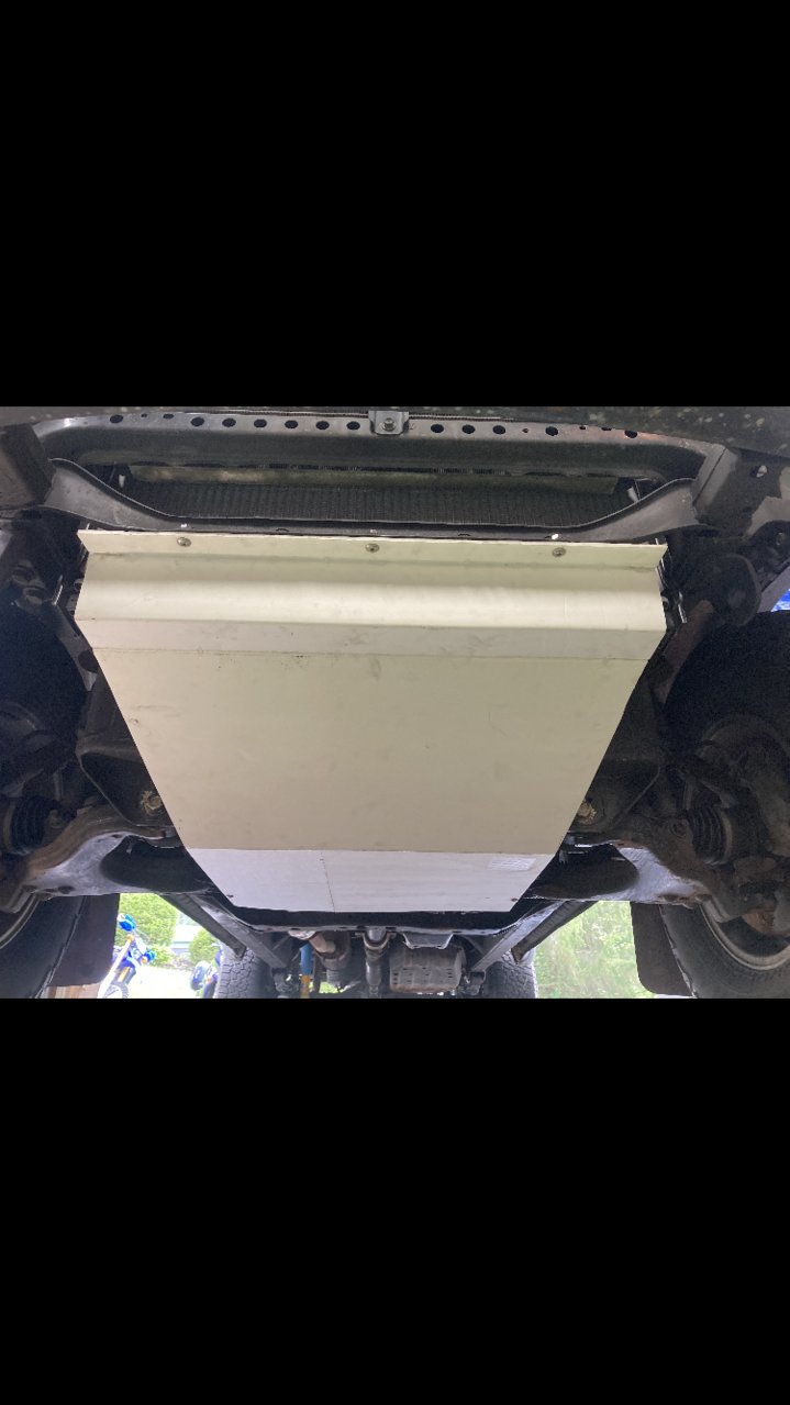

    Hey so I’m pretty new to TW still, but I wanted to put this post out there in hopes it reaches lots of people! So I just recently designed and built a skid plate for my 02’ Tacoma and wanted to show the process. I started with some poster-board and quickly reached for foam-board to hold a better shape, I spent about 6 hours getting measurements and correct angles. This mounts to factory locations and doesn’t require any drilling. Built with basic tools and spray paint. If people are interested in this build and enough people wanted a template I would be interested in starting to sell them possibly (at a very reasonable price). Please send feedback! Thank you 54F1313D-3220-491C-9258-A6C407C14972.jpg 77A710B6-A457-414A-8D33-43A45988DB7D.jpg C100598D-AF5A-457E-A6E5-35C892FBE489.jpg 06EA974A-CB73-4E1D-9DE1-296723CD1BB7.jpg

    Looks Awesome! Is it 3/16" (7 gauge) or 1/4"?

    I made mine from 1/8” plate, I don’t do much off-roading and rock smashing. I mostly wanted to keep debris and such out when I do go off-road. Also snow in the winter.

    If that's the intended use, would aluminum be a better choice?
    *Full Disclosure - My shop builds skid plates, and other parts for several well known name brand companies. And your design looks well thought out from a manufacturing standpoint.

    Aluminum would have been a nice option. I like working with steel and also like the price. $93 for the 4’x4’ sheet I bought!

    Looks good, and I would be interested, but NO WAY will I have a skid plate that has to be removed to change my oil!

    I’ve thought of this. There is an area (hole) that you can cut to allow access to drain your oil. Or do what I do and buy an oil valve that allows you to drain your oil at the flip of a lever! Either way you’d be able to leave this skid attached

    How are you getting around not getting oil on the skid plate when you remove the filter? Serious question.

    OP intends to add access to the oil drain plug; already got that part drawn up.
    But getting a skid plate off isn't really a big deal; I had a Budbuilt that weighed over 55lbs :burp:
