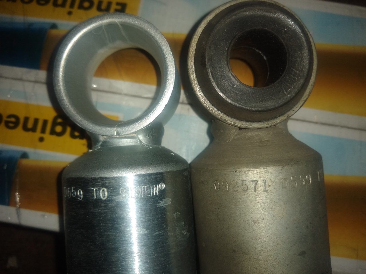

    I just got my shock absorbers in the mail:
    • BIL BE5-D559-TO 5100 Rear Shock, 95-04 Tacoma, Driver Side, 13.9" x 21.6"
    • BIL BE5-D560-TO 5100 Rear Shock, 95-04 Tacoma, Passenger Side, 14.7" x 22.6"
    When I first opened the package and saw the shock absorber I thought it was perhaps bootleg based on the build quality. I then did a high res img search and noticed the same gap on the stock img I found. Maybe manufacturer practices have declined over the years but I still feel a bit hornswoggled.
    stock photo
    What I received.
    I see that I accidentally cut off the top but it's a solid ring.
    P.S. no install notes included is there a specific torque level or nah?
    P.P.S. New shock absorbers say RCD. Maybe there was a merger or something and they are just made differently now :shrug:

    Hey, what's the deal with bushing and washer orientation? I can only find a diagram for 2005+. I thought it would be straightforward but here I am. I still have the passenger side shock absorber on and the top washers cup outwards and the bottom ones cup inwards around the bushing. I'd use words like concave and convex but I think things are confusing enough as is.
    I've looked at several youtube videos and not only have I seen the washers installed either way, but I have also seen the shock absorbers mounted upside down. I am only more confused. :/
    I found this video and hope its correct (though it doesn't mention the top washers):

    The cup washers should have the concave side facing away from the shock to accommodate the shock leaning during articulation. That way the washer doesn’t dig into the bushing.

    Nitrogen shocks can be run shaft up or shaft down. Will not effect their performance. I prefer shaft down to keep the shock body up, out of harms way.
    RCD has been around for a long time. IIRC, RCD makes certain applications (including Tacomas) for Bilstein.

    top and bottom or just on the bottom? Thanks for confirming what the video was explaining!

    Top and bottom washers go the same direction.

    Quick question: I didn’t realize there was a difference between drivers side and passengers side part numbers. Is there really a difference in the part itself?
    I ordered two (2) 33-230443 because I wanted the softer valving - but in your data above you show that this is passenger side specific and that there’s a different part number for the equivalent drivers side.
    FYI - I bought these shocks three years ago and haven’t installed them yet. Long story…

    Difference is only in length. That extra .4" won't create any problems.
    I've been running 2 identical extended length shocks for years, no problems.

    It's only because the passenger side upper mount is higher. As long as you won't bottom out your shocks you are fine.

    I can get the ext length for my rear shocks but the compressed whats the easiest way to? Do i get on rhino ramps on one side?

    Best way is to remove all but the main leaf from the spring pack and compress it until your bumpstop hits (or something else).
