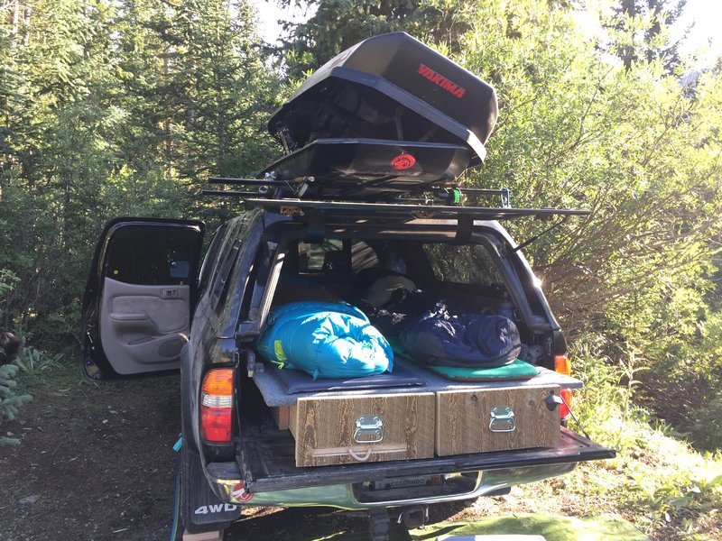

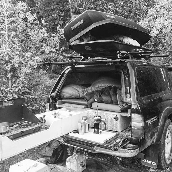

    Hey there. I have built a camper conversion in the back of my 02' double cab Tacoma. Due to the weight of the sleeping platform, drawers, and gear my truck is sagging in the back about 1.5 inches. Aside from going full replacement of an OME setup is there an alternative way I can level out my truck to get my clearance back?

    I am pretty much running up to the mountains every weekend so I typically keep it geared up so I can dash after work on Fridays.

    So for me its too short. Im an even 6ft and so to make it long enough I made an additional pullout to extend the bed. Ill attach some photos so you can see how it all works. But basically I pull the drawers out to the end of the tailgate and add a platform on top. This make my platform a good 6.5ft. Then I have this truckbed tent I got on Amazon https://www.amazon.com/DAC-Mid-Size...899&sr=1-1&keywords=dac+mid+-+size+truck+tent to keep me out of the weather. It has worked pretty well so far but I would much rather have a fullsize bed on my next Tacoma. I hope this helps let me know what questions you have.
