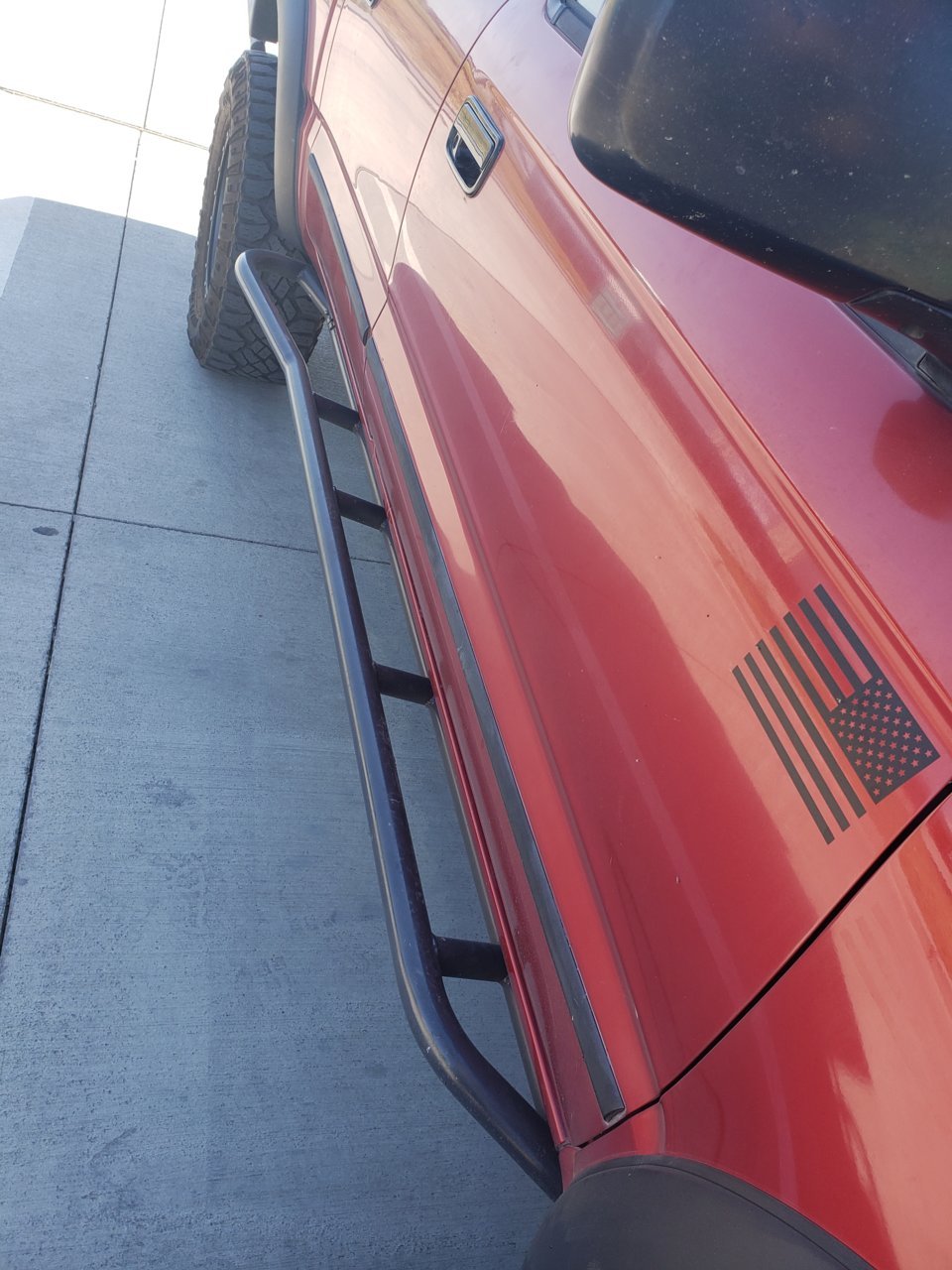

    4xInnovations:
    I really liked them because it's a "kit" that comes with the standoffs and braces separate so you can set the width and angle to your liking.
    Mine were like $250 for DOM tubing (shipping was like $80 iirc)
    I cut about an inch off the width, btw...

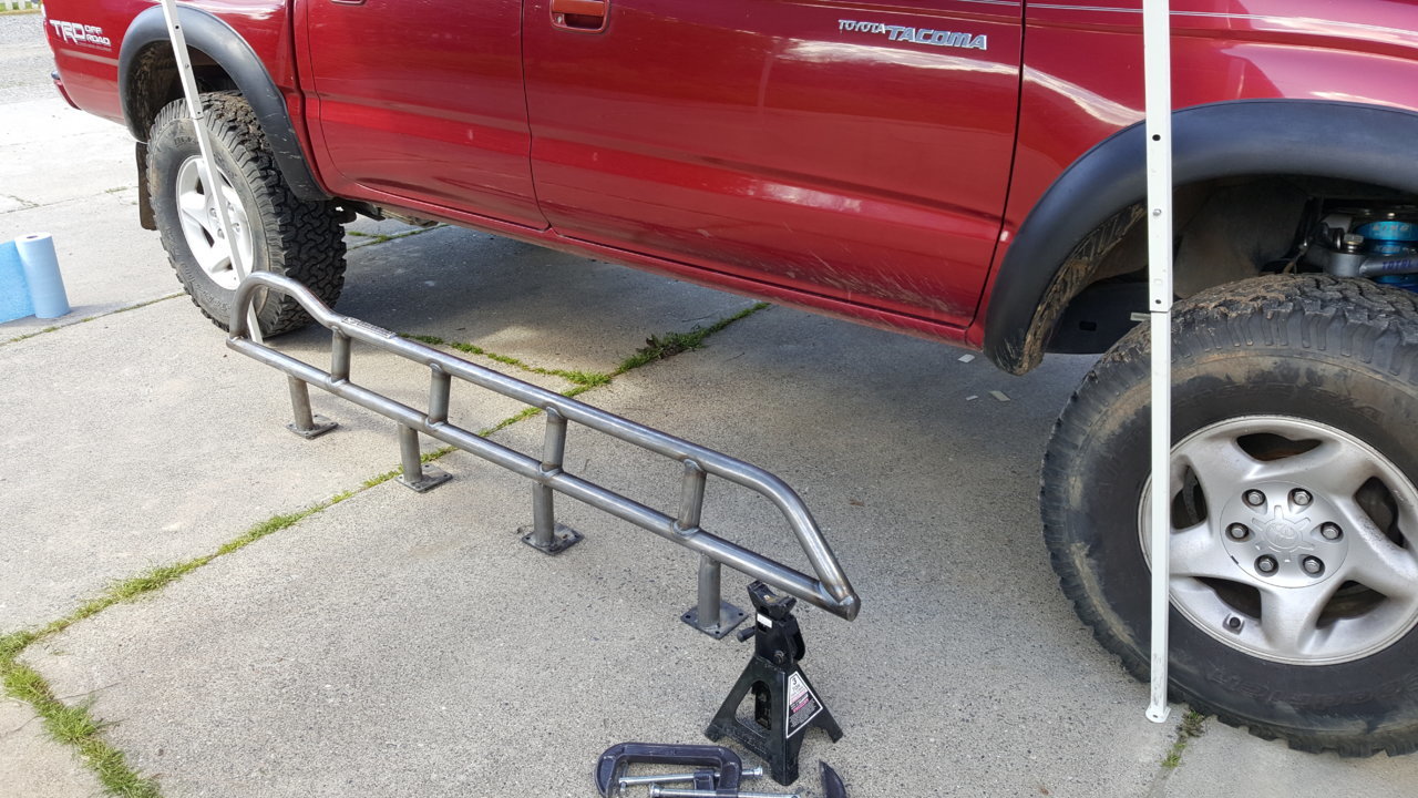

    What questions? I'll do my best to answer them.
    I don't really have a build thread. But here's the jist.
    Mock everything up, and mock it up again. Even with my small under powered welder, mocking everything up still took longer than actually welding it.
    I think I used the #1 (far front) and the #3 support tubes with the 1/4" plates clamped to get everything set the way I wanted it. I ended up taking about an inch off the width (each side) for a narrower profile. The 1/4" plates ended up basically flush with the bottom of the frame, and the tubes weren't much higher. I think you can see in my other pic that I used a ratchet strap to hold it tight to the frame while adjusting the angles and tack welding it into place.
    Measure 3-4 times, then cut a little long. It's easier to grind off a little material than to add some back on, lol...
    DON'T weld the plates to the frame until the very end.
    Here's a pic I have of one side mostly assembled. I haven't welded the gussets on yet.
