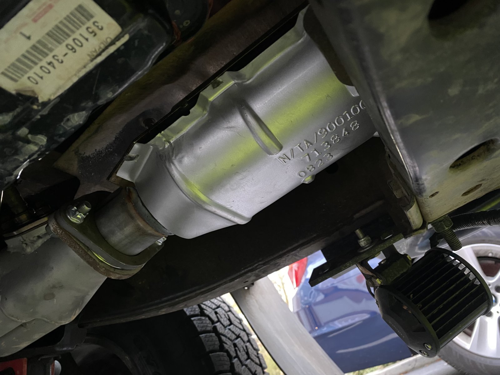

    I put a walker cat in today. The flanged end didn’t seem to mate up well to the header or muffler pipe but it doesn’t sound like it’s leaking. Otherwise it was essentially a direct fit.
