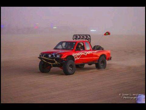

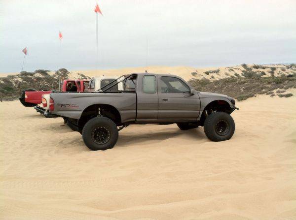

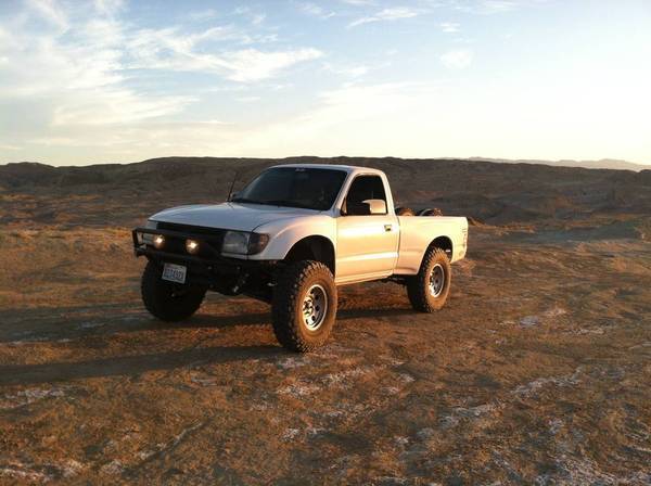

    Finding any discussion on 1st gen LT is getting scarce - let's begin a thread about anything 1st gen desert and LT truck based.
    Pic for attention. Go!

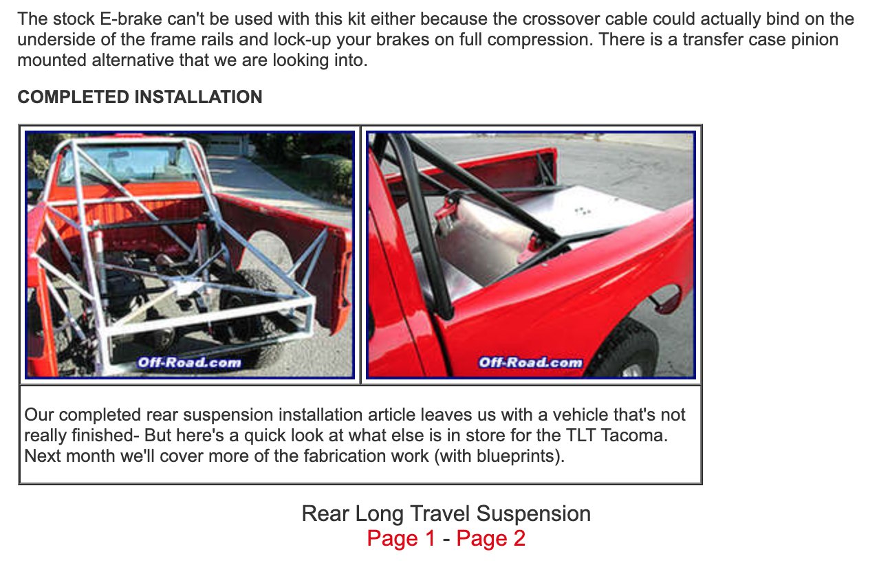

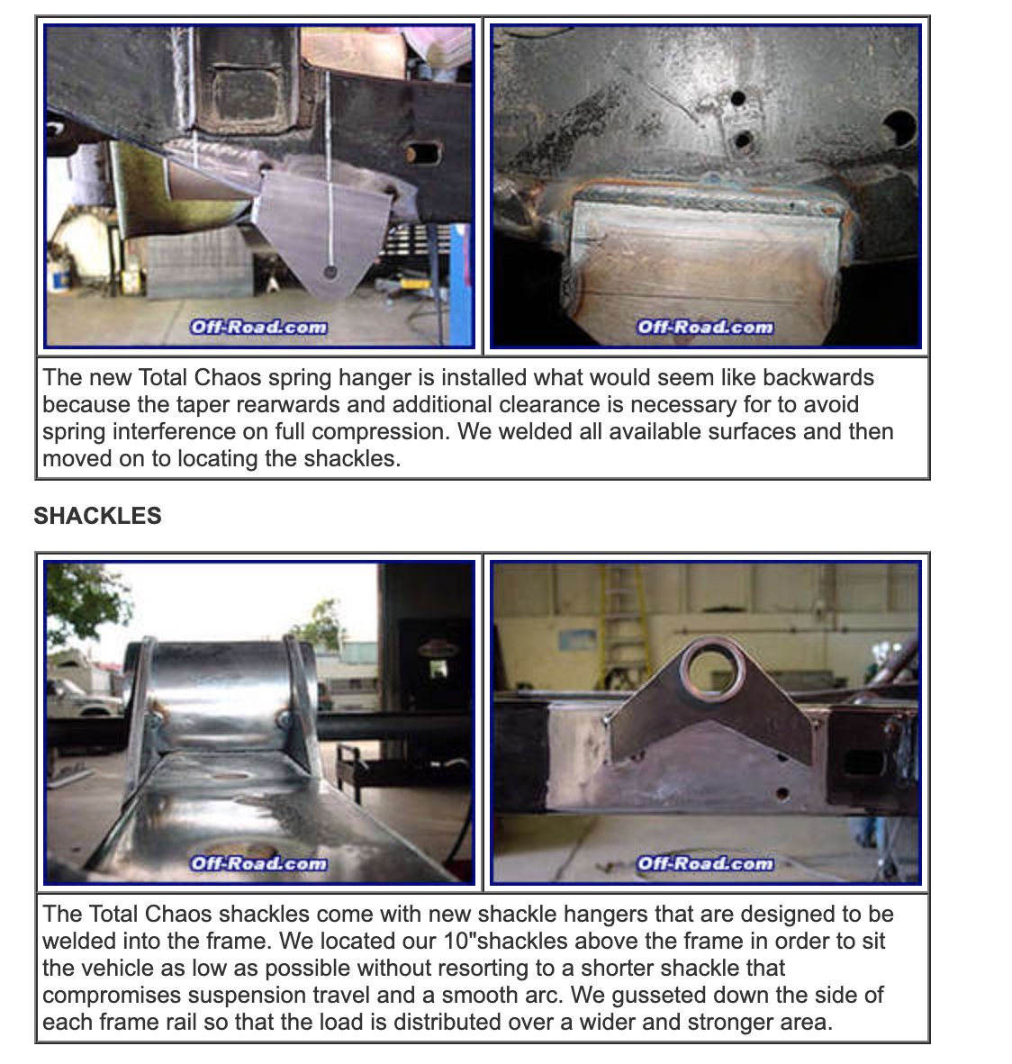

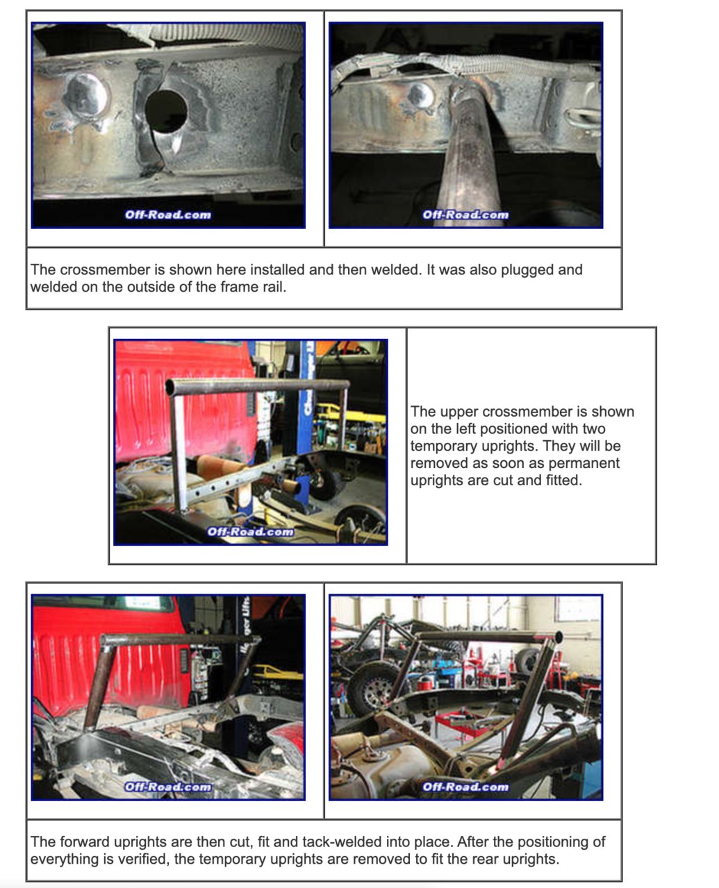

    http://www.off-road.com/trucks-4x4/project579.html
    https://giantmotorsports.com/index....g-travel-kits/64-long-travel-leaf-spring-kit/
    https://www.tacomaworld.com/threads/rear-setup-first-gen.543193/

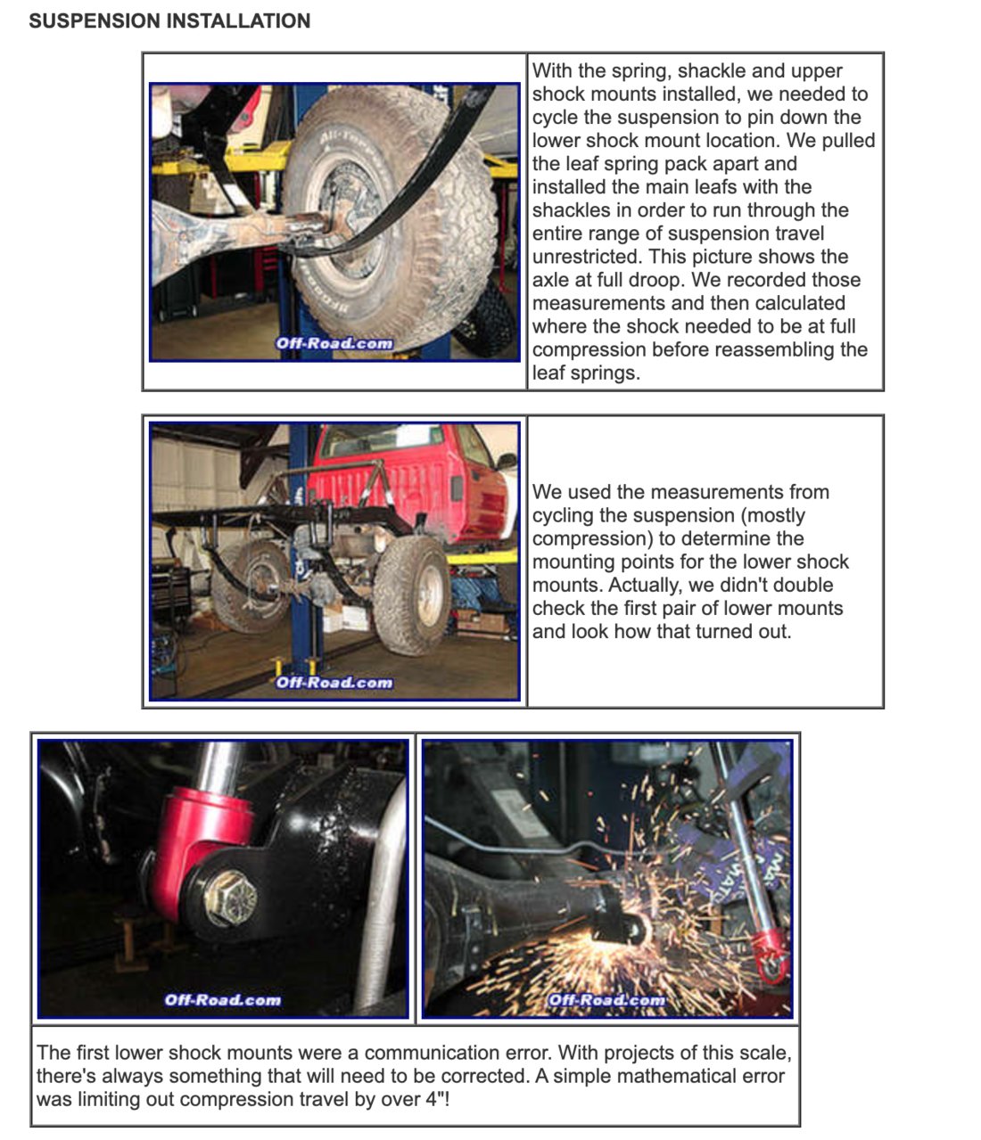

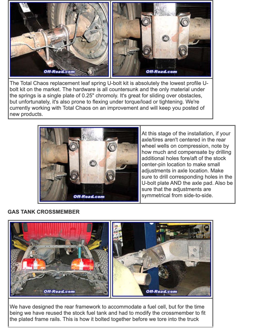

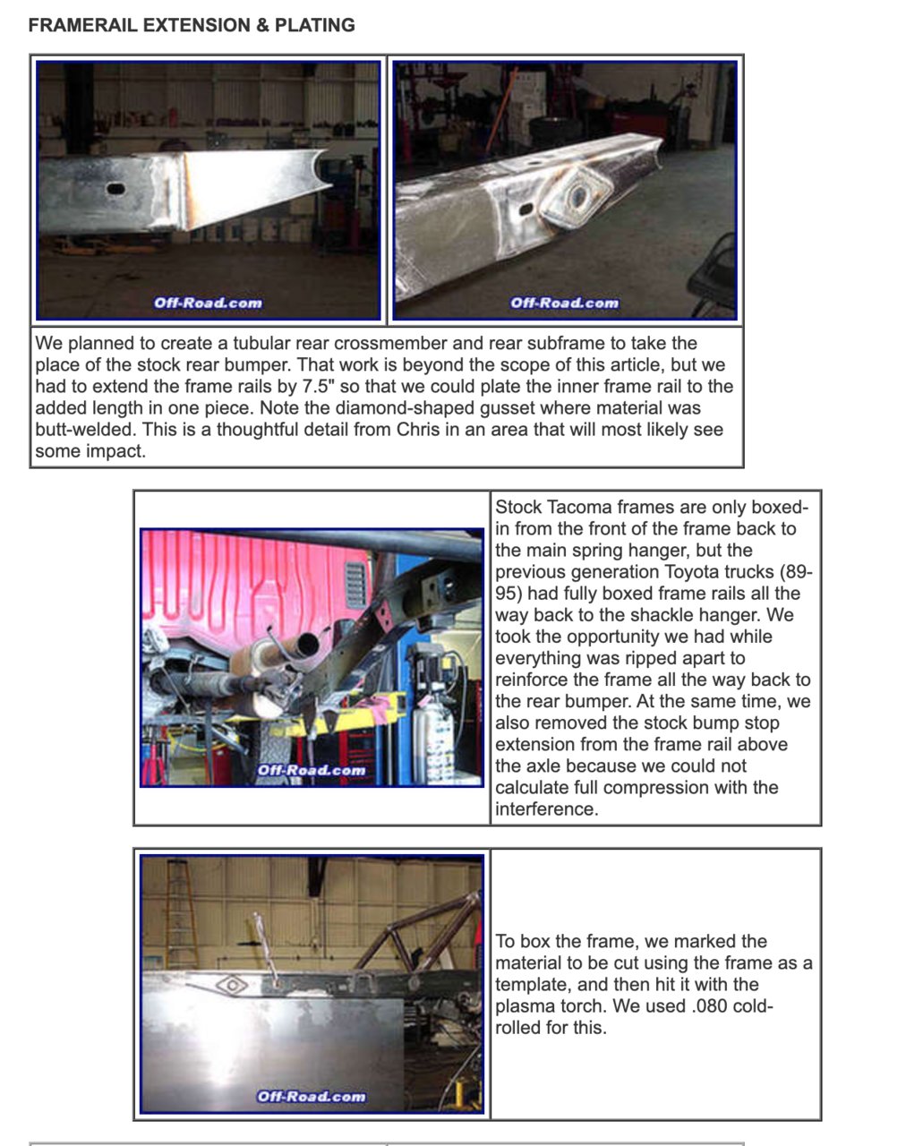

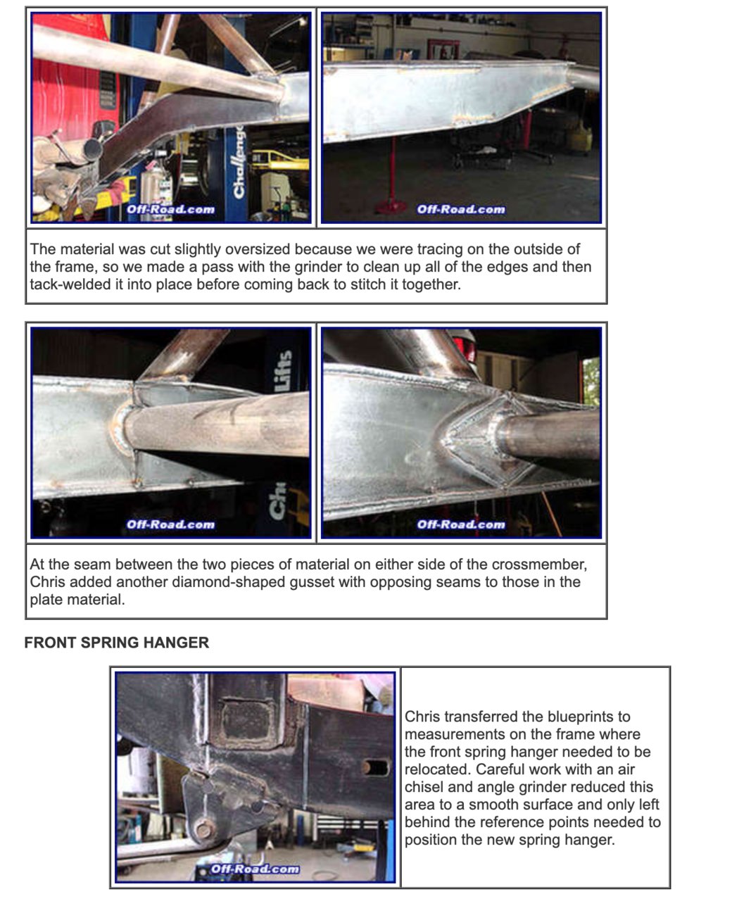

    Here is what I've done in the past:
    1. Weld your spring perches to the bottom of the axle. If you're keeping the stock axle, the easiest way is to put the axle on jack stands with the factory perches facing down. Put a digital level on them and set them at 0°, parallel to the ground. Set your new perches on top of the axle, at the same distance from the axle flange, and set them to 0° (parallel with the factory perch). Tack them in place in all 4 corners and make sure they're not going to move. Set it back under the truck and connect the driveshaft.
    2. Break the spring pack down to the mail leaf and military wrap leaf. Reinstall the center bolt and u-bolt them to the newly tacked perches. You can use a block of wood to replace the missing leafs so you can use the same u-bolts to cycle the suspension. Bolt the front spring hanger to the leaf spring and, with the axle centered, compress the axle to full bump on the frame where the factory bump stops are. Swing the leaf spring so the new hanger is touching the bottom of the frame. IIRC, the center of the bolt hole should be 1" forward of the rear most vertical edge of the rear cab mount. Tack the front hanger in place.
    3. Bolt the shackle to the leaf spring with the upper bushing assembly installed and set the bushing sleeve on top of the frame. I like to take a 1/4" spacer and put it between the bottom of the frame and the eye of the leaf spring to insure the spring will never hit the frame at full bump. Tack the bushing sleeve to the top of the frame (assuming you are using 12" shackles). Measure from the spring hanger bolt to the bolt on the upper bushing assembly. Based on the experience of others, a measurement of 53" from spring hanger bolt to the top shackle pivot is ideal.
    4. Once everything is tacked on both sides, cycle the suspension and make sure the pinion angle looks good, nothing is hitting and everything is centered. Once confirmed you can start cycling the shocks. Take a piece of plywood and clamp it to the frame in the general area you want to mount the shocks. One thing to keep in mind, if you are keeping your stock tank, you may want to consider leaning the shocks towards the rear. I know this isn't what most people do but I did this before I added a fuel cell and the truck rode great for having leaf springs. Whether you lean them forward or back, you want to make sure the shock is going to be in compression as the axle wants to rotate under load. Meaning, you don't want to lean the shocks forward with the tabs on the back of the axle. As the pinion rotates up, the rotation will be assisted by the rebound valving of the shock and you will notice the rear of the truck lift under load rather than squat or stay the same. If you were looking at the axle from the driver side, if you're leaning the shocks back, the tabs on the axle should be between 9-noon, if leaning them forward the lower tabs should be between 6-9. So...tack the lower tabs to the axle as close to the frame (or tire if running a wider axle and mounting shocks outside of the frame) so that they wont hit at full articulation. Then compress the axle to full bump and compress the shock all the way but leave about 1/2" gap of shock shaft showing. Wrapping two zip ties around the shaft is an easy way to make sure the shock doesn't completely bottom out. With the lower bolted to the axle tabs, stick a sharpie in the upper shock hole and swing and arc along the plywood from front to back of the truck. Then drop the axle to full droop and completely extend the shock, then draw another arc on the plywood. Where the two arcs meet will be the ideal location for your upper shock mount.
    5. Once you have your shock locations known you can start building your shock hoops/ bedcage. I would get the upper shock mounts tacked in place and then cycle everything with the leafs still broken down to make sure everything clears. Once confirmed you can weld everything in place.
    6. Bolt the leafs back together, assemble everything and then droop it all the way, compress the suspension about 2" and get your limit straps mounted so that the strap is taught before the shock is fully extended.
    Sorry if some of this doesn't make sense, a few photos would go a long way but if I can help explain anything better let me know.
