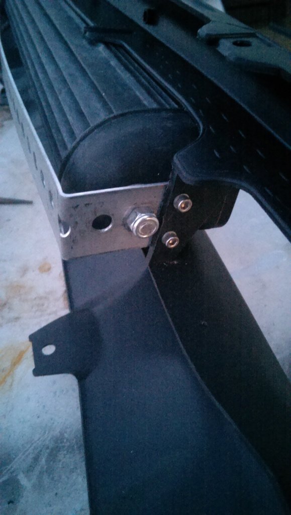

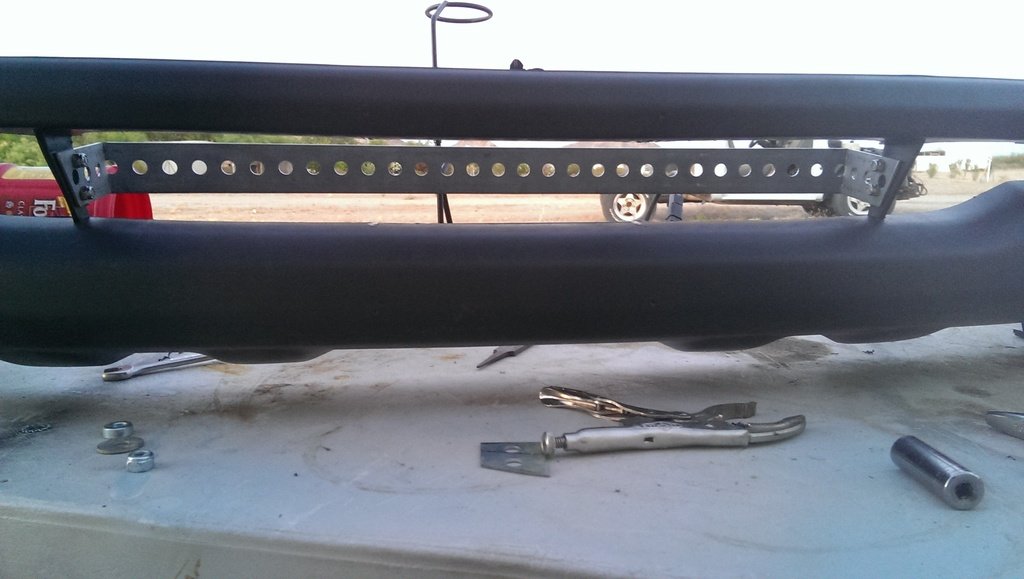

    Working on my reinstallation of my lights in my new bumper valance I ordered up. Decided I wanted an even more sturdy mounting solution so I made up a custom bracket this time instead of drilling two big holes in those tabs. Plus I wanted the 20" bar to sit back inside the hole more to make it look cleaner and more flush rather than sticking out of the bumper like an inch. Came along quite nicely! Very sturdy. Doesn't budge a bit. Having it mounted the other way with the studs through the tabs would cause it to loosen and swivel up and down a hair. Eventually making it point down a little bit. The collision center that reinstalled it in the replacement valance they provided did a shit job so it was really loose and pointing down at a mad angle. No Bueno..
    Anyways... Here's a couple teaser shots. Gonna try to get my two 8" bars reinstalled in the turn signal area next week. I'll probly do a write-up on the whole process when I'm done. Thought I'd share here for now.

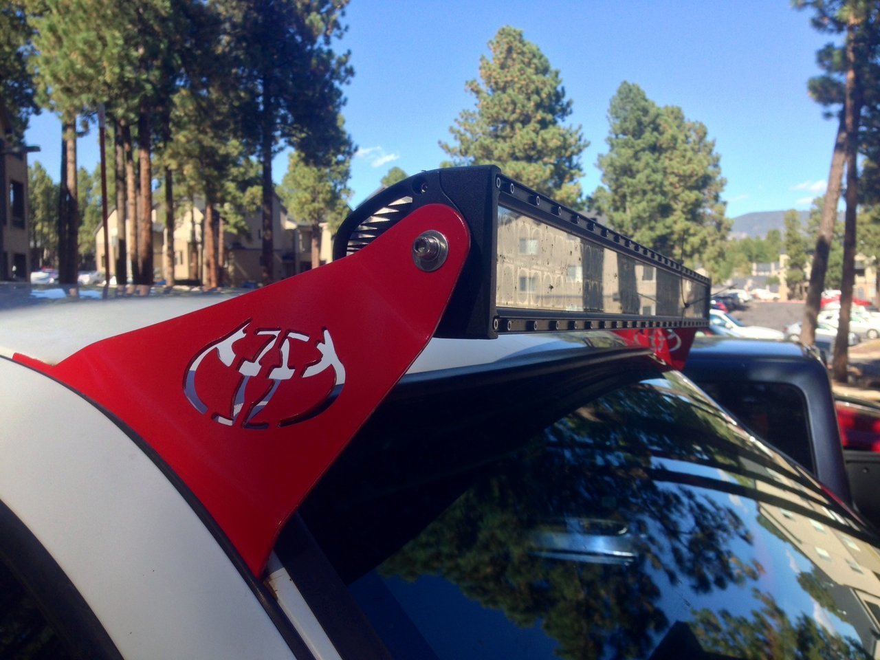

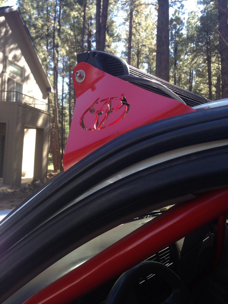

    i have a 50 in straight and i made some custom brackets for it.

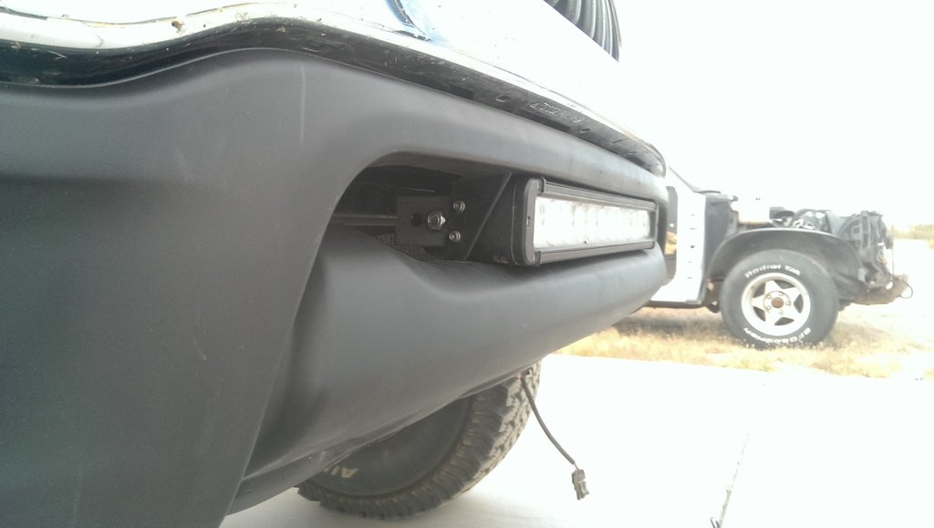

    Got the new valance bolted up. Light bar looks much better sitting more flush with the new bracket:)

    Update: 20" reinstallation completed. Next up to reinstall is the 8" bars in the turn signal housing. Then I'll also be ordering up another set of 8" for flush mount reverse lights in the rear bumper:D
