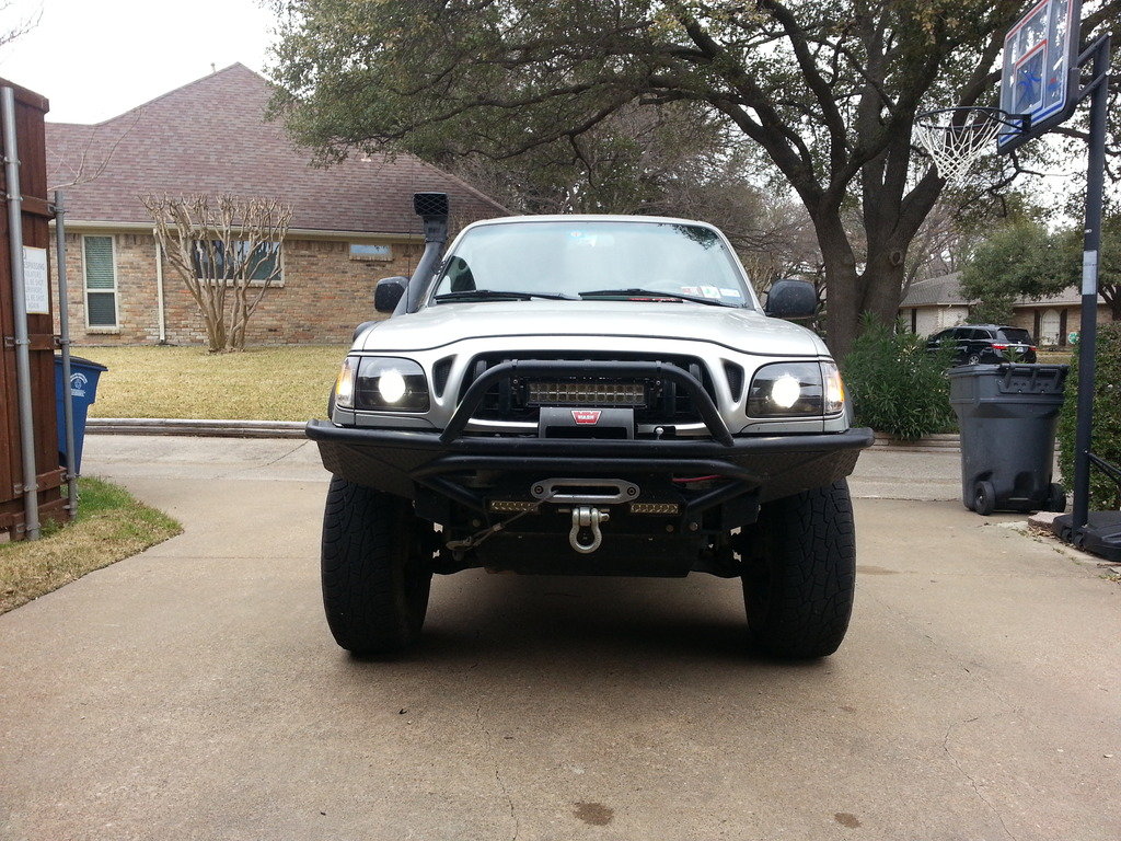

    I have the same winch and got the Trail Gear bumper because of this issue. You'd have to cut a lot of that bumper out. This is how I did mine. I kinda turned the Trail gear bumper into a hybrid

    From those pictures it may not be too bad. Our winch tray sits lower than that. You would not have to cut out over the clutch handle (although you would need to clock the clutch forward which is normal). You might even be able to only cut up to the front of the winch view port.

    Here's a more updated photo of mine. You can see how I had to cut around the handle. I hadn't done it yet in those photos I posted up there ^^

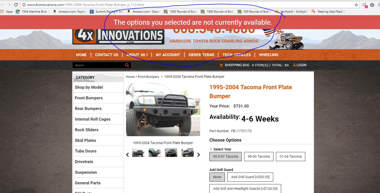

    unless you know something i dont, 4x no longer makes 1st gen bumpers

    I called a couple months back and was told they are no longer produced.

    The 95.5-97 and 01-04 bumper space is still being designed. It's not that we don't make them anymore, it's that we don't have that spacer yet. The 98-00 bumper is available now, and the others will be available soon....02 Tacoma.jpg

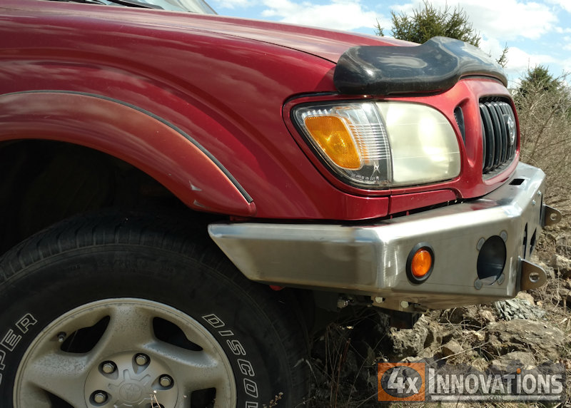

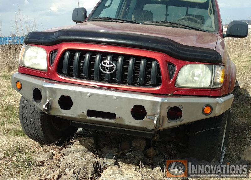

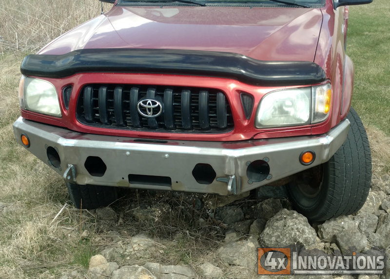

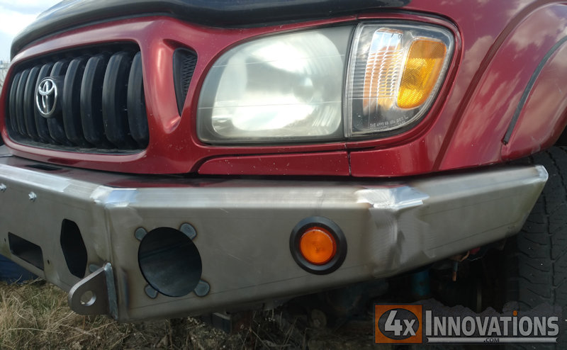

    Here's some pictures of the 01-04 model. The bumper is quite a bit different so it isn't just a spacer it is a whole new bumper fit specifically to the 01-04 Tacoma.
