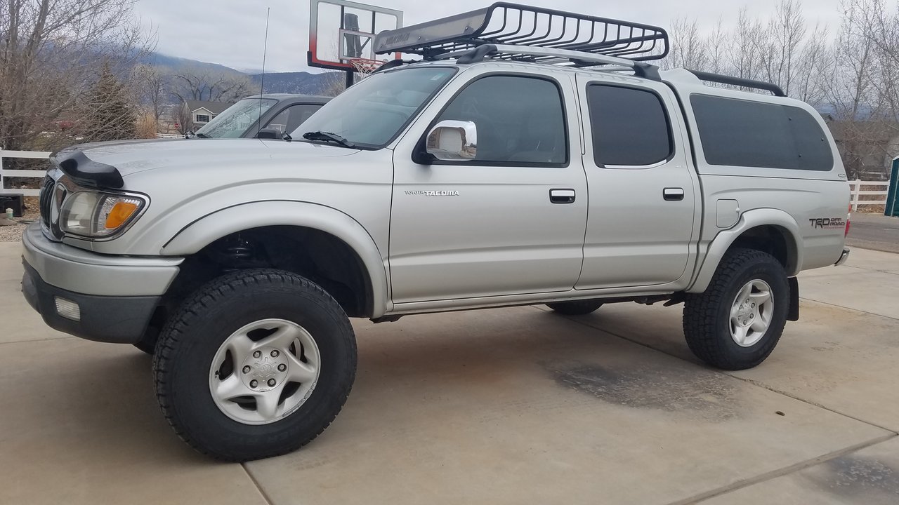

    For those of you guys with a flat roof tray or basket on your canopy with a 5 foot bed, what size are you running on there. I don't want the thing hanging crazy off the side. I have a Leer canopy.

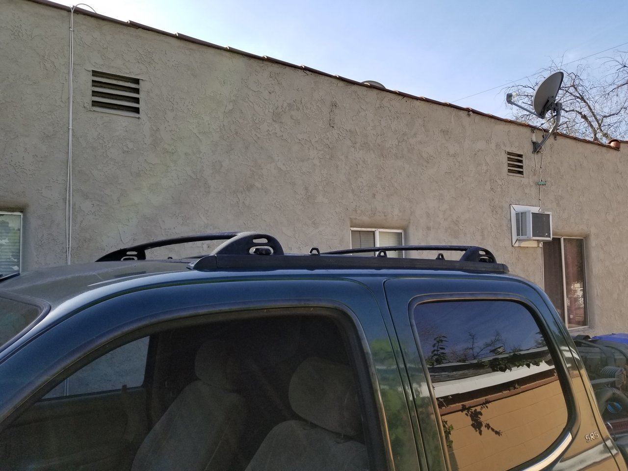

    I got some roof racks off of a 1997 4 runner from a salvage yard today. I painted them black and am installing tomorrow. I am pretty excited!

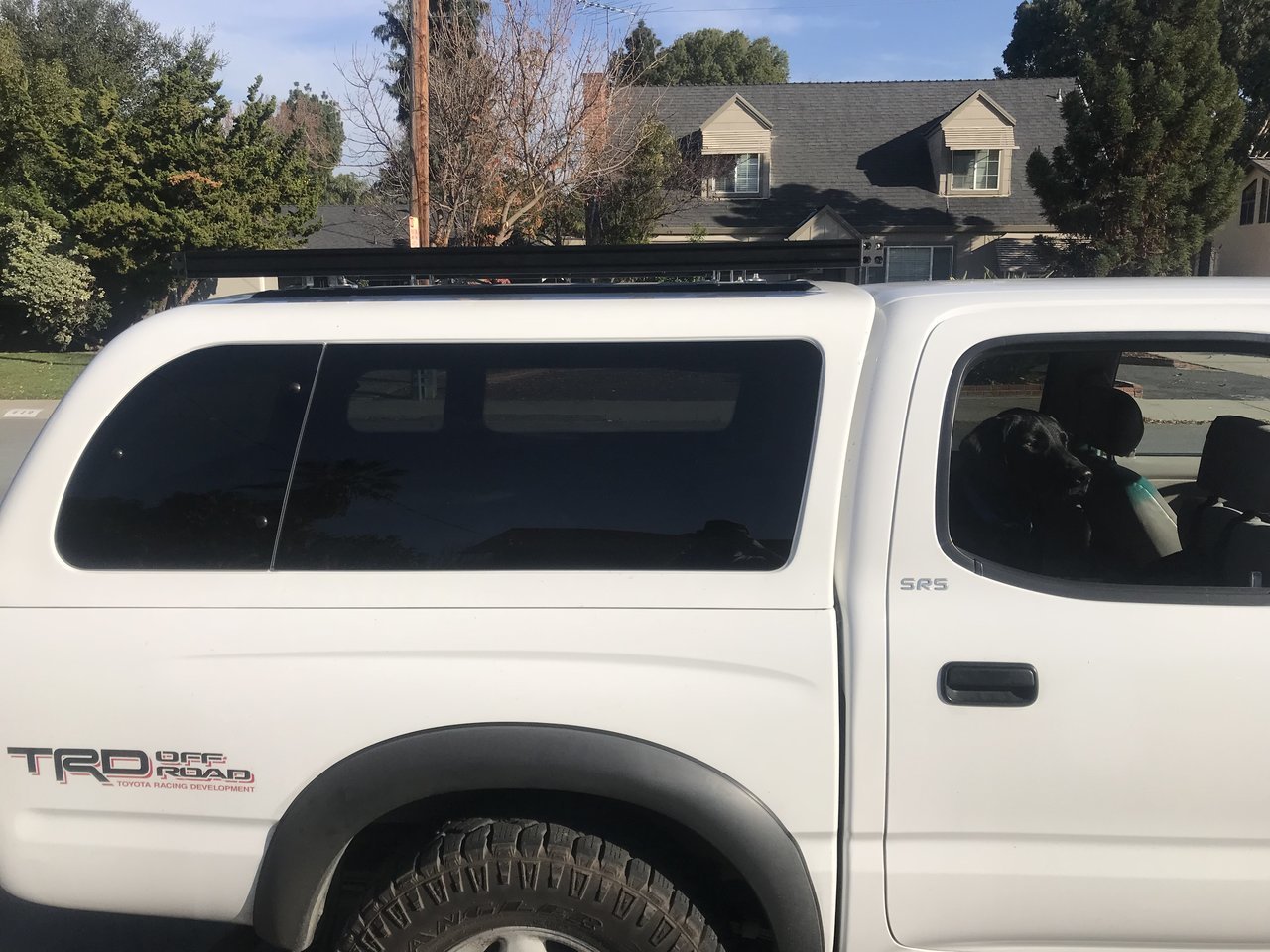

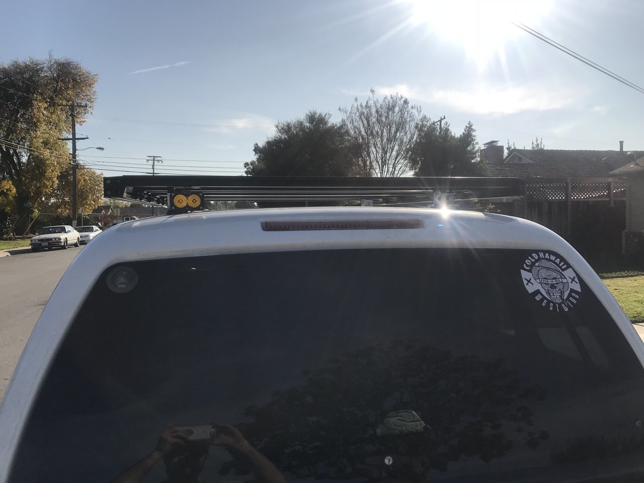

  6. Dec 13, 2017 at 2:36 PM
    #86
    Oldred92
    Oldred92 Well-Known Member
    Jun 21, 2017
    #222050
    93
    Austin
    Boston, MA
    2003 White SR5 Double Cab Tacoma TRD 4x4
    Front Suspension: 882 w/ Nitrocharger Sport Rear Suspension: Dakar HD w/ Nitrocharger Sport ARB Front Bumper w/ winch Extruded aluminum roof rack Tires: Discoverer ST Maxx LT255/85/R16 on Tacoma Steelies Additional Fuse Box and Upgraded Wiring

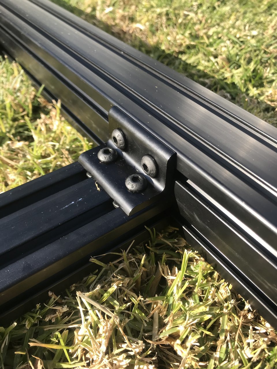

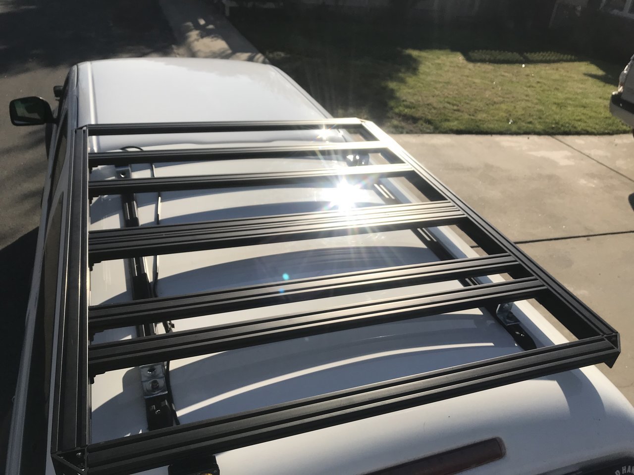

    I finish my DIY over shell extruded alluminum rack rack today.

  8. Dec 13, 2017 at 4:58 PM
    #88
    Oldred92
    Jun 21, 2017
    #222050
    93
    Austin
    Boston, MA
    The rack is secured to the Yakama T-Channels I already had on the shell. The channels are secured to the shell with through bolts.

  9. Dec 13, 2017 at 8:32 PM
    #89
    samTRD
    samTRD Well-Known Member
    Dec 10, 2016
    #204525
    58
    Sam
    Gainesville,GA
    2001 Black Tacoma TRD
    3" toytec lift procomp series 69 wheels leer truck cap All-pro Apex front bumper baja design squadron amber fogs extreme LED ditch lights
    this rack looks awesome, do you mind posting some pics of how you mounted it?

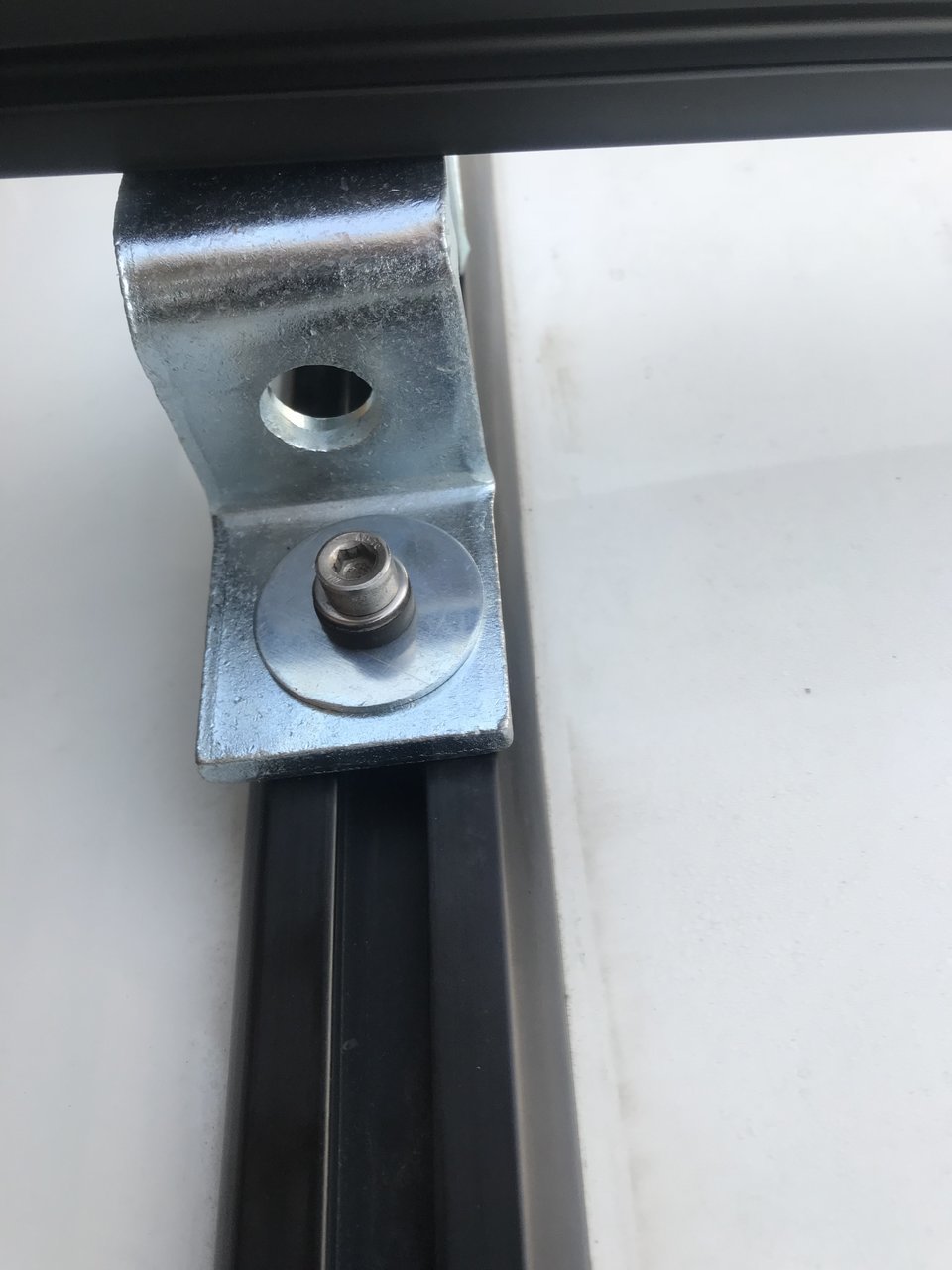

    Looks good. I did something similar and used the same screws. They all rusted pretty quickly. I guess stainless is in our future.

  11. Dec 14, 2017 at 8:34 AM
    #91
    Oldred92
    Jun 21, 2017
    #222050
    93
    Austin
    Boston, MA
    I thought I had ordered all stainless but I messed up. At least the really important areas, like the corners and mount points, are stainless. I was impatient could not wait for the other stainless fasteners to arrive so when it does, Ill either need remove it or try to swap out each fastener with it mounted

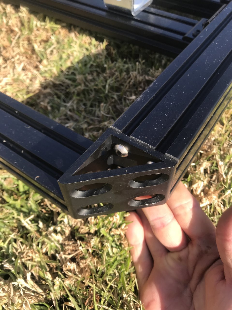

  12. Dec 14, 2017 at 8:45 AM
    #92
    Oldred92
    Jun 21, 2017
    #222050
    93
    Austin
    Boston, MA
    See attached. I used these U-brackets with big washers. I plan on painting them black.
    SilverGhost and samTRD[QUOTED] like this.
