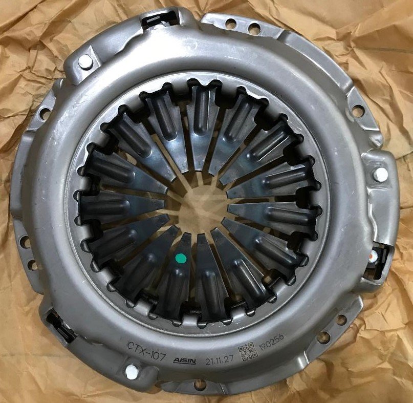

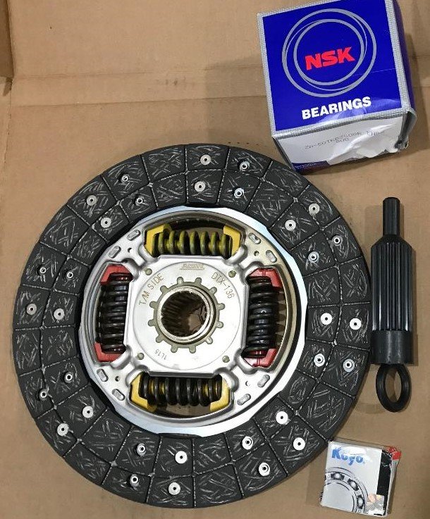

    Same here. My '97 V6 Taco 4x4 is a mud machine for hunting, not a rock crawler, so I decided to go with an AISIN CKT-040 kit marked JAPAN off Amazon with the colored clutch disc spring dampers. It's working great for me! But the Exedy disc (and the LUK) is of the same durable captured spring design as the original AISIN disc that was in my '97 Taco. If I was rock crawling, the Exedy cltch kit as recommended by "Showstop" over on TTORA would probably have been a better choice over the current AISIN kit. The Exedy disc looks to be a very strong design and it's inexpensive for the win-win. But bottom line, I think we have some VERY good clutch kit choices listed here in this thread. Just be absolutely sure to use a high-quality pilot bearing and throw-out bearing even if they don't come in the kit you buy. They are very good insurance on a durable clutch installation. IIRC, I used NSK JAPAN parts for both.
    The original OEM Toyota disc out of my '97 V6 Taco had fully captured damper springs. This type disc is no longer available from Toyota at least for my 3.4L V6 application. Exedy and LUK both use this original Toyota HD disc design.
    Actual aftermarket AISIN JAPAN CKT-040 kit purchased off Amazon is below.
    New, not remanufactured, AISIN JAPAN pressure plate was attached with the HD 8.8 bolt kit from Marlin: Heavy Duty Pressure Plate Bolt Kit | Marlin Crawler, Inc.

    The new AISIN JAPAN disc looks virtually identical to the remanufactured OEM disc from Toyota. Both have the same colored "plastic" spring dampers. The AISIN CKT-040 kit came with an NSK JAPAN T/O bearing which is same type as OEM Toyota. The KOYO pilot bearing was not marked JAPAN so I picked up an OEM Toyota pilot bearing marked NSK JAPAN for $7 to insure a durable clutch installation.
