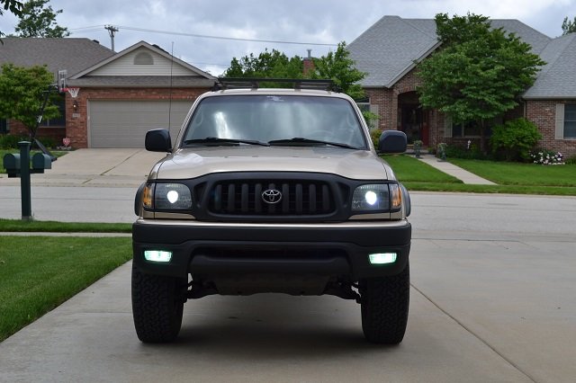

    can I use them as fog lights like this ? this is what im looking to do make the blinkers into fog lights when the headlights are on low beam

    Not true, Ive had HID's in my fogs for a year, no problems...
