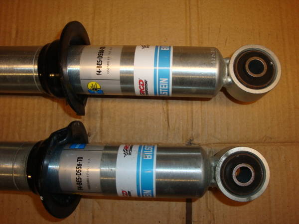

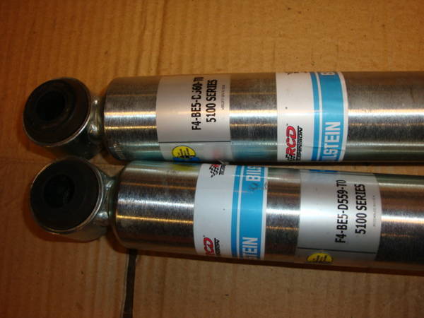

    People who don't have these yet have a terrible time finding out the part numbers, so here they are for FIRST GEN:
    BE5-D558-T0 = front preload adjustables (0"-2.5" Lift, same part both sides)
    BE5-D559-T0 = rear driver (length works with 0"-1.5" Lift)
    BE5-D560-T0 = rear passenger (length works with 0"-1.5" Lift)
    These are the silver RCD (Race Car Dynamics, Inc) version:
    Lengths for rears are according to DSM.
    The only purpose of this thread is to provide thses part numbers for these popular shocks.
    Edits:
    I attached the Bilstein 5100 brochure that explains how the front struts achieve leveling/lift and compares them to other types of lift and their limitations.
    Note on front shock settings: there are three for 1st gen. There is some dispute about the height on the middle setting.
    First setting
    = zero
    Second setting
    = 1" ("average" according to Down South Motor Sport site)
    or
    = 1.25" ("average" according to Dan at Wheeler's, specifically for a V6 Xcab)
    Third setting
    = 2.5"
    The condition/wear of your coils, your engine and cab type, and the amount of junk hanging off the front of your truck all affect the height, so no one will be able to give you an exact number.

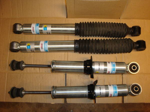

    Whats the Bilstein part no# for the 5100 series for 1st gen. TRD ??

    Alright that post was for all the Anal retentive mofo's, besides I was dared to ask haha :D
    Actually here is MY part # & how does it compare to yours ? ( I also have 5 settings not 3...

    2. I'm all like, WTF? Are those first gen 5100s? Does not compute...that number seems to come up for Tundras...er? That can't be the Race Car Dynamics shocks for the 1st gen Tacoma. :confused: Now I will have to counter with pix when I get home...

    Those are for a 1st gen Tundra.

    & correctamundo you guys are, ok here's the skinny, last year when I got these from a local Bilstein Distrib. here in San Diego I was told by the owner at that time "there is no application specific to 1st gen. Tacoma TRD's". & what some were using was indeed the ride height adjustable 5100 series for the earlier Tundras. & me not really knowing what app is for what, I just told the guy as long as they fit right & will perform without any adverse reactions & accomplish what I want I said "OK hook me up". So he did & I fucking love'm , a heavier duty 5 setting adjustable Billy is fine in my book.
    Offroad is just awesome, the bumps & ruts that had me preparing for a bone jarring, suspension bottoming experience I had with stock susp. never happened with these. They say these give the Tundra a 2.5" front lift should equate to about 2.75" if I choose to go up another 1 or 2 settings (I'm on the 3rd groove up w/2 to go) So what coils should I match with these bad boys ?
    As far as I've found from talking to other members mine is 1 of a kind (so far) & I enjoy being the freak I guess......:D:D
    This is exactly the same shocks I have as the one pictured, even came with all the new hardware i.e; top grommets w/washers etc;
